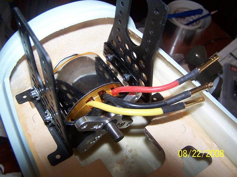

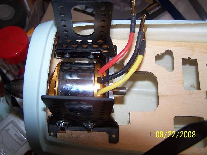

All this talk of glow and gas motors....well....how bout this?!?!
The portion of the mount sticking below the cowl line will be cut off of course.

Kahlog,
Which Turnigy is that? and how many cell are you going to run on it? BTW I'm putting a Saito FG-36 gasser in mine (haven't started it yet, and wont get to it till start of Oct![&o]) Still waiting to chase up retracts too.

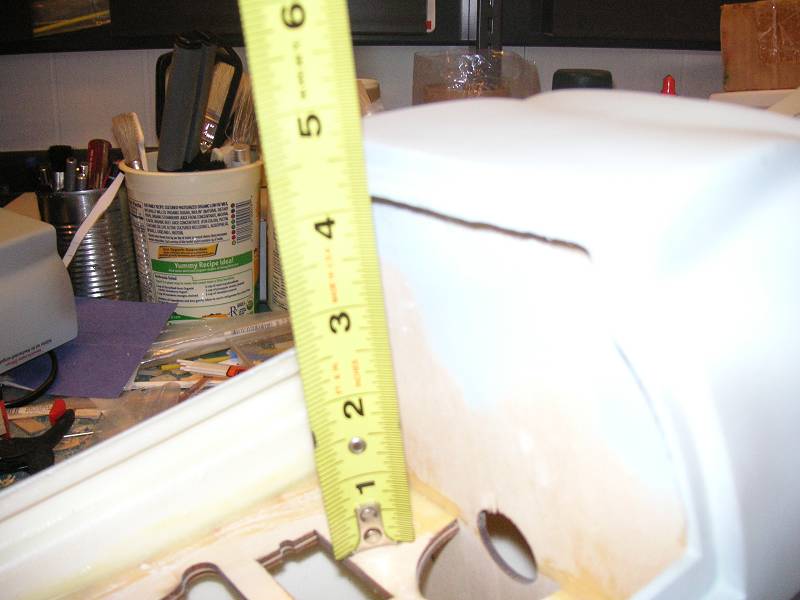

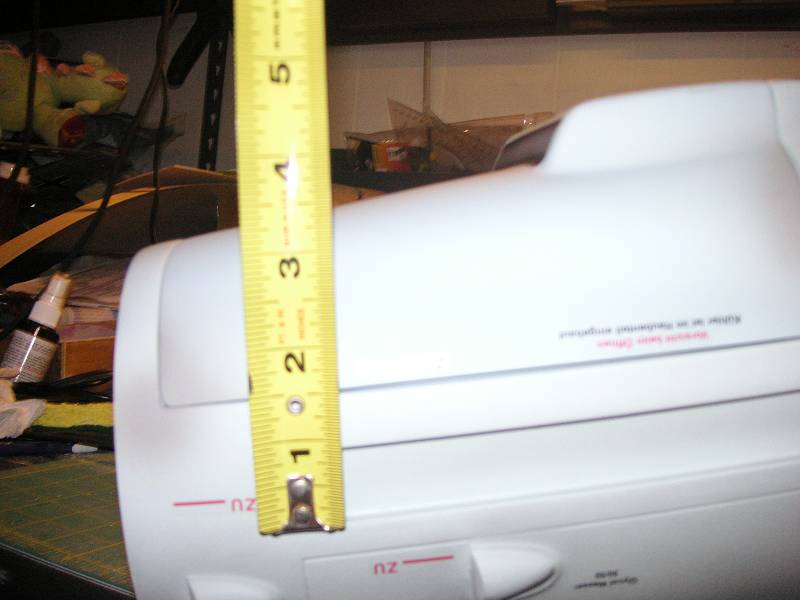

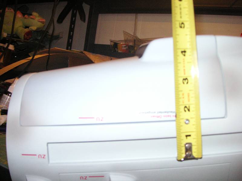

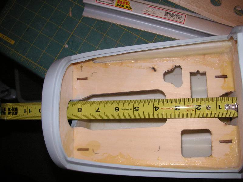

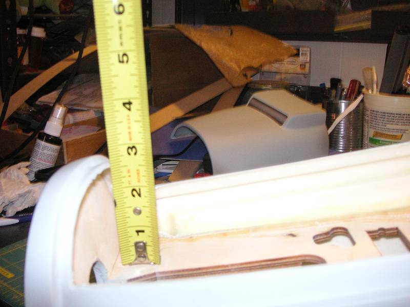

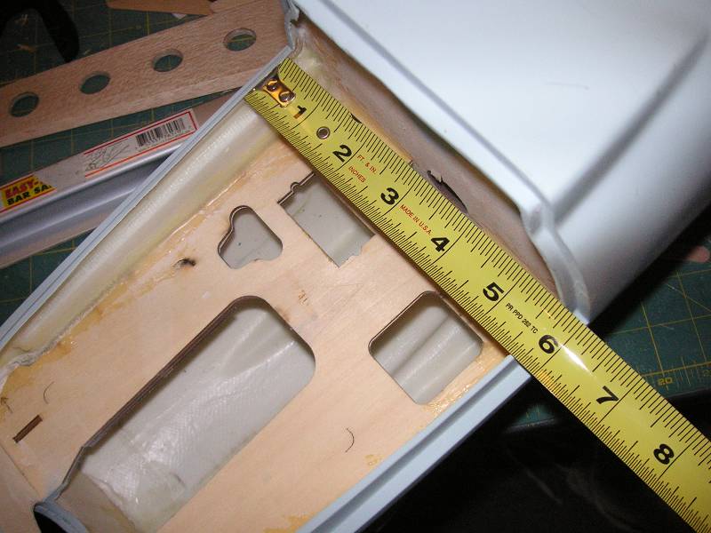

Hope these pics help with your measurements. For the outside side shots, the top of the groove the for exhaust stacks is also where the bottom of the engine mount is.
ORIGINAL: Sturtz
Would one of you guys with the ARF in hand take an accurate measurement of the cowl ? Needing to know what can or cannot be stuffed in there without chopping too much.
Thanks in advance !!

turnigy 6364 -230kv on 10s 4800(2 x 5s 4800's in series). Due to ground clearance concerns, I may only be able to get a 16-18 inch prop on the plane so I'll have to use a very high pitch in order to load the motor enough.
This motor can spin a 22x11 prop on 10s-12s, so Ill first try something like an 18x12 if it'll leave clearance, if not, I have some 16x14's.

after looking at the measurements provided in the pics above, there is 209mm length inside the cowl area and 139mm width, so any of the three motors should fit fine...aka:
saito 180
saito 200TI
saito 220
