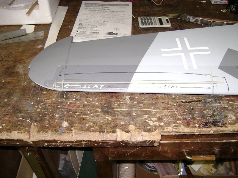

This is the first of a few pics. I have to load one at a time to avoid being timed out.
The leading edge covered with clear packing tape to act as a protective coating as I put epoxy on the leading edge to create the exact same leading edge shape and that will become the mold for the glass slat. The wing is not waxed or seal with anything else, just tape, and it works
Steve

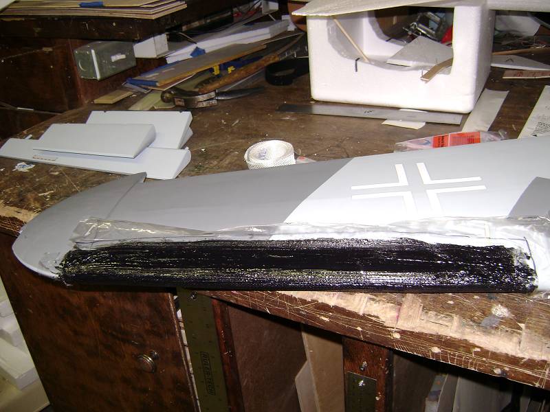

This is the pic of the epoxy resin mixed with cabosil and black tint over glass tape that is normally use for seaming.
Note in the previous pic the grey tape is the slat size taken from a card stock pattern used on both sides. same pattern used on both sides.
This is the basic concept of copying shapes exactly. you can see how this can be used to get extra parts if you "think".
steve

This pic shows what you get. A mold to lay up a glass slat. The layup is a variable of glass. Note to mold off compound surfaces, a mold release wax and a safety layer of PVA is what we use as insurance of safe release of mold. Tape will work of straight surfaces only
Next is the more complex linkage of this slat deployment.
Steve

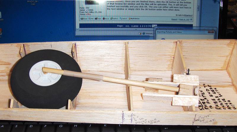

photos of bf109f gear mockup
First photo is of the spring air retract mocked up from balsa.
Second photo is of gear in the retracted position with a 4" hard foam wheel. The scale bay just takes the 4" wheel, scale @5.4/1 is 4,75".
The third is of the gear in the extended position.
Continued on next message.

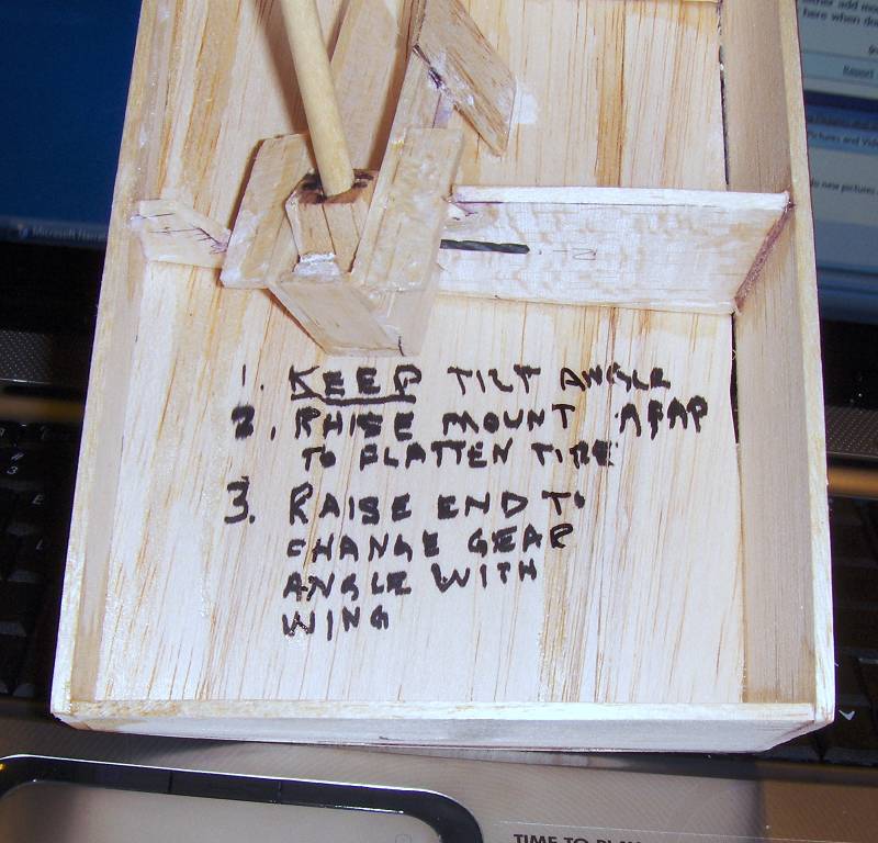

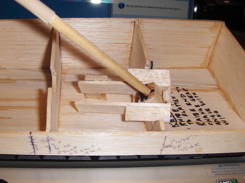

Default RE: CMP BF109F BUILDING THREAD
2nd set of retract pics. My thanks to kahlog for the instructions on how to add a pic.
Forth pic is the gear partly retracted ,the dark object is a drfill that I used as a pivot. You can see that the pivot is in the center of the first rib.
Fifth pic are some note on things to do with the real gear.
Sixth pic is another one in the retracted position.
There are sevelal things that control how the gear fits;
1. The pitch angle of the pivot controls 2 parameters. The position of the gear in relation to the leading edge of the wing, and in conjunction with roll axis of the gear strut, how the gear fits in the well
2, The angle that the roll axis of the pivot makes relative to the pitch angle controls where the gear end up when extended.
3. The position of the gear mechanism wants to be is close to the lower skin as possible, while maintaining the pitch angle of the pivot.
All in all it took 10 hours to make the mockup, but it was worth it when you figure the price of a new wing

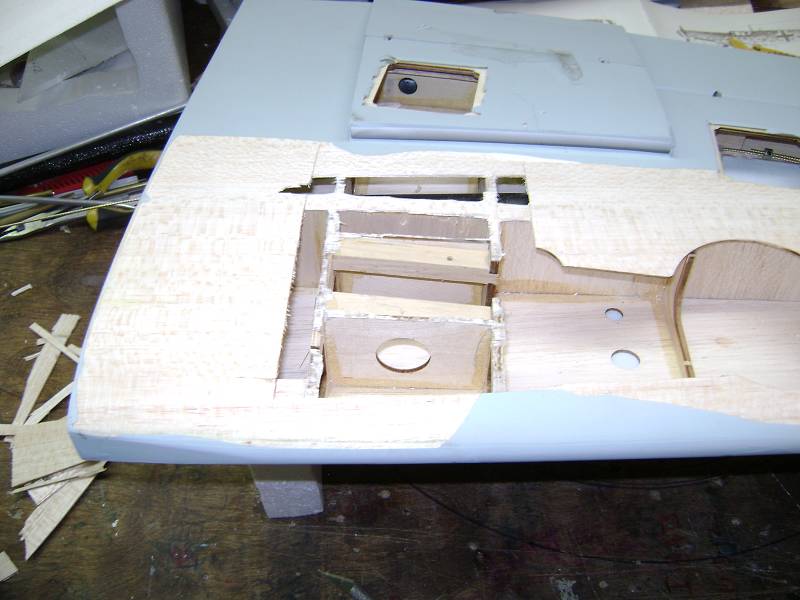

Hi All
Since I'm going to put the retracts in a more scale position, I'll post a pic of the internal construction. Its not as bad as I thought, some pretty good reinforcement.
What I am going to do is put the gear with the correct forward rake and move the gear forward towards to LE . This not only gives the model better ground handling and less potential to nose over, it also retracts and sweeps back as in scale.
The forward rake has worked well on all my 109 over the years and gives you a chance to avoid nose overs.
Steve

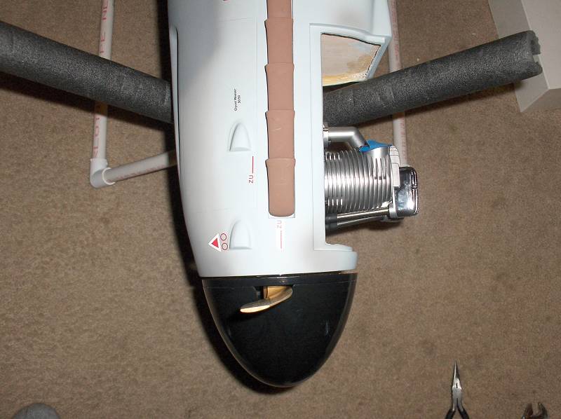

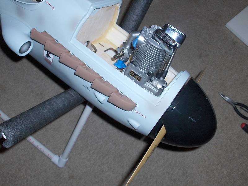

Here are some pics of the engine installation. What a pain...[:@] I think the vibration mounts are used for the YS engines, not saito. It's not perfect but I think this is as close as I'll get.
