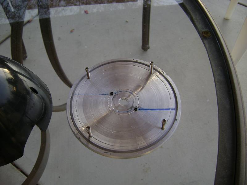

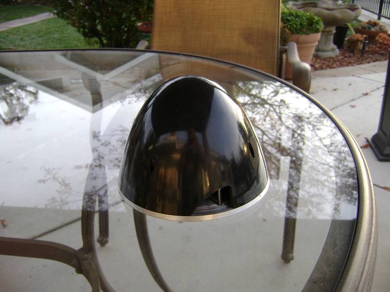

Favor please , my BF109 is packed back up until I finish the Fw190 , can some one please tell me the size of the spinner back plate ? I have some of the guys at work that want to take a crack at making one .
Lou

Default RE: CMP BF109F BUILDING THREAD
Hi Lou
My alum backplate is 5.695" (144.73mm) at the point were it meets the fuse and tapers to fit the spinner without step up or down. As in the factory one, just alum. Its around 4mm thick.
Your really better off unpacking the spinner and giving it to them. I had to test fit my cut a 100 times. But im not a machinist at all.

Scalecraft, you should sell those back plates... I know I'd pick up one... this piece of plastic they ship is total bunk.

Scalecraft, I'd take one off your hands too !

Thanks Steve , I guess your correct I am better off taking my spinner into them and let them knock it off .

LDM, it will make for a better fit and less time invested.
Steve

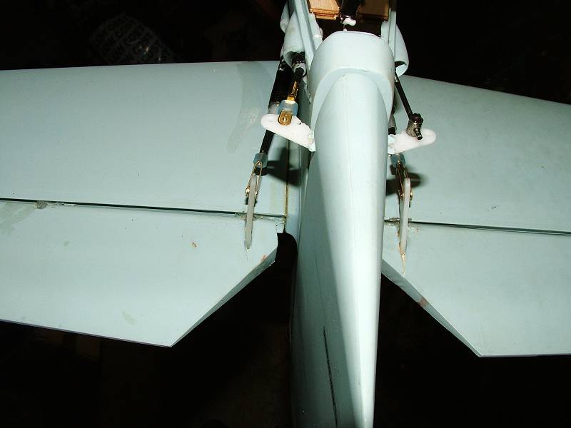

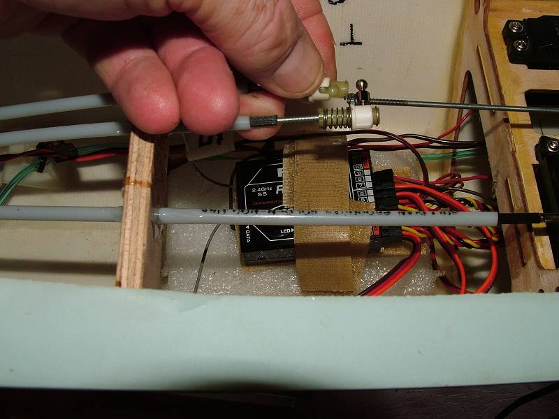

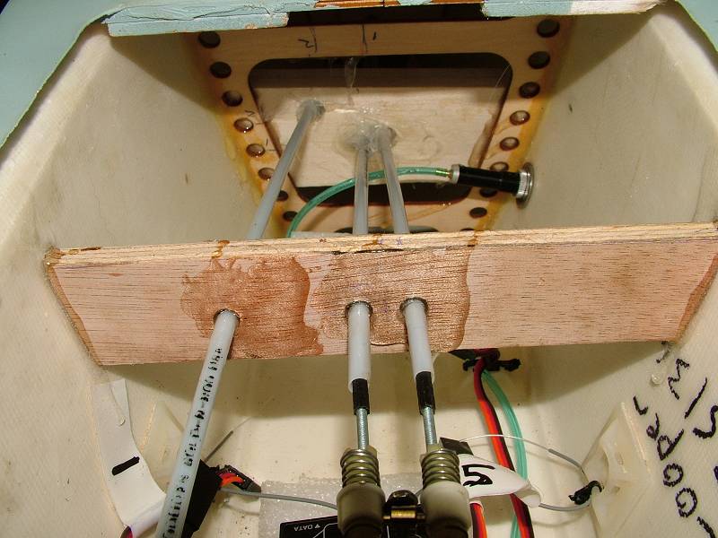

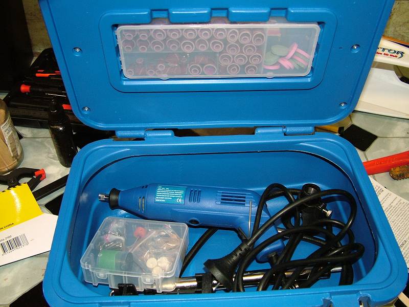

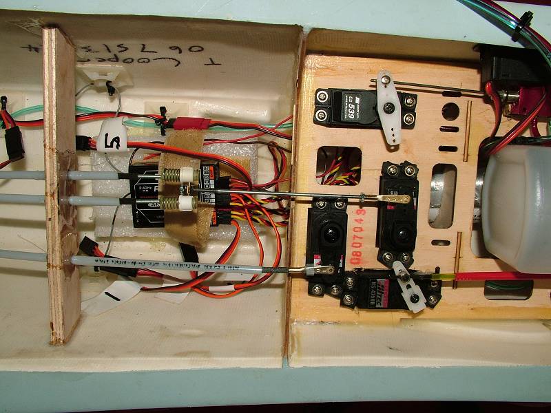

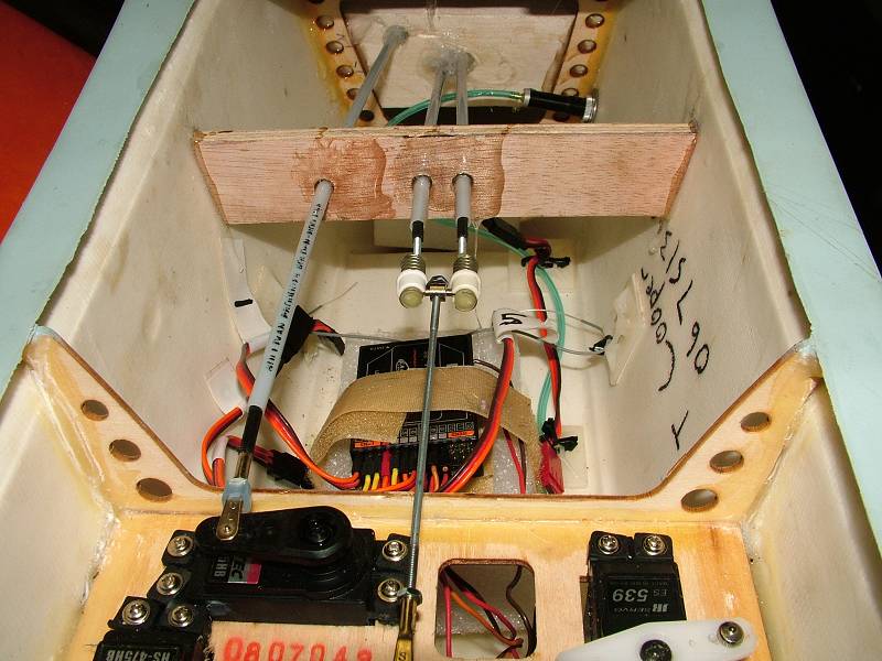

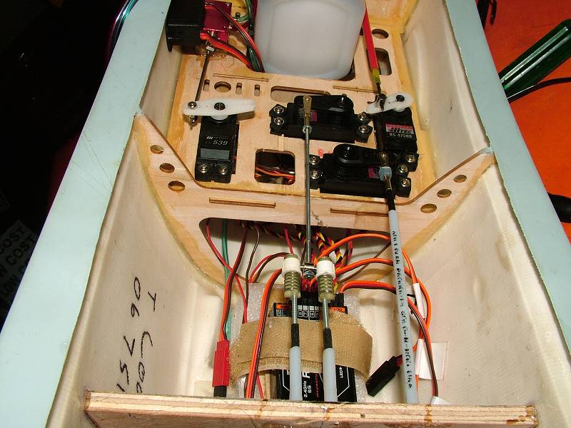

Well here is my solution to the crap setup for my plane, my order from Tower turned up today so I spent the day modifying it, I am very happy with the result and both sides stay even.. the box you see is a "dremel" style tool which was a really good buy thought others might like to look into one!, the ball link item at the start means you can pop off either side for adjustment but its very secure, the rods I used were the sulivan rods but the carbon fibre ones which they say dont move that much

can you elaborate on the internal duehickey that takes the two rods to one , cant quite make that out in the pics ?? Is that a after market purchase or a "snappa industrys special"
NOt to beat a dead horse [&:], I notice you are useing an easy link on the end connection at the rudder , once you get that set to your liking I would 100% use J-b weld and make that permanant and make all your adjustments from the inside and or radio

LDM,
I believe they are 'Elevator Splitter 2-56 Ball type '
http://www.hobbycity.com/hobbycity/s...-56_Ball_type_
And I believe his 'easy connect' only attaches to the tail wheel (correct me if i'm wrong SNAPPA). Nice setup, I think I'll be doing the same.
yes Tower also supplys them, http://www3.towerhobbies.com/cgi-bin/wti0001p?&I=LXFV37 its actually worked out well, just make sure you keep the rods "mirrored" in their travel, you want the same length and geometery each side I will pop off the balls in about half an hour and upload another pic so you can see how they really fit

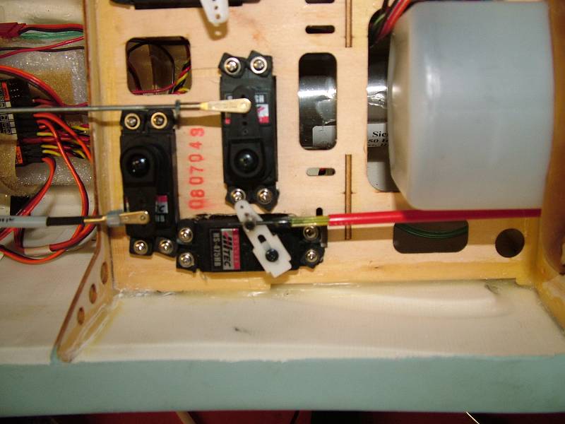

actually no I have if you look at the photo a easy link on the throttle servo and the retract gear, I just ordered some dies and taps from tower which arrived with the ball link thing... I intend to remove them, cut the rods to the correct length and tap a thread on them then screw on a clevis and make it safe, the easy link idea has never sat well with me, JB weld or not, I also have to get my fancy new grinder and tidy up the epoxy
here is the ball removed, as you can see its quite secure, also you can see my throttle servo with the sullivan rod, I may remove this too and replace it with a steel one, not sure about that just the consequences of the yellow rod breaking well........... you can also see through the rear that I have used short lengths of the existing rod to force the rods into the geometery I want when it exits the rear, I also have two balsa firewalls going through the rear to support the rods, I am still not sure if I should have used the next size up rods but when you think about it the elevator rods are only moving one surface each

thanks , got it now !!! nice set up
