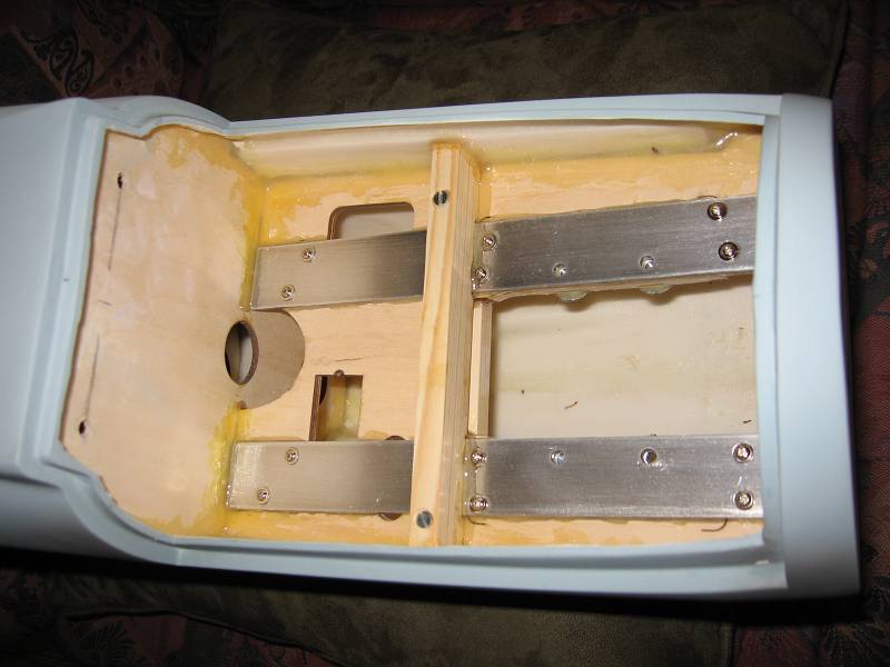

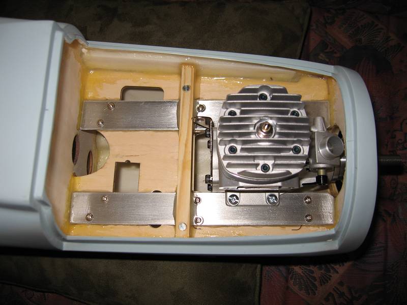

Your hardware looks good, however I would remount the engine on an aluminum platform to spread the load of the engine over a larger area. The ply is a bit soft. ( I mentioned that before and someone said they sealed the ply with epoxy. Still soft, just feul proof for the few extra minutes.)
Back in these posts are a bunch of good picks of various engine mounts that would address this concern.

Steve,
I have impregnated the ply with thin CA. I also installed 4 washers under the provided mount to spread the load a little more. We'll see if this is enough. This way I could use the provided soft mount. I'll check every few flights. That is offcourse if mine survives the maiden.

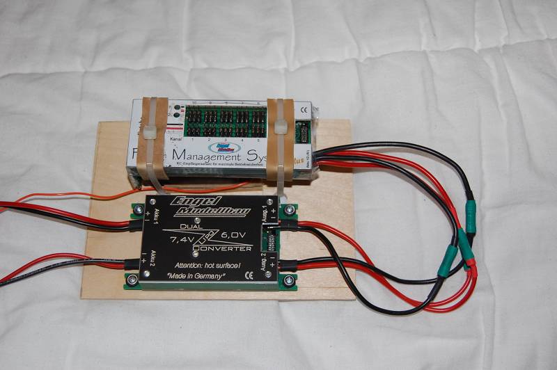

#1059

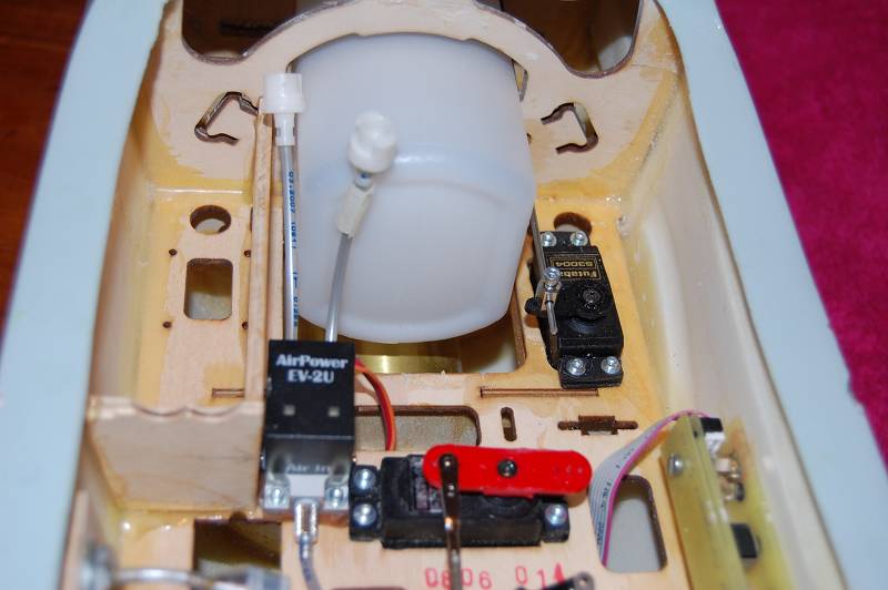

ORIGINAL: Schummie
I agree with scalecraft. I like to take the ARF as a start. Then I try to make it as good as my experience and my budget let me.
I took the trottle servo out of the engine room. See the pictures which also include some of the fuel plumbing.
Regards,
Eric Schumacher, Netherlands.
Regards,
The rest looks real nice Mate.
Cheers,
Brad

2)CMP engine mounts are not advised. Use some aluminum plates to mount your engine to the ply. Pics here somewhere. spread the load. Seal engine area.

4)Mount throttle servo behind the firewall. It doesn't need the heat or fuel exposure.

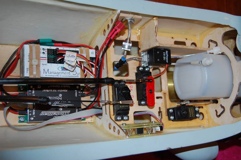

Here's the setup of my 109. Very bad weather in Europe, so the maiden will have to wait a few weeks. My engine is brand new, so i'll run it in on my lawn in the plane. That way I can see if the CPM engine mount and the spinner will hold out.
Engine: OS 120 AX
Prop: Master Airscrew Classic 16x8
Aileron Servos: 2 x Futaba S3152 Digital Hi-Torque
Flap Servos: 2 x Futaba S3010 Hi Torque
Air-break Servo’s 2 x Futaba S3004
Throttle servo: 1 x Futaba S3001
Rudder Servo: 1 x Hitec HS645MG
Retract valve: Air-Power EV-2U Dual action retract valve (no servo needed)
Retracts: Sierra CMP Me-190 retracts
Wheels: Supplied wheels, supplied wheel bays used.
Receiver: Futaba R-149-DP
Power Management System: Engel. Seperate 6v power supply to both servo’s and receiver.
Battery: 2 x Zippy Lipo 2200 Ah each.
Coverter 7.2v to 6v: Engel Dual Power Converter.
Weight: 6070 gram (13.4 pounds Flight ready without fuel)
Used the supplied spinner with better screws. Have a Fliteskin aluminium one if the plane survives the maiden and test runs.
Used Hobbycity tail wheel which is much stronger and more scale.
Replaced push rods for carbon ones.
Used supplied hinges.
Placed throttle servo near the other servo’s to protect from heat and oil.
Used recommended throws with 30% exponentional on the rudder, elevator and rudder.
CG set at 112 mm with Great Planes CG machine.
Regards,

Had to make some adjustments, for my CG was way off to the back of the plane.
Both my lipo’s had to be placed as far forward as possible. I glued in a battery bay, as can be seen in the picture. To make room, the electronic retract valve had to be replaced to the center.Also the convertor and the receiver with power box is placed as far forward as possible. I chose the left side for the lipo’s to keep it also left/right balanced.
The CG now is 116 mm, exact in between 112 and 120. This is the range suggested by CMP.
Please, especially the guys hwo have already maidened their plane. What CG did you use, and did you keep it there after your flights. To get the CG more forward, I would have to place lead in the nose.
I rather want to prevent that, as the plane already is 13,4 pound.
Thanks in adcanced for sharing your CG settings with me.
Regards,

I want to hard mount the engine in my 109.
The ply plate is a bit flexible for the big OS 1.60 I think, so I have stiffened the whole arrangement two ways. The aluminium rails are 2mm thick.
There is a weight penalty, not that much considering the total weight of the plane, hopefully not a problem.
Helge.
Helge.
#1073
Hi,
I am wondering about this method of strengthening the ply engine mount.
If you simply attach the steel plate on top ( below?) the ply doesn't it alter the engine thrust line by the thickness of the plate ?
This would put the spinner out of line .
I know it is only by a small amount but is there a simple way around this problem?
Cheers,
MM
Cheers,
MM
#1074
Joined: Sep 2003
Posts: 80
From: Bergen, NORWAY
The flexible motor mount supplied in the kit would hold the lugs on my engine approx 2.5mm clear of the ply plate.
The aluminium rails are only 2mm thick. However when I dry fitted the arrangement the spinner was a nice fit to the front of thefuselage.
The way I see it the main strengthening lies in the member glued across the engine room, making a stiffer connection between the engine support and the fuse.
I am not mechanically skilled, and perhaps hard mounting is not that wise. But I believe that even a flexible mount needs to have a solid support to be able to work properly.
Helge.
Helge.
