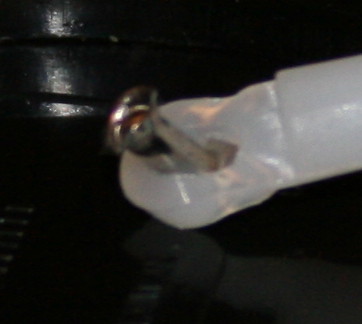

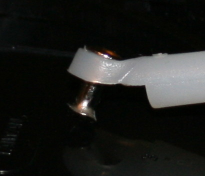

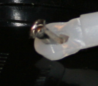

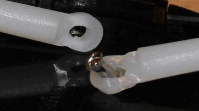

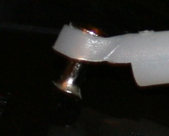

Well, if I can take a moment from this to discuss the Me 109 from CMPro, I know some of you have herd of it (sorry, I have 25, 22, 18 and 3 year old in my house with wife and I, and I don’t get to say things like that without paying for it for weeks). Anyway back to the plane.
The hinges looked like Delrin in its neutral state (uncolored). Delrin stretches easily when put in tensile loading, it deforms easily in compression. If these hinges are Delrin it will not take long for standard flight loads to elongate the hinge pin hole until it can pull through. So I devised a test to see if these hinges have any of the bad traits of Delrin, I tried to pull them apart holding each end in a pair of pliers without using leverage to amplify my strength. As I feared it took little effort to pull the hinge apart. Judge for your self in the pic’s below
Joe

Hi All
With all due respect. (4 kids, but just for the sake of info)
The hinge for me is always a concern. However I think in the CMP 109 case, it is not probable.
With time maybe, but I am satisfied with the stress test. Went past 20lbs without failure. Imagine 2 or 3 on a surface.
Anchoring the hinge may be a bigger concern for some modelers.
Steve

Default RE: CMP BF109F BUILDING THREAD
great setup steve, i calibrated my arms on a couple of the hinges in my work shop (klett pinned, a living hinge from an old kouger kit, and a CA hinge ) i could not make them fail. As soon as i can get a robart 3/16 hinge point i'll do my test on it.
Joe

ORIGINAL: paladin
Joe
From the pics you posted the hinge point has been twisted 90 degrees to the hinge angle. You can see the deformity quite clearly. ANY hinge will break if you do that. The flight loads are going to be along the axis that SCALECRAFT tested.
As for the little hinges on the flaps/speedbrakes.. They scare me.
The hinge point type hinge is not balanced. meaning it does not have support from the same side of the hinge (i hope that is understandable). the natural failure would be for the pin to turn in line with the stress then pull through one of the holes, that’s what mine did.
My concern is not the hinge breaking, but rather this type of plastic is how they will stay glued in. it has a habit of stretching, bending, when ever stressed and that would break it free of the glue holding it, in short order. I have on occasion found a hinge point that has broken loose of the glue holding it (when things are miss aligned slightly). I’m afraid a perfectly aligned set of hinges will break them selves free just from flight loading
Joe
