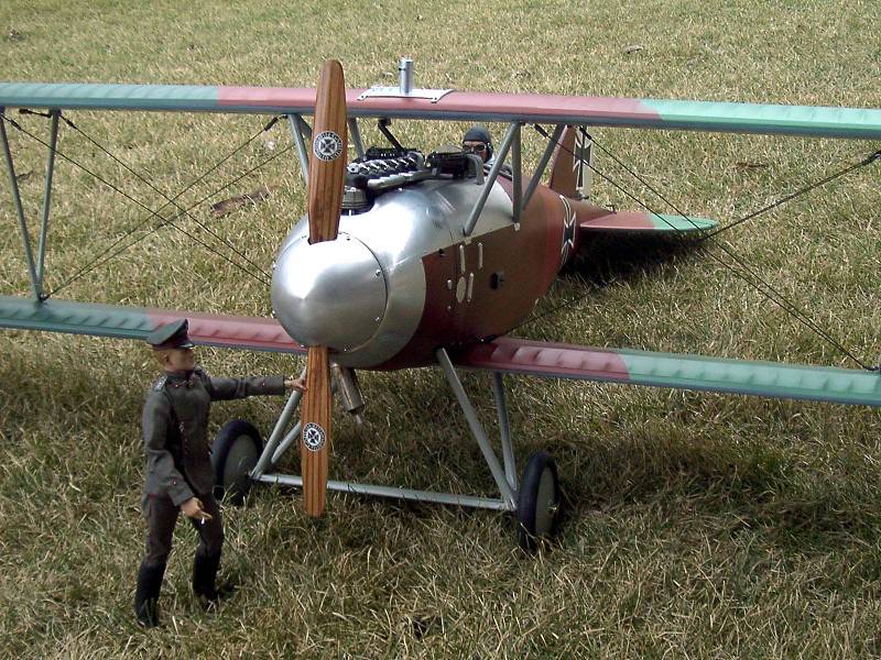

You may loose a little exceleration, but the heavy flywheel affect provided by a spinner can help a 4-stroke run better and idle lower from my experience. The biggest problem is you need to get it running very well since it is difficult to get an electric starter to work on that big round spinner profile. I have a large spinner on my Albatros and never had any problems hand starting my YS 1.10, but a Saito 1.80 may be a different animal. Here's a photo of my other "hand start model" (by me, not the Baron).

What kit is that Albatros? It looks great. Ive been looking at trying to find a decent kit, but want a 1/4 scale. Arizona model products has several, but ive not heard the best on these forums regarding them.

The Albatros DIII is a 65" laser cut kit made by Funaero. Do a search on the web, you'll find them. There is also a rather long build thread about them on RCU. It is only 1/6 scale though. Wait a while and you may see one from Balsa USA.

Thanx Hot Rod. 65" is too small for what I want, but yours looks really great. I think proctor has one, but the prices are even worse then Arizona.

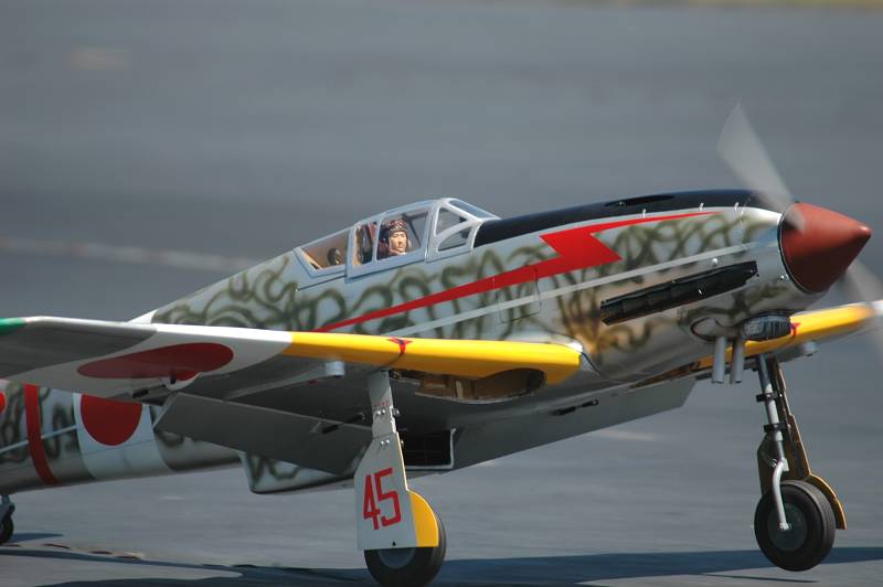

The spoiler could also go up, not just follow the flap (I have a BF109 engineering manual). Most static photos show it down with the plane on the ground. In any case, I believe the plane could use some more drag on landing. Split flaps provide much more drag than standard, so at the very least I would lock the top surface making it act like a split flap. I don't care if it looks scale in the air, who will be able to see it? I have mine going up, but used the shortest part of the servo horn so there is more down movement than up. I also set my radio so the flaps deploy before the "brakes." I'm curious to see how they work to slow the plane down. I'm hoping it lands like my planes with full split flaps. In the photo you can see the split flaps deployed on my Ki-61.

Old 02-05-2009 | 09:43 AM
  #1014
mike early's Avatar
Joined: Oct 2007
Posts: 2,106
From: Ashland, KY
Default RE: CMP BF109F BUILDING THREAD
Is a damned nice looking airplane.
What spinner is that, btw?
Very nice image, I just noticed the wheel leaving the ground...

ORIGINAL: Evil_Merlin
Do you think he was using the flaps on take off? Maybe, but the tail wheel is still firm....
I imagine it was during a bouncy landing!

Well considering the tail is already on the ground, you are probably right...
But sometimes I do use flaps on take off...

The spinner is a Gene Barton.
The photo is during a landing. I never use flaps on take off with that plane. The runway is a bit rough causing the wheel to bounce up, it is actually landscape fabric even though it looks like pavement.

Fantastic picture... I wish I had some of my better landings...
