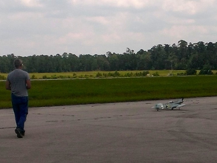

<span style="background-color: rgba(255, 255, 255, 0);">As the BF109F taxied onto the runway (taxi way actually) for its 1st flight I seem relaxed but we all know this is far from the case. She throttled up and tracked true with very little rudder input. The tail raised and in just a few more feet she became light on the main wheels. With just a bit of up elevator she broke ground and was airborne. With just 15 degrees of flaps she climbed out nicely. A gentle bank to the right till she was flying downwind and level then climb out to altitude. When I raised the flaps I was surprised to find she needed absolutely no trimming. </span><div><span style="background-color: rgba(255, 255, 255, 0);">
</span></div><div><span style="background-color: rgba(255, 255, 255, 0);">She is a heavy bird though. At 17# she flew solid but with high wing loading the landing would mean she would have to come in hotter than I like. So after flying around a bit to get use to her and of course to settle my nerves I began to set up for the landing. I lowered the flaps to the takeoff setting and found she now wanted to turn to the left a bit. I aborted the 1st approach and set up for another try. On the second try she was coming in to hot so with a go around I set up for the 3rd attempt. On this one when I had the runway clearly lined up I dropped the flaps to the landing setting and found she wanted to turn to the left even more. So with aileron rudder and throttle jockeying she touched down. Bounced then touched down the second time and was safely on the ground. The roll out was less than perfect and I ended up letting her taxi off the runway into the grass.</span></div><div><span style="background-color: rgba(255, 255, 255, 0);">
</span></div><div><span style="background-color: rgba(255, 255, 255, 0);">All in all a good 1st flight. </span></div><div><span style="background-color: rgba(255, 255, 255, 0);">
</span></div><div><span style="background-color: rgba(255, 255, 255, 0);">When I checked her out I found that for some reason the inboard left flap stopped working staying in the up position. So with more lift being generated by the right flaps explained why she wanted to turn left with flaps extended. This only made the landing a bit more difficult but manageable.</span></div><div><span style="background-color: rgba(255, 255, 255, 0);">
</span></div><div><span style="background-color: rgba(255, 255, 255, 0);">The CG ended up for me at 112mm and she taxied well on grass and of course concrete. No nose overproblems at all.</span></div><div><span style="background-color: rgba(255, 255, 255, 0);">
Larry Hebert</span></div>
