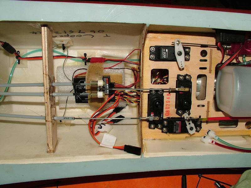

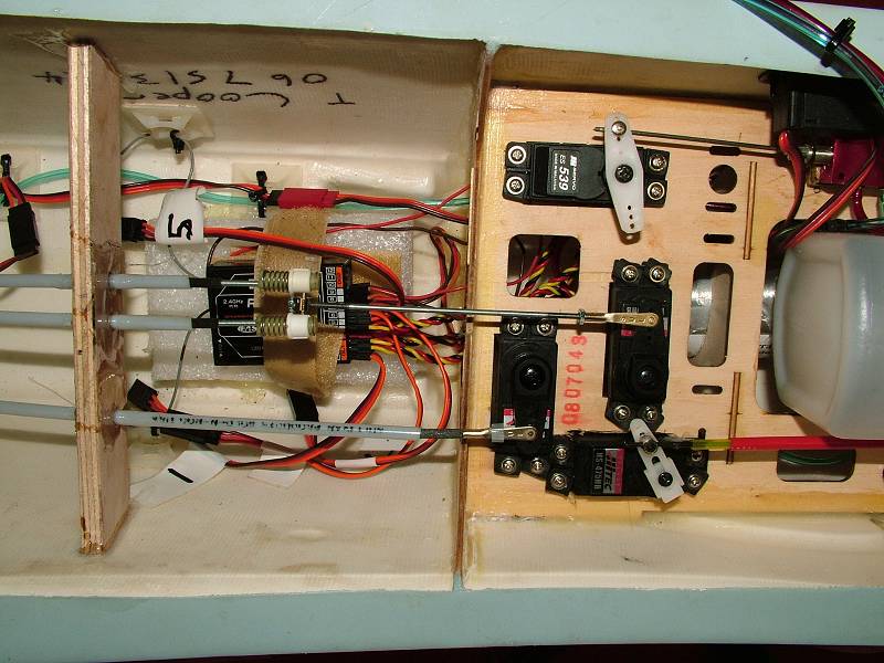

Well with some testing on the lawn here is a change I had to make, simple if you look at the rudder servo there is not enough support near the servo end final product here vid http://s443.photobucket.com/albums/qq153/lipokilla/ Two photos show the internals of the carbon fibre rod, where is exits the body you have too keep this quite short, the link above is split for some reason just copy the whole thing into a browser I guess you can see the after and before photos here

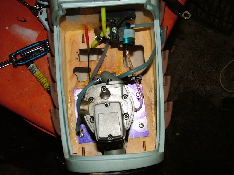

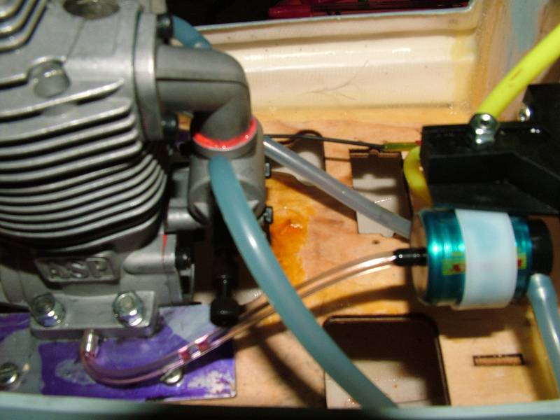

Well fitting the pump was an interesting exercise..... motor wouldnt start but would turn over a couple of times then stop, then it started..... backwards and throttle stop wouldnt stop it... see in the photo above somewhere I routed the fuel tube discretly through the body... now that was a good idea as I was able to stop it.... and then blow the fire out inside the canopy.... yes you heard correct it caught fire. no damage apart from a little blistered paint what would cause that? never heard of a 4 stroke running backwards? too rich on the idle?

Snappa, good luck with that pump. I put one on an OS-1.60 and it was always too rich on the bottom end. Once I took the pump off the engine ran perfectly. I had it on a 3D plane where I thought the pump was needed, on a warbird it is not an issue.
