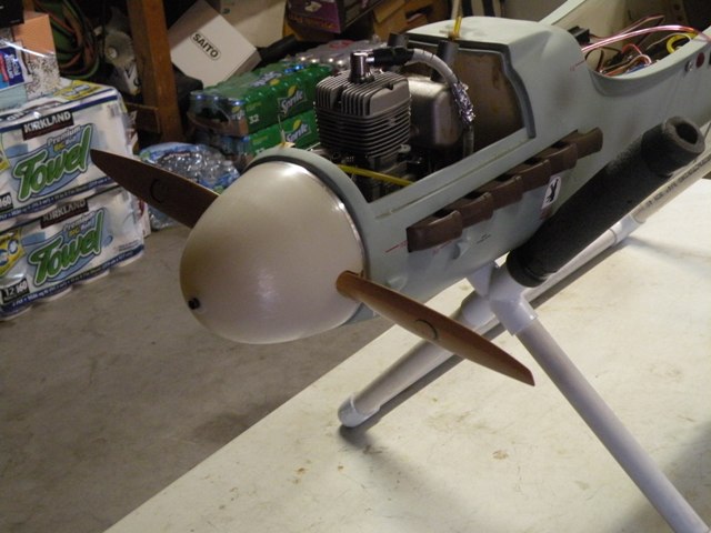

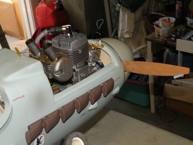

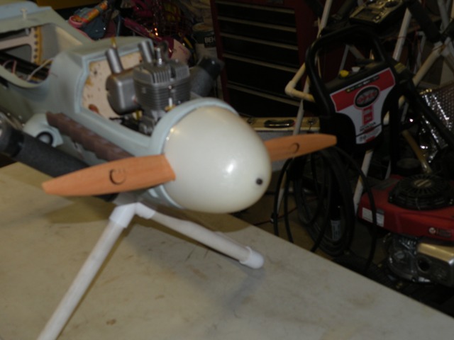

Making a bit of progress again. I received the reducing bushing from Tru Turn for the Dave Platt spinner backplate. Tru Turn was a bit expensive but the bushing was a perfect fit so it was worth the cost and wait. I also fit the spinner to the prop and backplate using a 3/8"-24 X-long spinner adapter from Dave Brown. Now I need to paint the spinner and then get back to the engine break-in runs.
Best wishes and good safe flying.

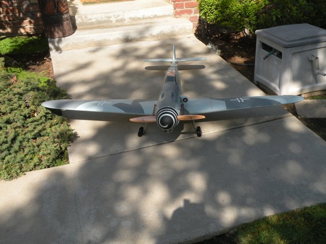

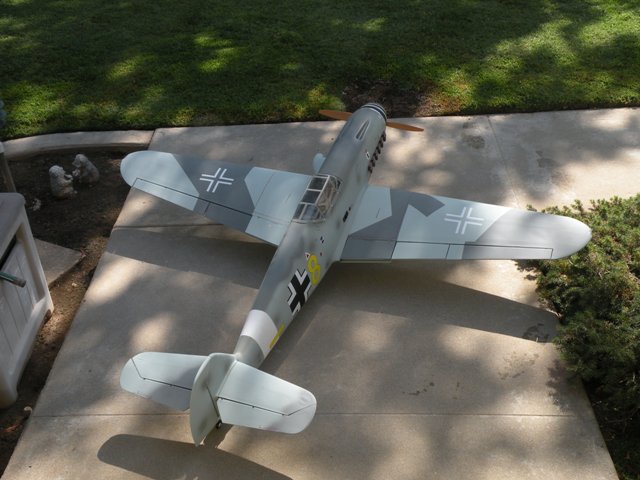

I painted the spinner and completed another engine break-in run. The engine is running much smoother with the big spinner and a little tuning. My plane is now ready for its maiden flight.

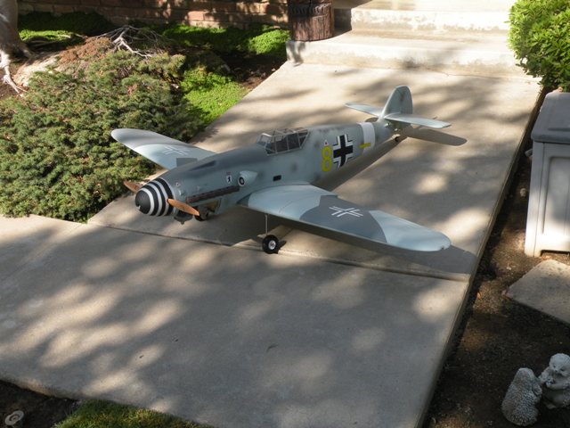

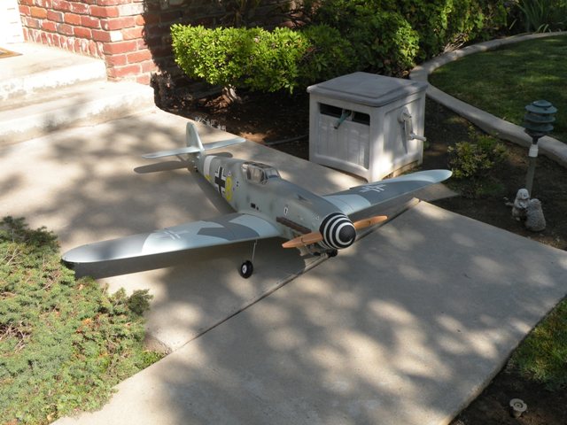

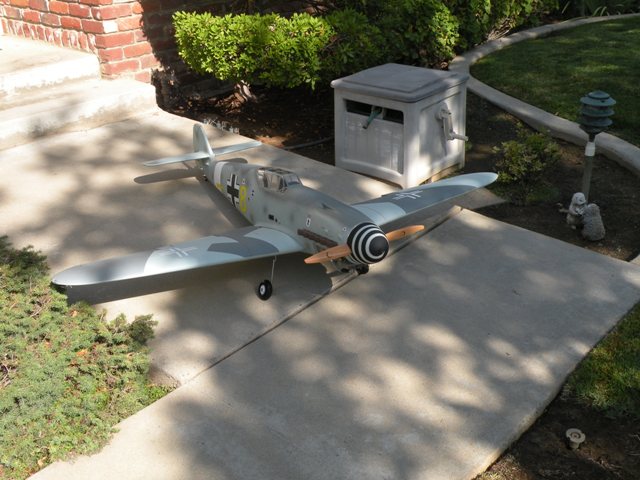

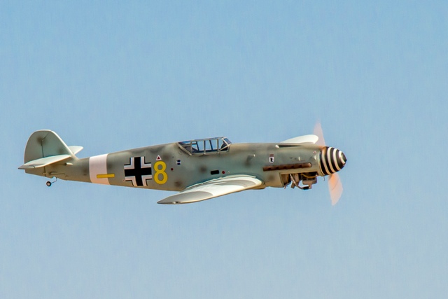

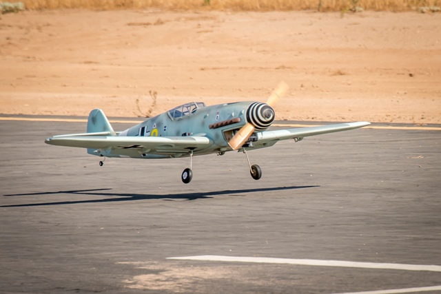

I had my maiden flights on the 109 Wednesday morning. The plane flew very well and the engine ran great. The only issue encountered was the tendency for the landing gear to bounce if one trys to turn the plane while at any speed on landing. Even slight corrections on the ground result in severe bouncing. I got away with it the first flight but the second flight resulted in a nose over and broken prop. I am not sure how to cure this issue except to let the plane roll out until very slow on landing. I used the retracts sold by Nitro planes for the 109 and they work well but seem a bit on the weak side for this plane. Here are some pictures of the maiden flights.
Heli-NuBee (AKA Roger the radial rabbit)

Just a thought on the bouncing, it may be that the wing is still producing lift at landing speed and the bounce is the result of the wing still trying to fly, if you reflex (up about 5mm) the ailerons on landing approach it will dump some of the lift and also add washout to the wings, the airframe will descend quicker and help the tips not to stall, I use reflex on all of my planes including jets it works very well.
Mike

Congrads on the successful maiden. On landing I left the aircraft come to almost a complete stop before turning. Otherwise it will drag a wingtip. We fly off grass so the landing roll is not too long.

The plane is quirky on the ground, as any scale 109 should be !
In the air its a real performer

Congratulations on the maiden, your landing picture tells the story of the bounce. You are in a three point stance, that with 20 degrees or less of flap.
If you ever read Pappy Boyingtons book, specifically the first landing he made at his AVG base he addresses this pretty well. Basically he tried to three point a P-40, in spite of the pilots manual saying “Never three point, Always wheel land this plane”.
The wing flying is what dampens the bounce from the un-dampened oleos, or wires on pavement. I’ve made that mistake a few times and not been as lucky as you.
