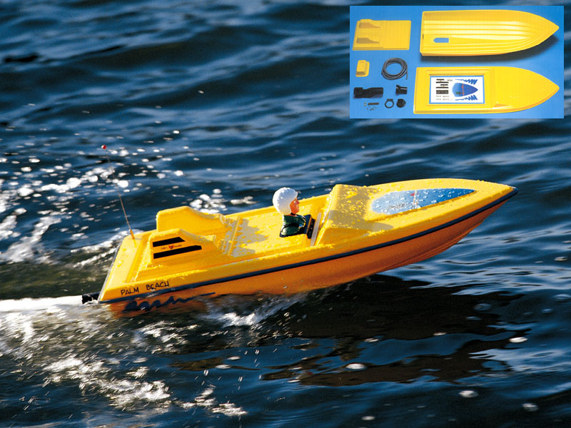

It is Billing Boats -Palm Beach http://home.wanadoo.nl/stuipsmulders...boats_kits.htm

Eyekandy yeah its the palm beach boat. We got a deal on a KMB drive with the boat.
For the heck of it lets say I used a 12L, how many cells would that require, I guess I'm just confused as to how to quantify the difference in voltage and RPM in a brushless vs. brushed setup. So if you were me and wanted more power, but wanted to go lighter, what would you do?
