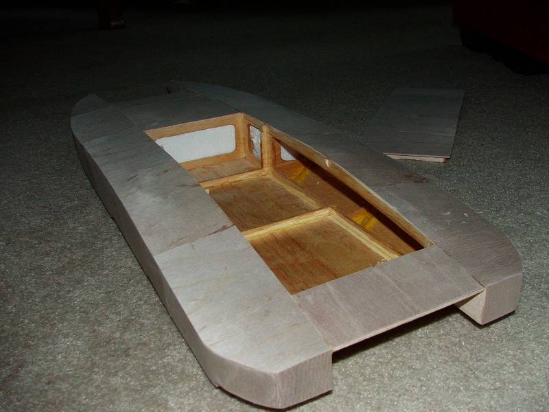

An up date: Armor plating is complete. The boat is ready for water proofing and then hardware. The rudder is going to run deep, and I think she'll like that. Any one know a good place to pick up some steering rod and bellows? I need to do this right as I expect the bellows to be 1/2 submerged when the boat is idle. I have the servo and reciever and will order the motor soon, and the SC when I get back from china.

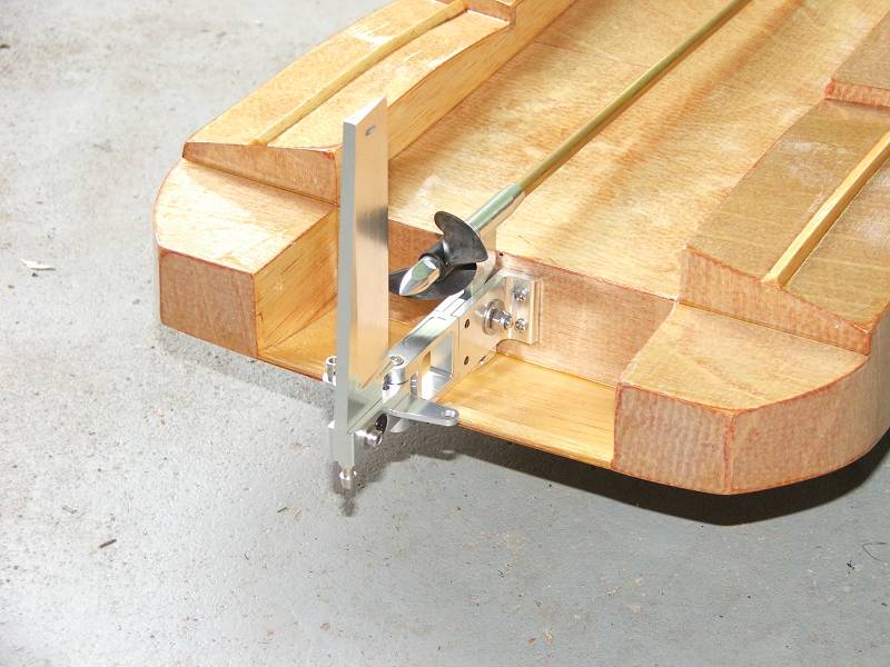

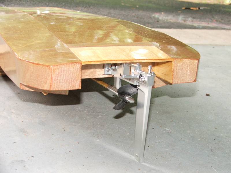

Wow I can't believe how far this has slipped down! I'm really slow. I have some new pics but progress is slow due to time and finances being absorbed elsewhere. Hull will float and I mounted the outboard hardware yesterday after some modifications to make it fit properly. I'm assuming that being able to move the cetner of the prop shaft one half of a diameter above the bottom of the lowest point of the hull to 1/2 a diameter below would be enough adjustment for any post build tuning I would need to do (I actually have about double that). Is this true? Also I'm ready to put the steering servo in. Where's a good place to get the linkage and boots to go though the transom. I'd like to find a good variety to pick from as this might be kind of non standard. Or is there any common material in HW stores that I'm not thinking of that make good linkage material? I don't want to use a bent up paperclip but I'm willing to fab up something creative if it makes sense and looks/work well. I'll post the latest pics soon.

Still hoping for some recomendation for steering linking and such. Not a subject that gets much information around here. Here are the most recent photos.

Scott, I don't quite understand what you are wanting to know. For steering you use a pushrod with a clevis on each end as with any other boat.

Yea. Sorry but I haven't been able to find much of a selection anywhere. Considering I don't really know what I need I'd like to find some cheap and buy a few. Boots too. I'd expect to see a bunch on OSE but I didn't see much of anything. First time I've ever seen the word clevis on this site.

What I have done in the past is used some brass tubing larger than the pushrod and teflon diameter. This gave me room to mount the pushrod seal on to. Then the pushrod is cut to size. I like to use a metal Clevis on the servo end and an adjustable threaded Clevis, plastic to avoid metal on metal on the steering arm. In some cases I use E Z connectors to allow quicker adjustments to allow the servo to be in the proper position.
A serach on Tower Hobbies using the words clevis and EZ connectors sometimes called screw lock connectors should give you tons of results.

That's what I needed. Thanks.

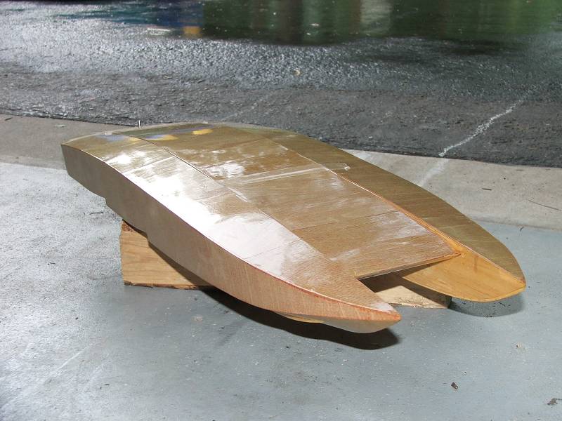

Default RE: Scratch Build - 29" Balsa Stepped Cat
The photos in post 117 it has 3 coats of waterbased urathane on it. That's the way it's staying for now. I want people to know its wood. I may put some graphics on it some day to dress it up but for now the exterior is complete less the canopy which is not necessary for testing. Yea the hardware is nice. I just hope it's reliable. I should probably order a few more cables from him.
