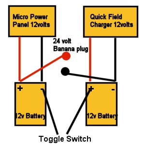

Here is a diagram........
Thanks to Minnflyer

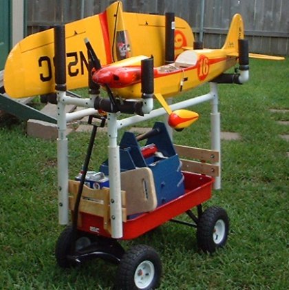

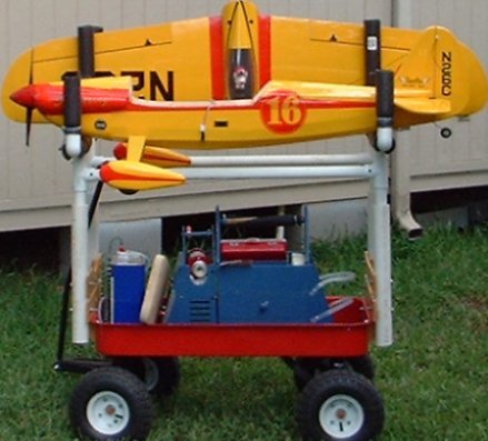

rc_for_me,
Here is my setup that is on this thread. Check out post
http://www.rcuniverse.com/showthread...55#post1005169
It has a Mark II Quick field charger and a micro panel to run fuel and backup glow igniter. Also to run my Dynatron at 12 volts. But when I need to start my gasser I plug the starter into the 24v outlet and flip the toggle switch and voila, 24volts!
Here is a picturee

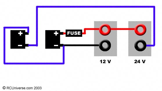

Thanks to DrDeath and Hircflyer for the dual battery wiring diagrams.

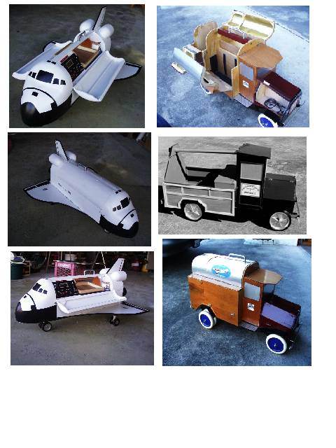

Well Billy, did you have any idea what you started when you first created the "Field Box From Hell"? Now I see you have also created the "Ultimate Field Charge Box from Hell"
Well, thanks to your inspiration, I have combined the two into my own creation. I'm not sure what to call it, but it is like the "Ultimate Field/Charge Box from Heaven"!
I'd sure like you to take a look at it and let me know what you think. If you have any suggestions, please feel free to share them.
Below are some thumbnail pictures and you can find all the details on my website by Clicking Here
Click on any picture for larger view.
Thanks again Billy for the inspiration.
