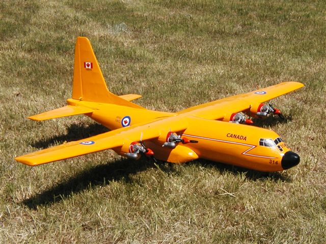

New C130 model, guys ths is my feeble attempt, it will never win scale but it sure does fly great 102" 4/25 16 lbs

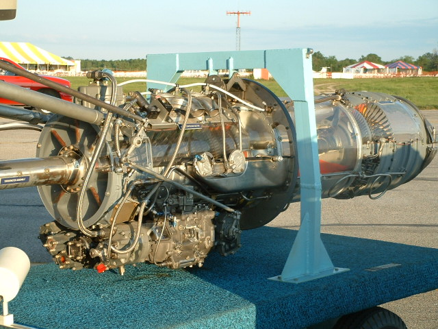

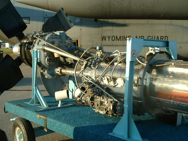

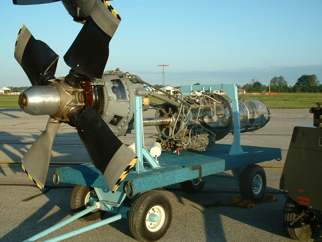

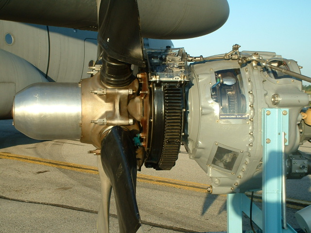

Our local airshow was this wknd at London, Ont. And the Wyoming Air guard brought an Herk. They had on display an mock engine and prop very cool.
Grinder.

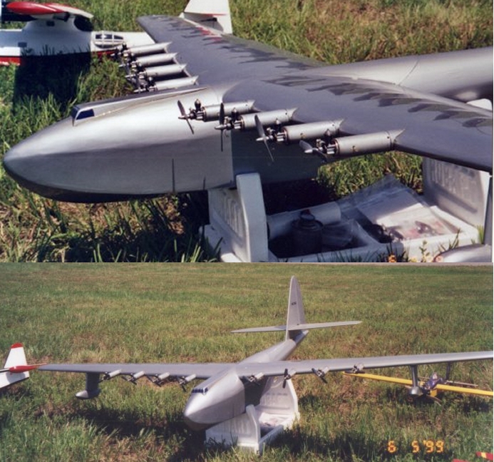

Can't say about eight 0.25 engines, this one had about one foot of span for each of its 0.010 engines. You can judge size by the Robart stand it's sitting on.
Bill.

Default RE: C-130 updates
Thanks for those pics, Bill. That would be an awesome model, but I don't have any water around here to fly it off of. Maybe I'd have to wait for snow like I've seen some do with seaplanes. I bought a plastic kit of the Goose at the AF Museum a couple weeks ago. Maybe I'll be content to build that for now!!
