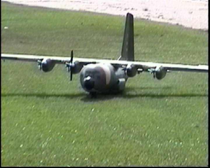

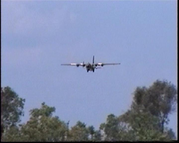

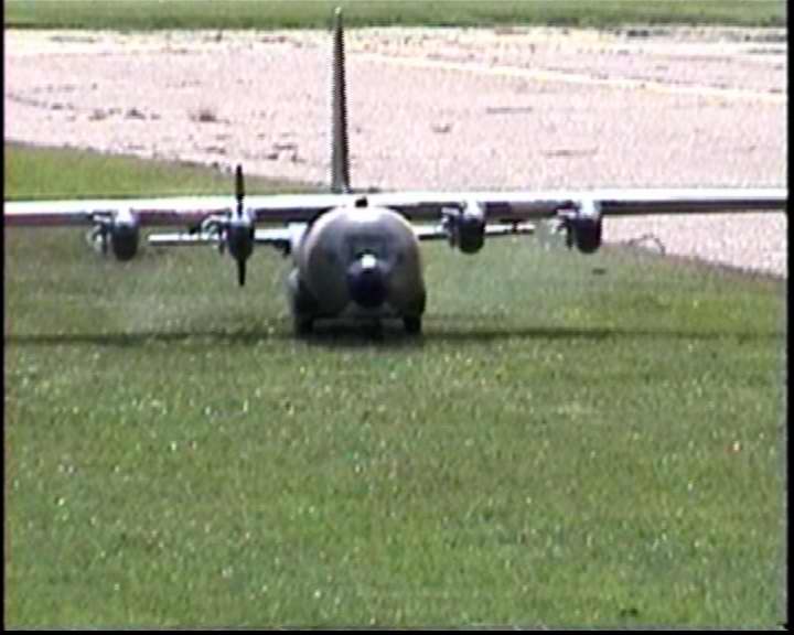

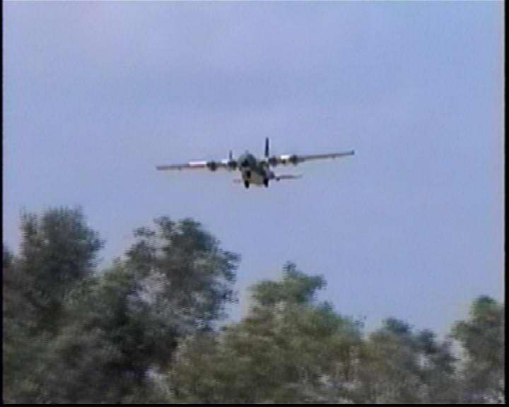

Well Guys, the Mobile fly-in was a great one to go to if you want to see the scale stuff in a not so crowded environment.
YES... the C-130 of Jim's is on tape with the engine out. Jim you did a great job with the plane. I am going to attempt to post a picture of the engine out as soon as I convert it to jpg. I also have some highlights of the event on DVD if anyone wants a copy. Just email me and we can work something out. Nice to met you Jim, and I will probably be calling on you soon to help setup the engines on the wing.
Everybody..... it does fly..... Jim can land on 3 engines.... and YES.... the crowd loves C-130's!!!!
Bill Richardson
Bill Richardson

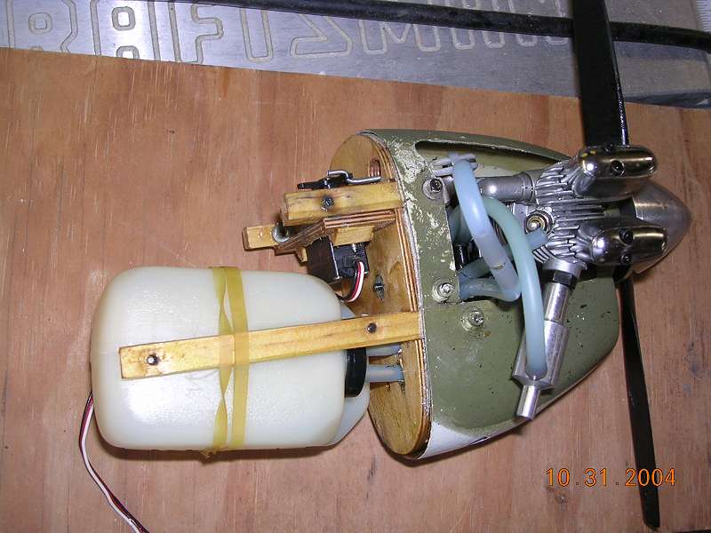

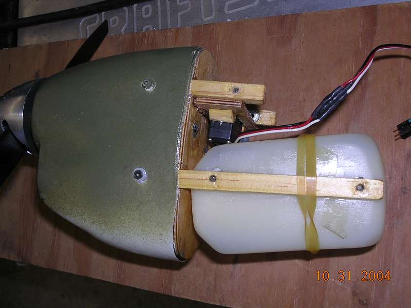

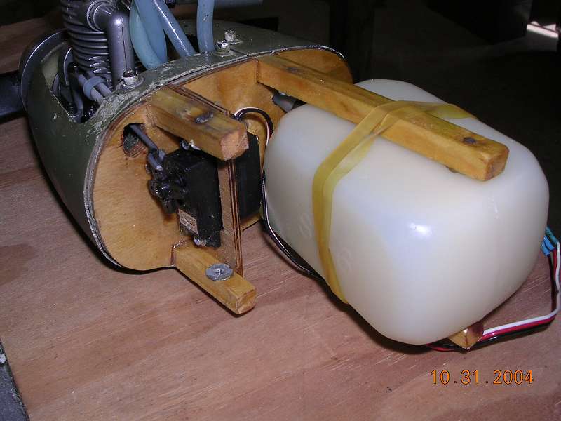

Great pics Bill. Thanks for taking them. I never have a time to take pics when Flying the herk. Closer examination of why the engine quit. I was right the tank leaked the fuel and quit in flight. The reason it lead is the dumb thumb who put the tank together forgot to tighten the screw holding the rubber stopper in the Dubro tank. Dah,, wonder who did that?
. It took me only a few minutes to pull the engine nacell and fix the problem. About 10 minutes from start to finish. I did photo the nacell taken apart and will add to this note. Bill once again, nice meeting you and I am willing to help any time. PS I drink coors.

Wow! great shots! Except for the taxi pictures, it would be almost impossible to tell if it's the real thing or not.
I'll keep the tanks in mind when I get to that point on mine(palmer - 11') for sure!

Randy now you have asked the real question. Have I pulled all 4 nacells? [&o] No,, but I did do #3 and thought about the others.
But consider there were some indicators of problem before the flight. There was fuel leaking from the nacell just prior to take off and the engine was running ok,, I thought just what vented out of the vent line. (two line tank with 1 to muf. std) But I should have looked closer. The loose screw was the one on the stopper on the Dubro tank that I forgot to tighten. I guess the assembly line for 4 engines missed one. It was tight enough in the tank to work for a while until pressure moved the plug forward with vibration.
Everything else is tight, and no other engine is leaking or cycling.
One other indicator I should have seen was the engine needed 1 click change richer on the needle on that 1 engine prior to flight. ( I do use a precision tac prior the the first flight to confirm engine settings). The saito's need little if any adjustments so when just 1 of 4 needs adjustments it is time to look around.
Besides How else could I practice an engine out approach and landing. The only thing I forgot was to call the tower and declare and emergency.
