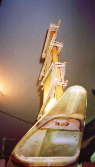

I was getting ready to prime the fuse when I started messing around with more and more glazing putty.... and realized that the vertical stab is weak from side to side. I thought about going inside just above the horz stab and put in some foam sheeting and light fiberglass coat to firm it up... Jim or Randy... any ideas or am I thinking to much? It just seems weak enought that if is handled in the wrong way.. the fiberglass will crack or the paint will be damaged.

. .............any ideas or am I thinking to much? It just seems weak enought that if is handled in the wrong way...........
Well, if you're thinking too much, we must both be guilty of it! I thought the same thing. I wasn't so much concerned about breaking it as possible in flight flutter, or the application of rudder making the stab sway back and forth. Here's two pics of how I reinforced mine, maybe you can tell from the pics. I put three vertical pieces in the stab to get the sag out of it. the forward one pretty much follows the angle of the front of the stab. The second piece goes straight up and meets the forward piece at the top. and the rear piece is of course the trailing edge of the stab, where the hinges are fitted. I then glued two cross pieces on the bottom across the opening, which you can see in the pics. This stiffened it up substantially. I used Elmers Polyurethane. Makes a mess, but holds like the dickens. Hope this helps.

You are right the vertical fin is weak in side to side. If you look closely you will see the curvature is more on the left side than the right. Hope this was built in to help with right rudder on take off. I used a spruce spar in the vertical fin at the trailing edge with two 1/8" plates to stablize the side to side. Pic attached

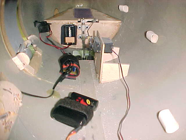

I have the same plane as Jimcork. Mine is not what I consider pitch sensitve. handles very nicely on take off and in the air. But, it does respond to very little trim inputs when in the air. As far as flying, It doesn't seem sensitive on the sticks. The exponential that i have plugged in may also help that.

I'm trying to figure out where the weight differences is in our two planes. Mine finished out at 17#, and I did some things over and above what the plans called for. I used all 1/4" ply inside for the gear box and nose gear mounts, as well as some other stuff. Just wasn't comfortable with the 1/8" stuff called for on the plans. I just went out and checked mine again, and I do not have any lead in the nose. I built a platform/shelf in the nose forward of the nose gear to attach any weight and/or the battery to in order to get it as far forward as possible. Turns out that I only needed the battery pack to balance with.
I do have a few other goodies up there, but not that much, as the picture shows.
From the top of the picture to the bottom, is:
1. Velcro on the shelf for attachment of battery pack
2. Switch on left side for rotating beacon.
3. 9volt battery (for rotating beacon) on the nose gear bulkhead next to the nose gear
4. Door on left side
5. electronics for rotating beacon below door
6. Nose gear servo in the center
7. bottom of pic is the battery pack which is now in the nose.
The tubes on the right side are sleeves for the battery extension back tothe receiver
Maybe the plywood I used made the difference.
Well, DUH! I just remembered that your aft section comes off and you have a flight pack back there don't you? Now my feeble memory is coming back. Anyway, your plane still looks to fly super at 22# according to the videos. Good luck on the Mobile trip.
