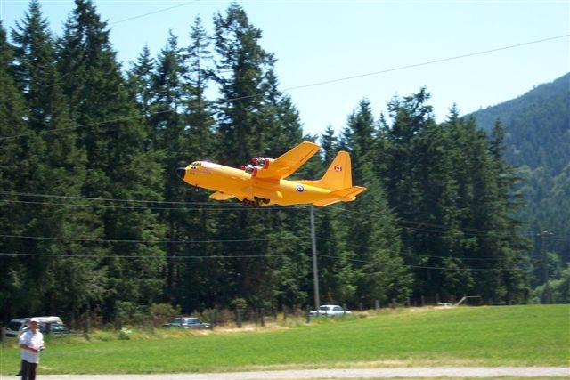

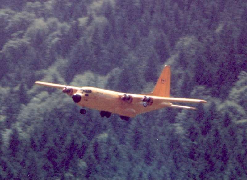

Joined: Aug 2002
Posts: 528
From: Chemainus, BC,
Default RE: C-130 Pics
HI Jim, yes I flew the Herk, it was a big ***** cat, it was off and flying in about 50 feet, no flaps, some low runs for picture taking and it came back on like it was on rails, again, no flaps needed, I am flying off a very small grass strip, what a rush !!!!!
ID:	171207   Click image for larger version
ID:	171208   Click image for larger version

Nice pics, Mike.That yellow sure shows up in flight. Unless we have a bright sunny day, mine just becomes a silhouette in the sky and I can't really tell top from bottom, since it's gloss black on the bottom and camo on top. Haven't gotten to fly mine for a couple weeks. Intended to Sunday, but darned if I was going to in a direct 15-20kt crosswind. Probably would have been fine, but it's still in the trailer in one piece. Can't see taking a chance on spoiling a lot of time and building effort just to get in a flight. Besides, I had plenty of other stuff to fly. I need to get some good still pics like yours next time I'm out.
Later,
Randy

What was the final weight.. Also did you check the wing incident to tail?
Old 09-07-2004 | 09:40 PM
  #492
Joined: Aug 2002
Posts: 528
Default RE: C-130 updates
Hey Jim , its up weight was 16.5 lbs, I went with 1/1/2 postive on tne main wing, zero in th tail plane and zero zero on the engins, 2 degrees of washout on the tips, 5 flawless flights so far and I still have to try out the flaps, the only problem I have encountered is crosswinds, the only way I could take off was with full dwon elevator to hold the nose wheel on until I got up flying speed, I went with the SAR yellow for the same reason you state, I have a few warbirds in camo and the turn onto the runway is against a vary dark mountain side and they just vanish, re picture, you may notice no cowlings on for the first flights MIke

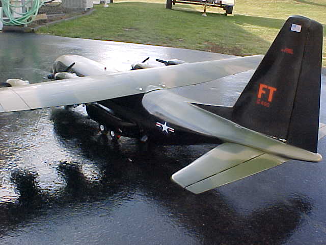

Did any of your stabs fit perfect in the saddle?
========That is something that took me a long time to get fit right. When it appreared to be right, it wasn't. I ended up cutting off more of the front of the stab to get it to fit properly. I believe if you set it where you think it should be, you'll end up with negative incicence in the stab. I got pics at home and I'll post one when I get there.
............................... and the rear of the stab hangs over the rear of the saddle. Is this normal?
I think my stab hangs over a little.
And did anybody put ribs in the fuse to support the fiberglass?
-----------I put some reinforcement around the wing saddle area and where the vertical stab meets the fuselage, but other than that, I didn't put any other bulkheads in.
Randy
Old 09-13-2004 | 04:09 PM
  #495
rryman's Avatar
Posts: 986
From: Loris, SC
Bill,
Here's a pic of the rear of the plane. The trailing edge of the stab is 3-7/8" from the rear tip of the fuselage that overhangs it. That is where mine ended up and it flew right off with almost no elevator trim required.
Randy
