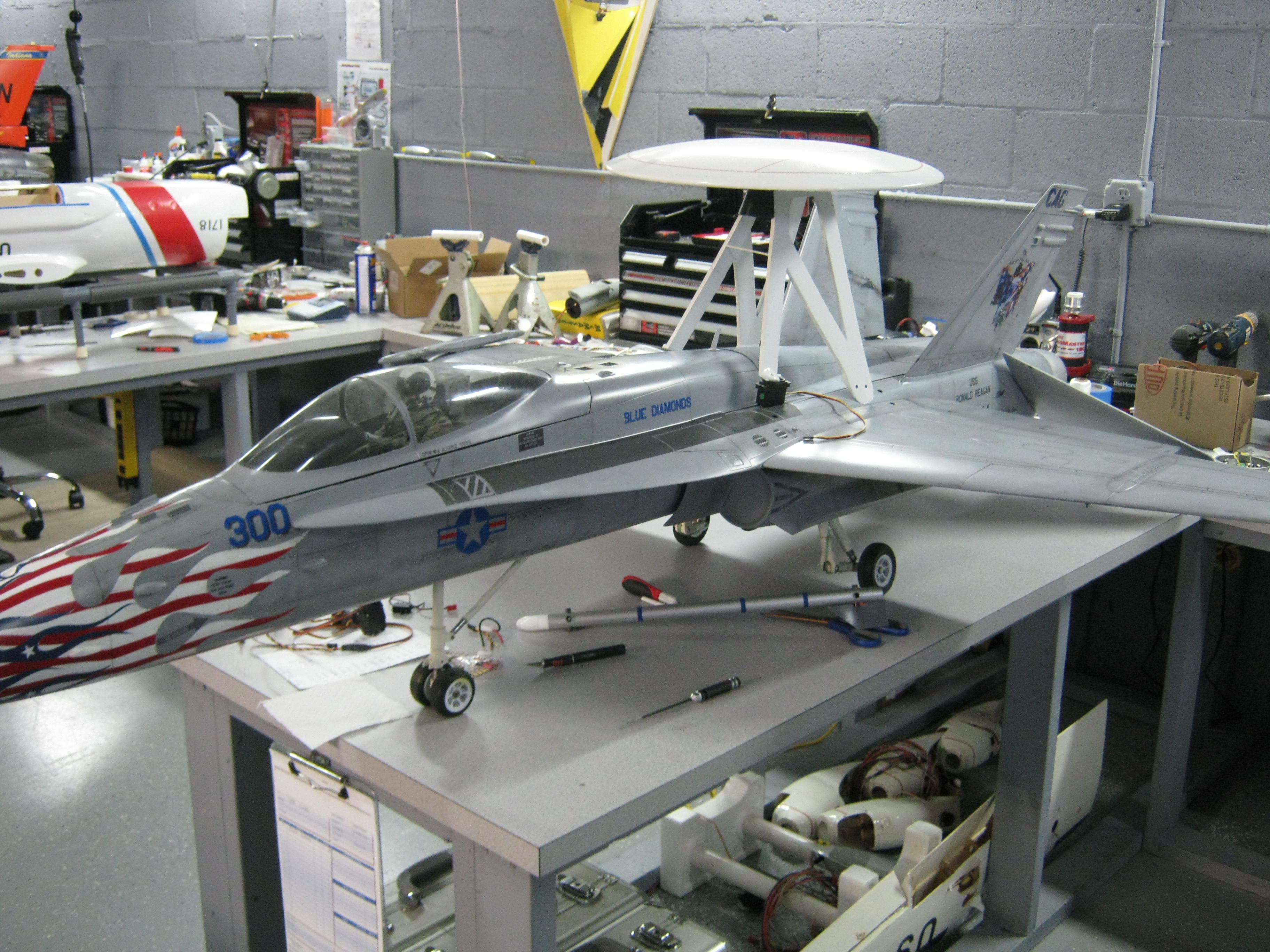

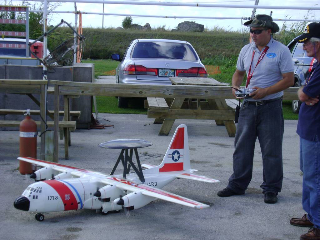

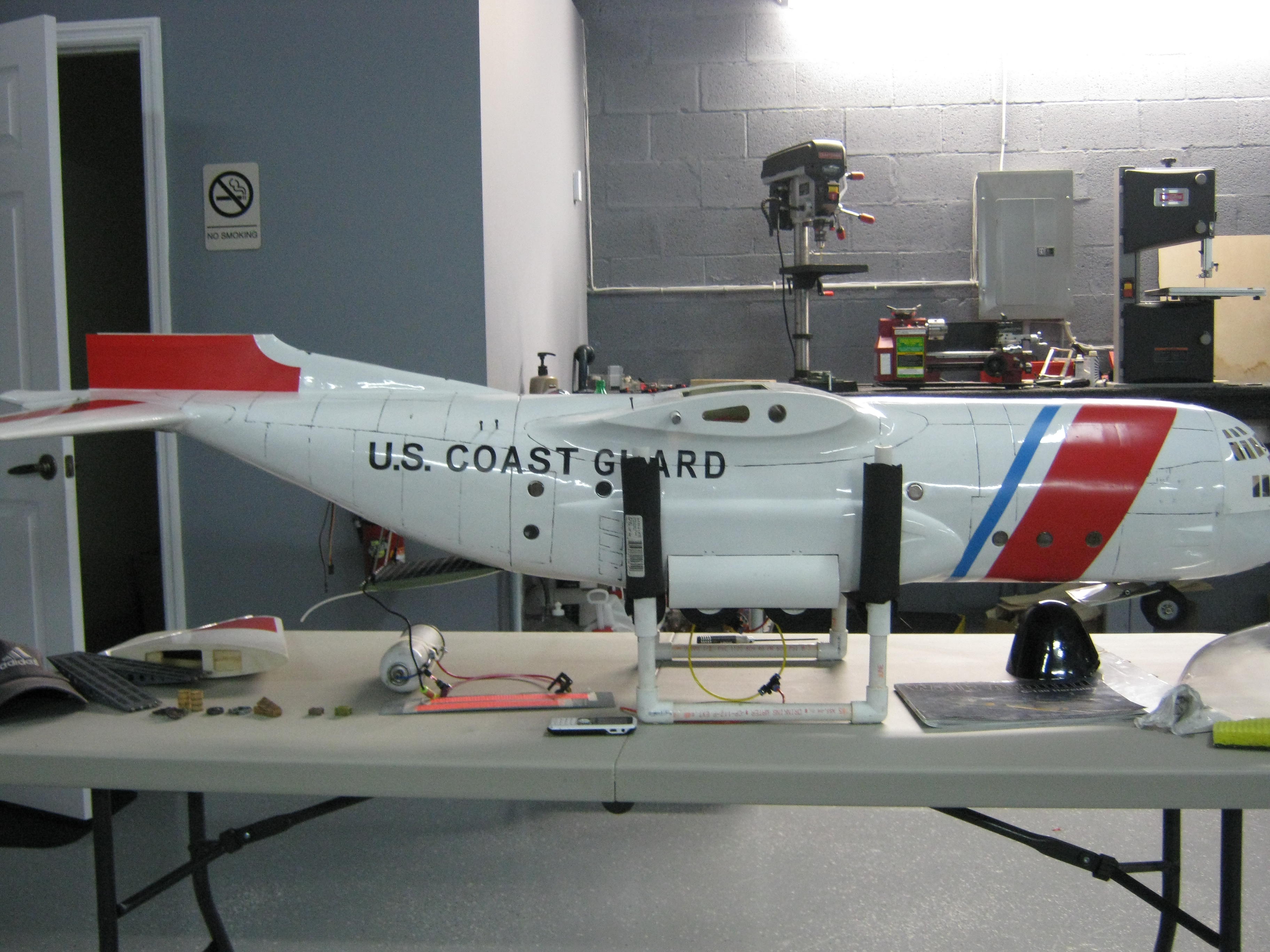

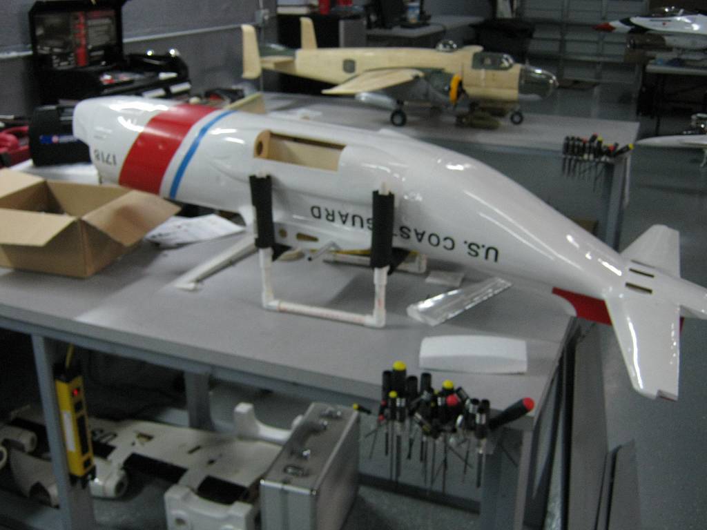

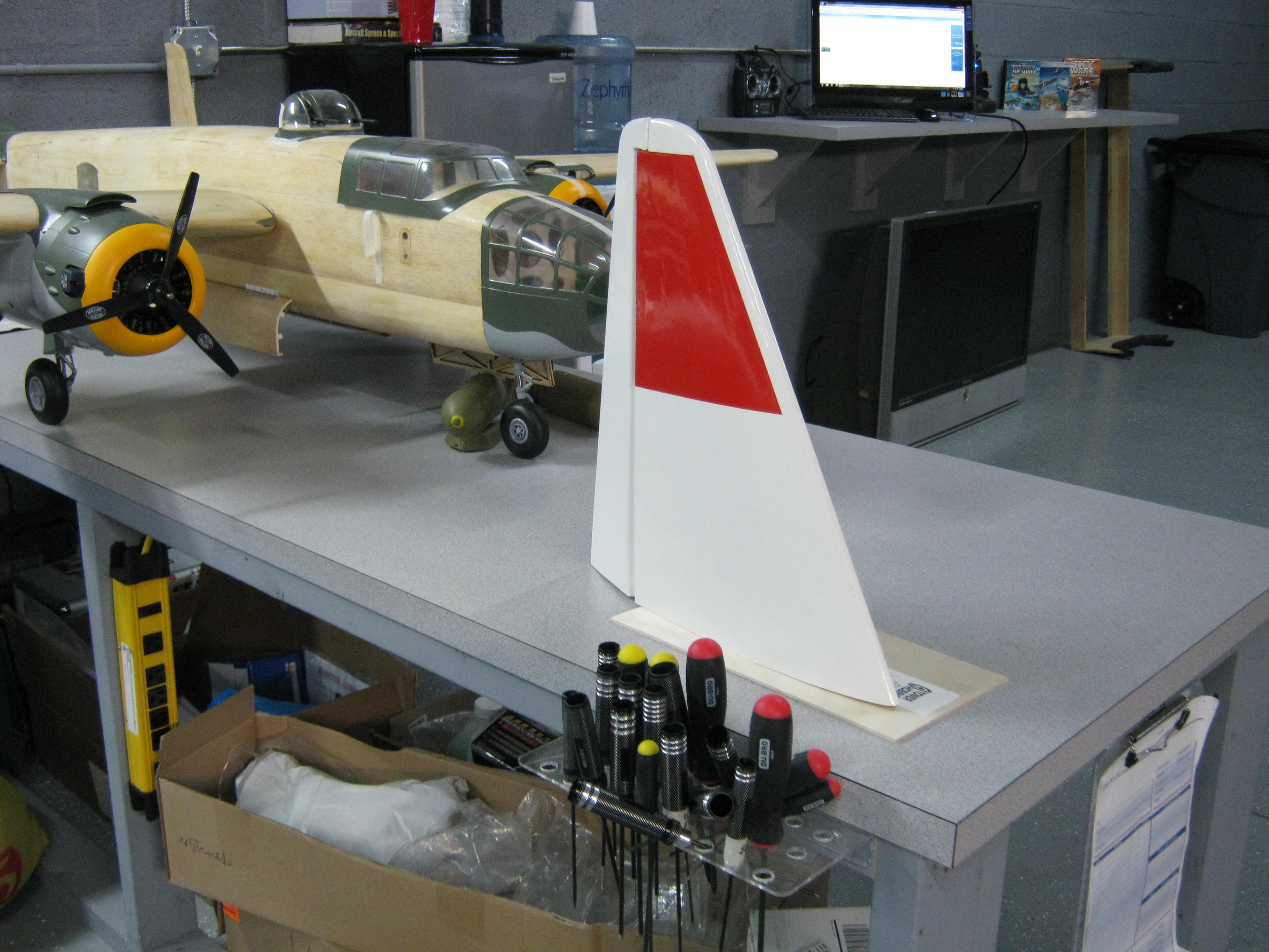

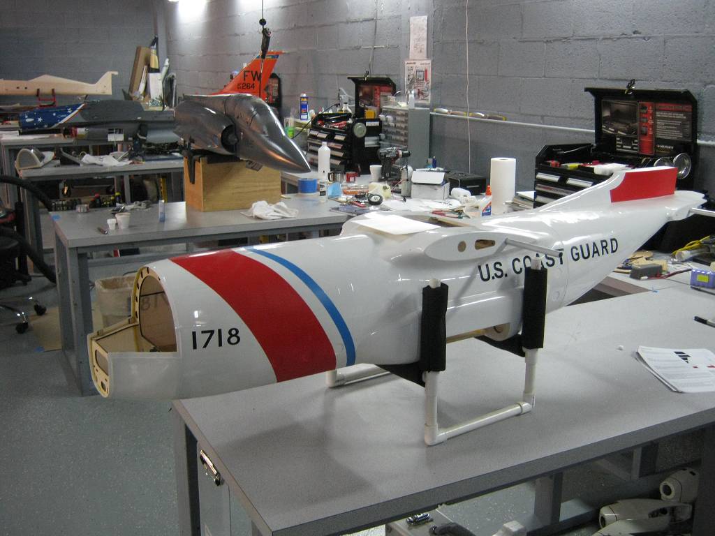

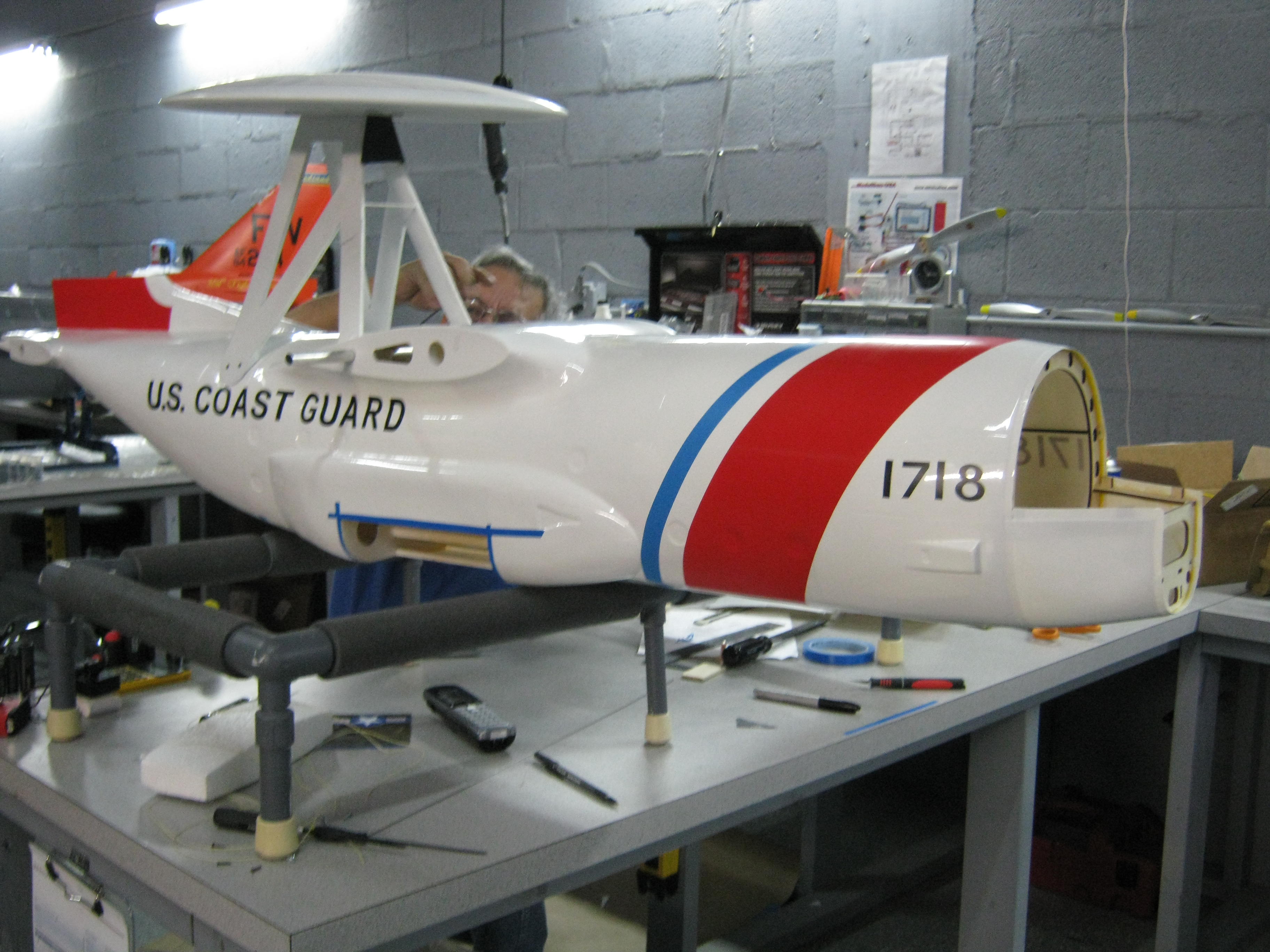

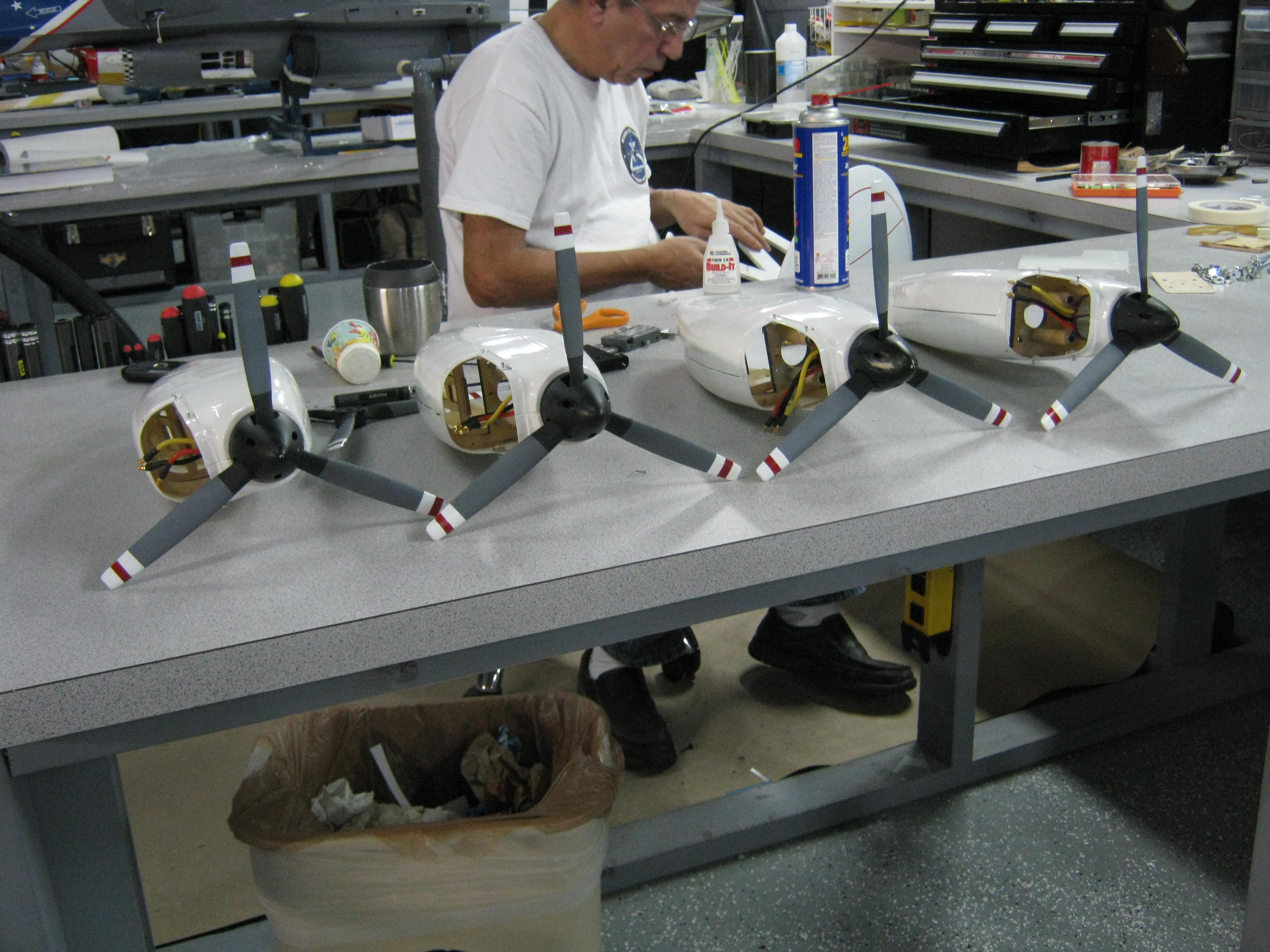

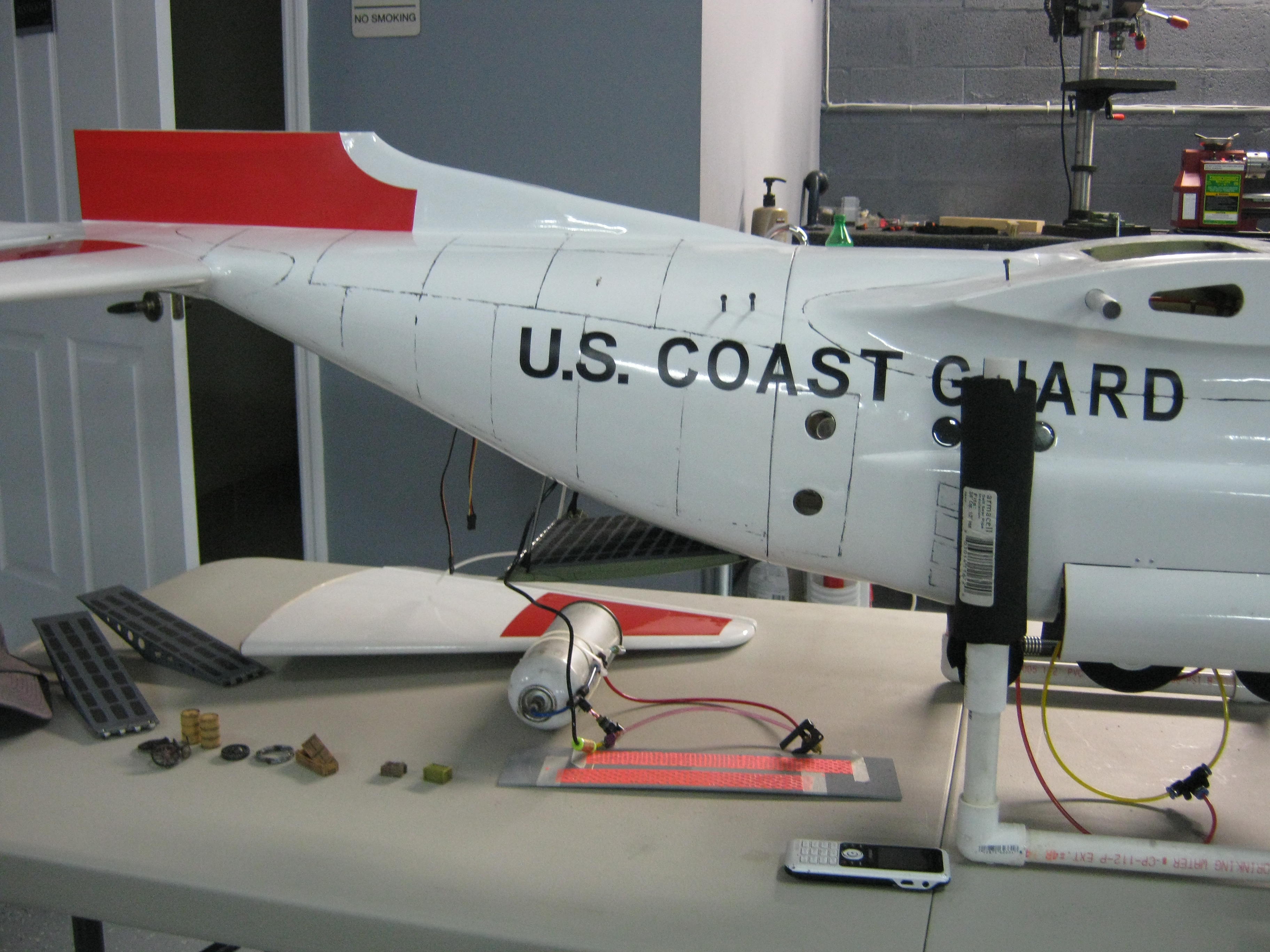

This is the picture of Bob's previous 170 flights ASM C-130, the last picture was at Higher PRoductions SEFF 2010 AWAC C-130

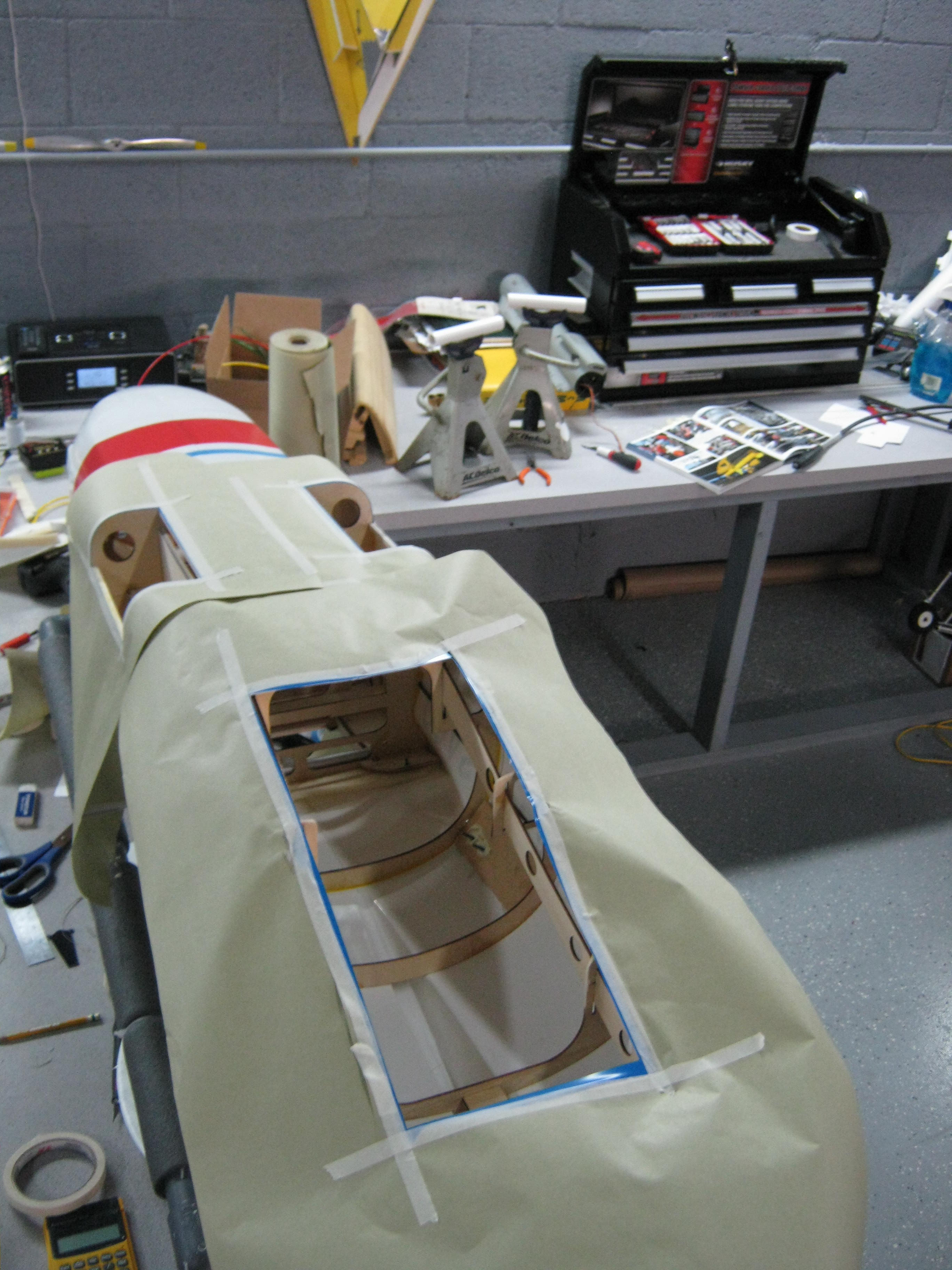

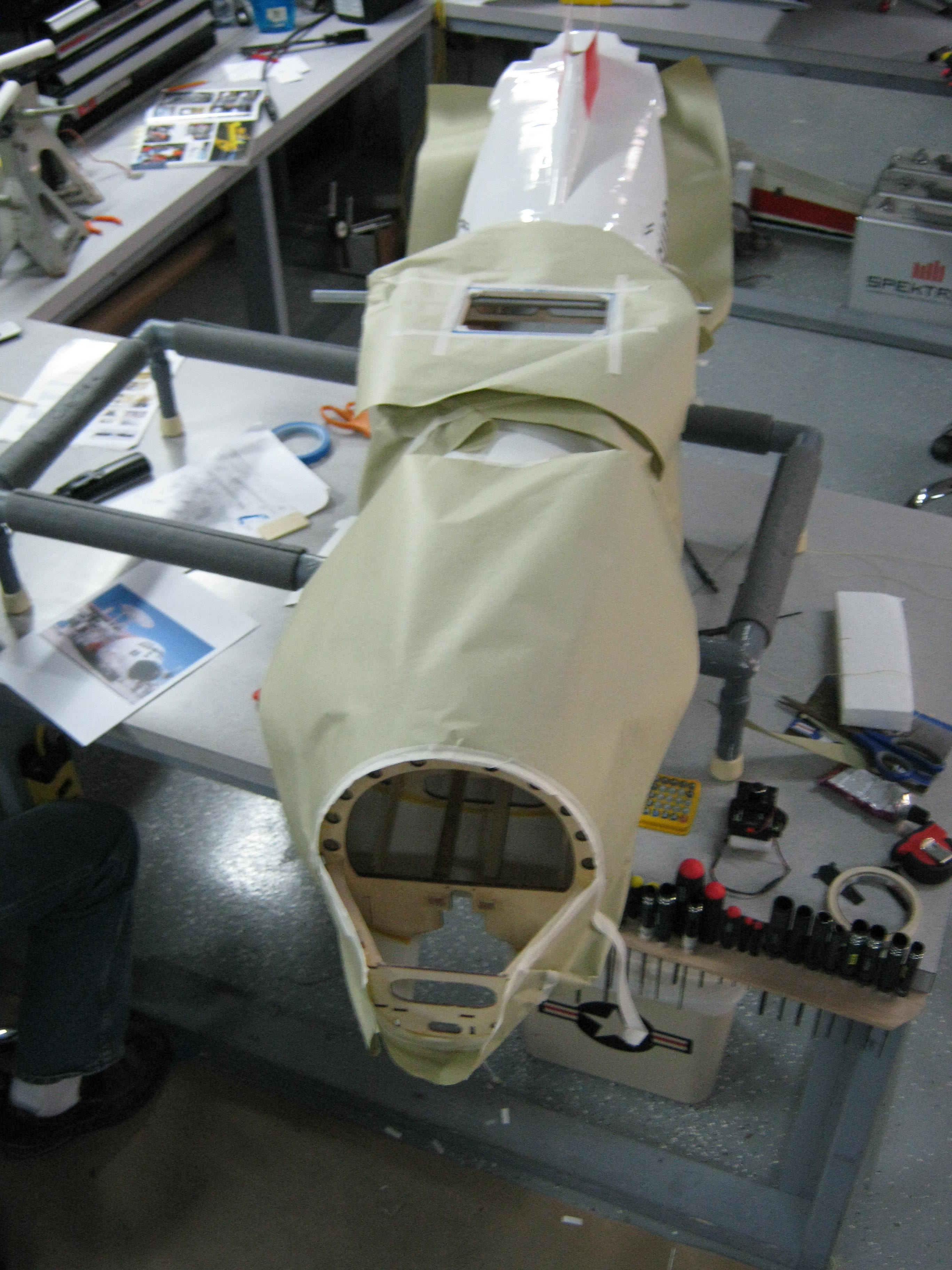

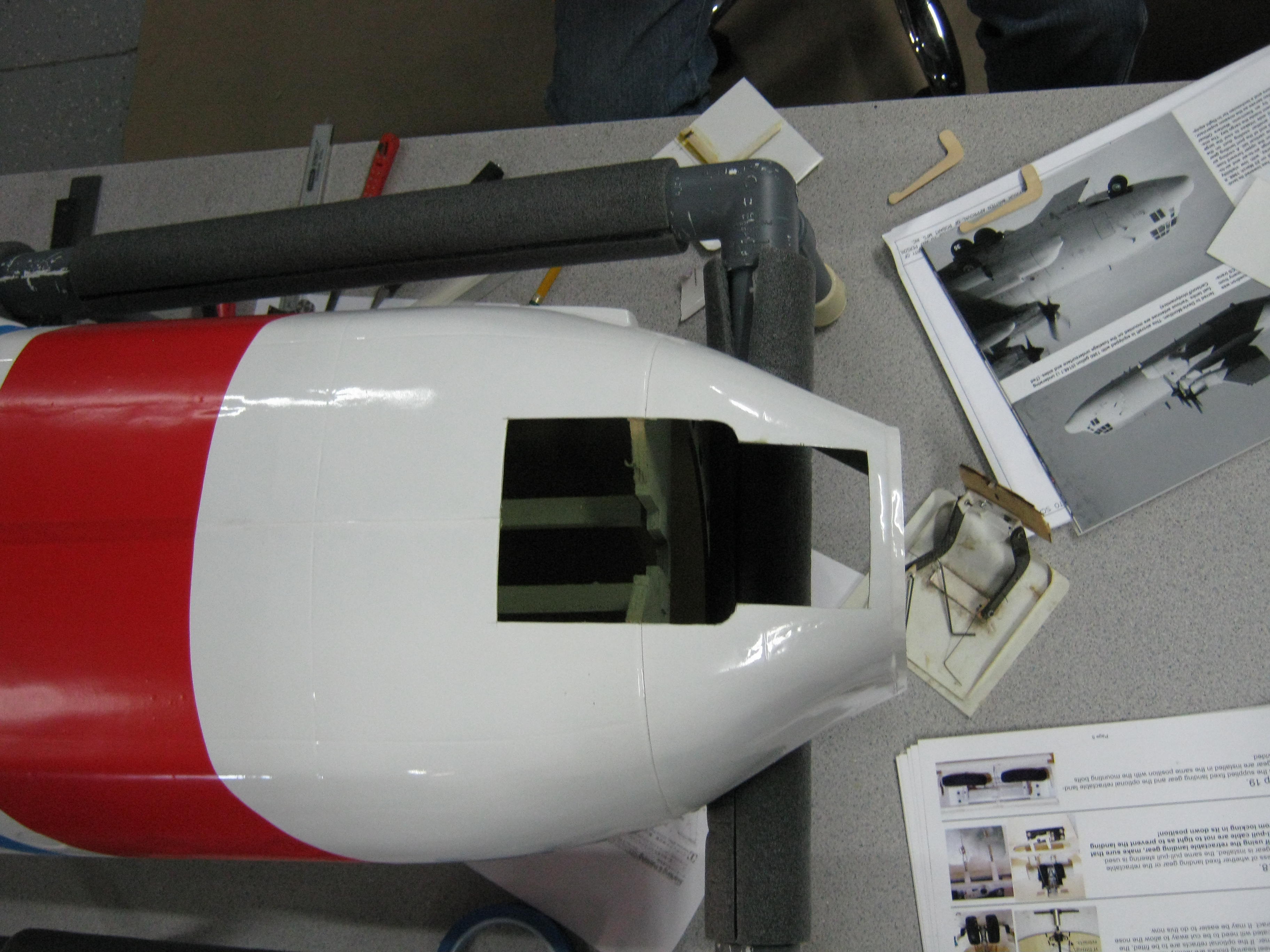

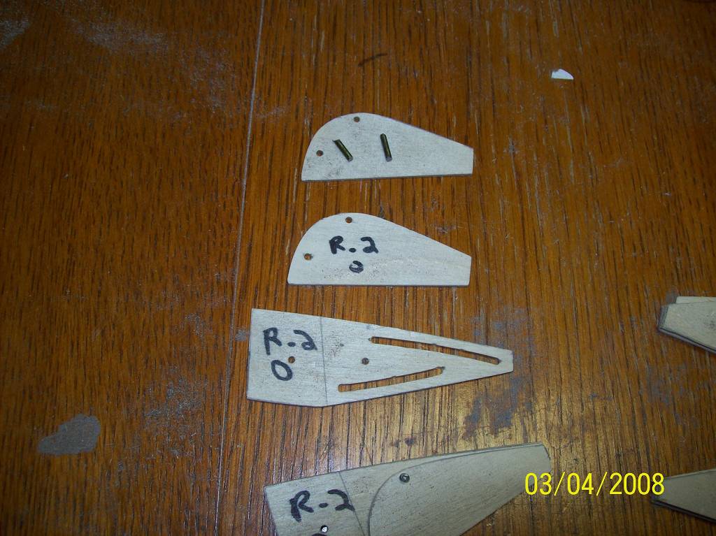

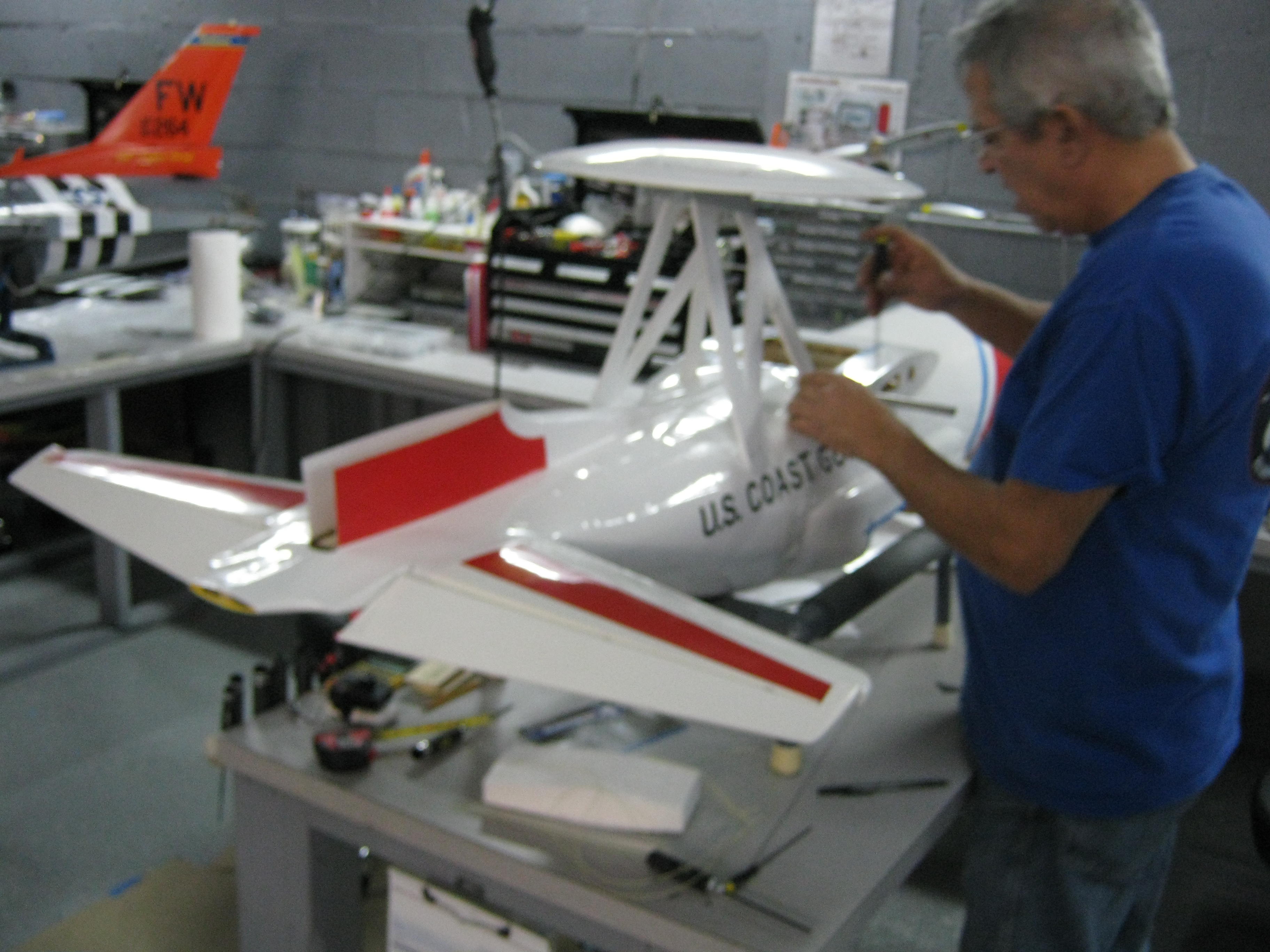

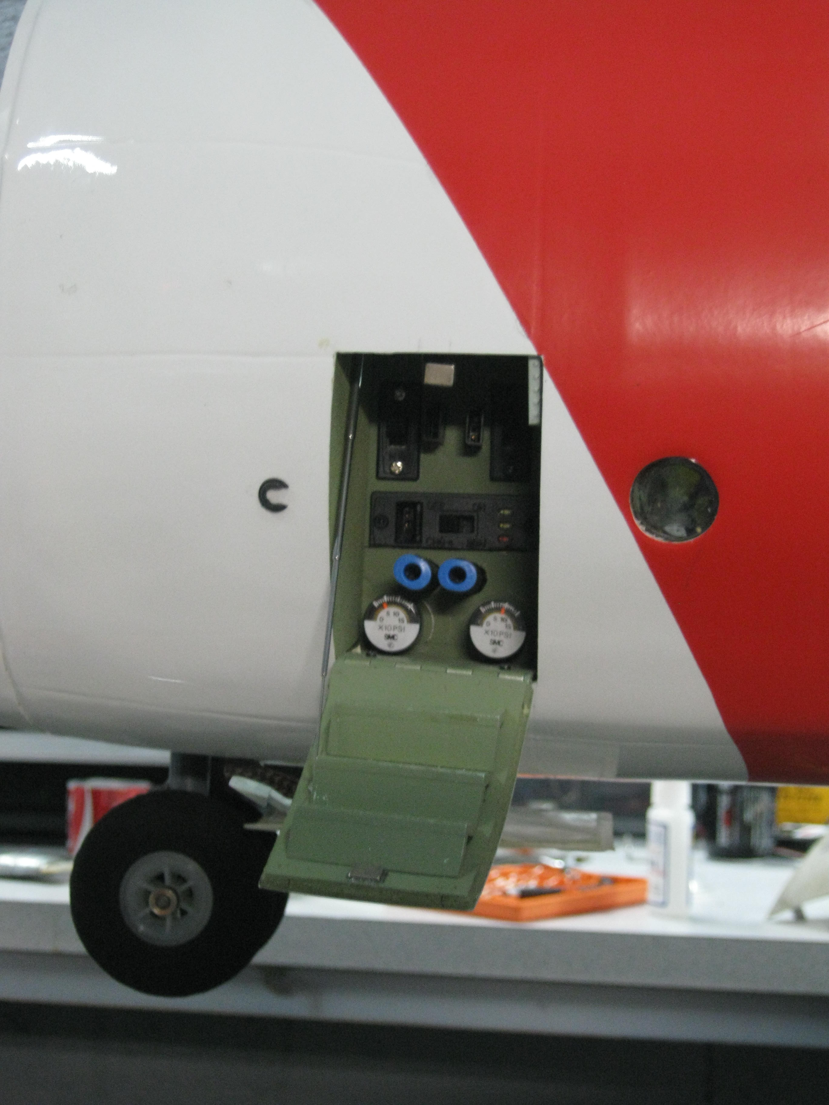

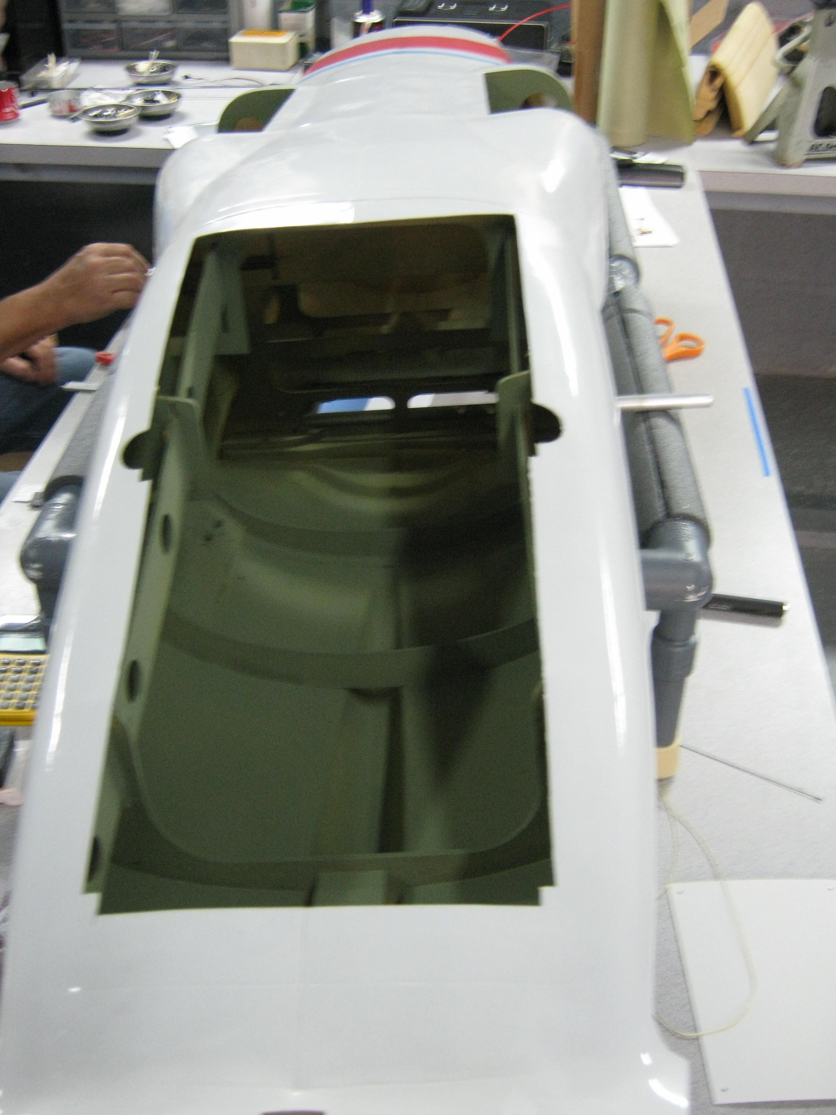

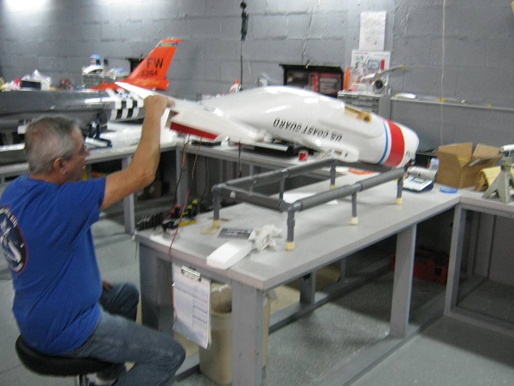

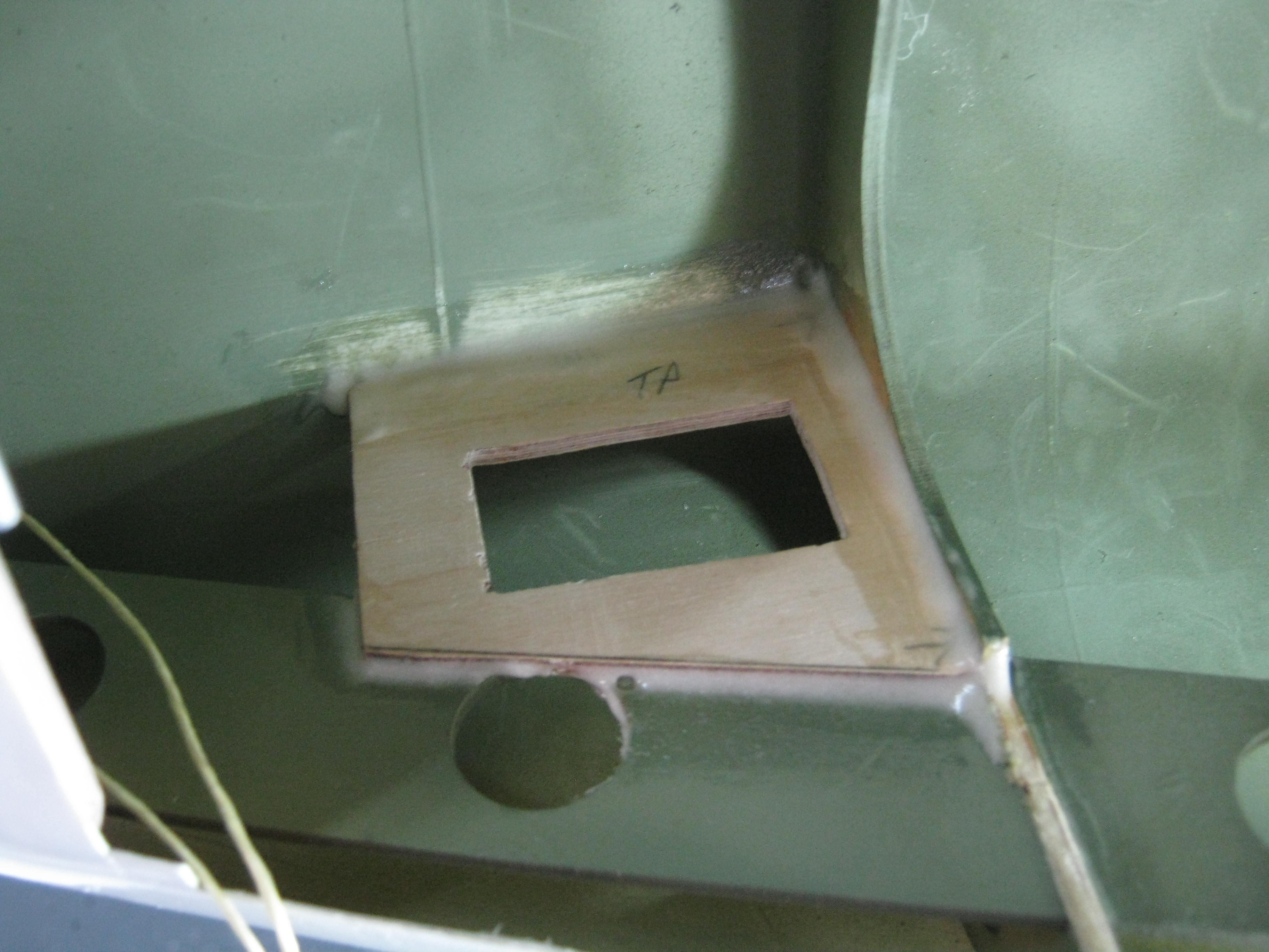

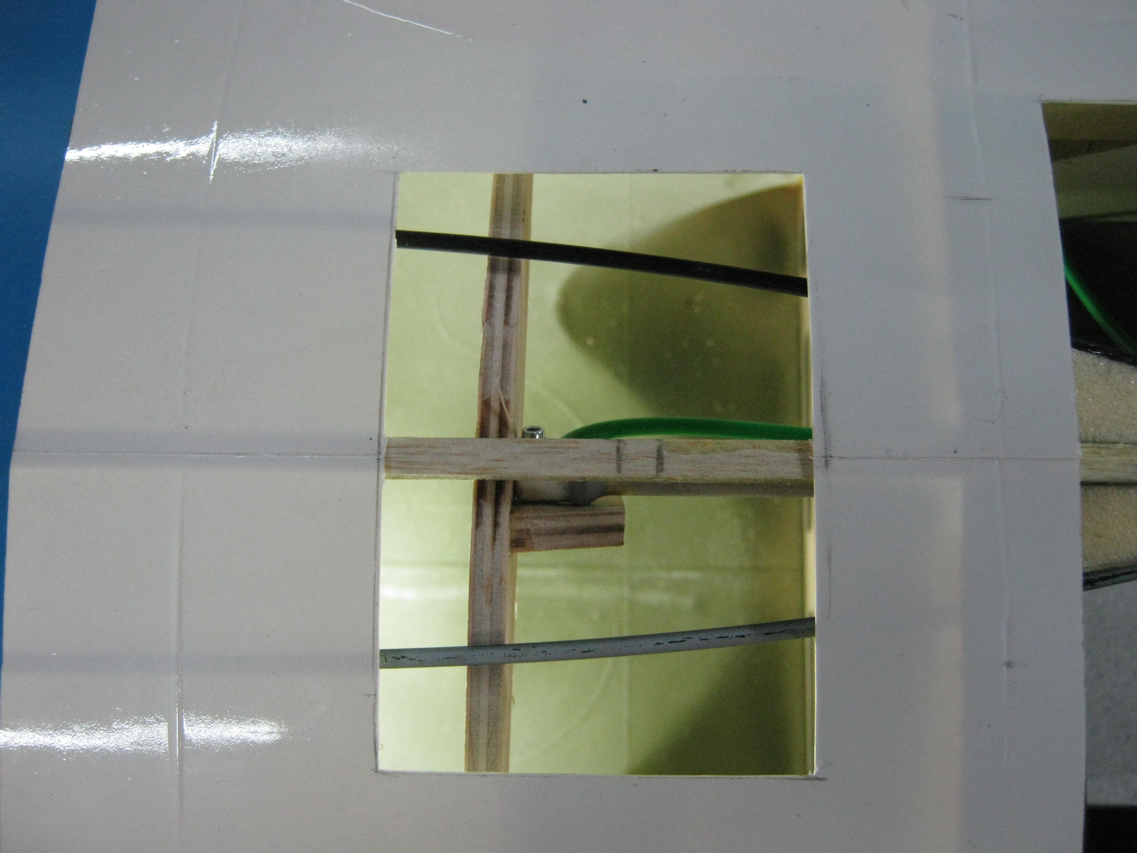

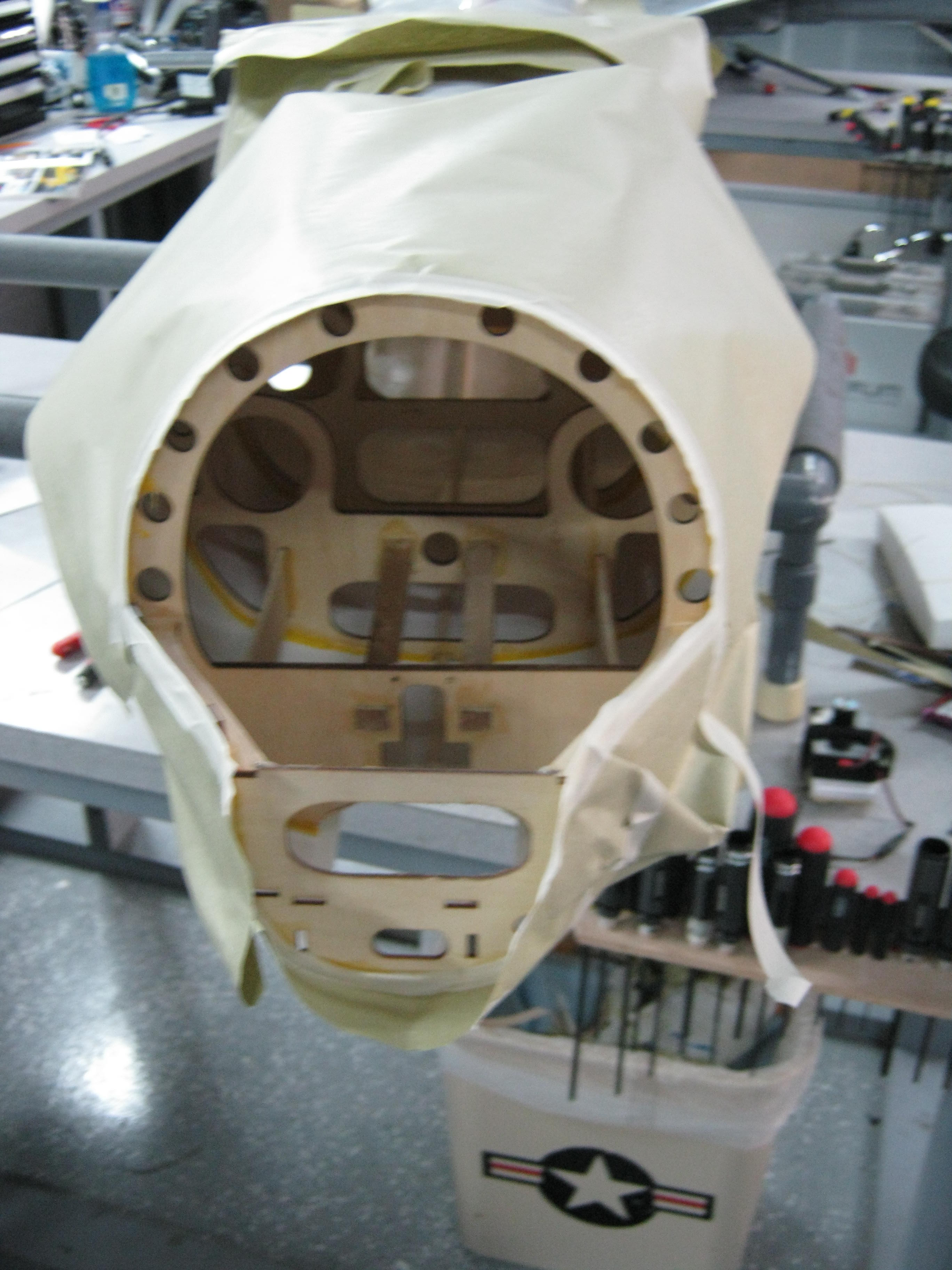

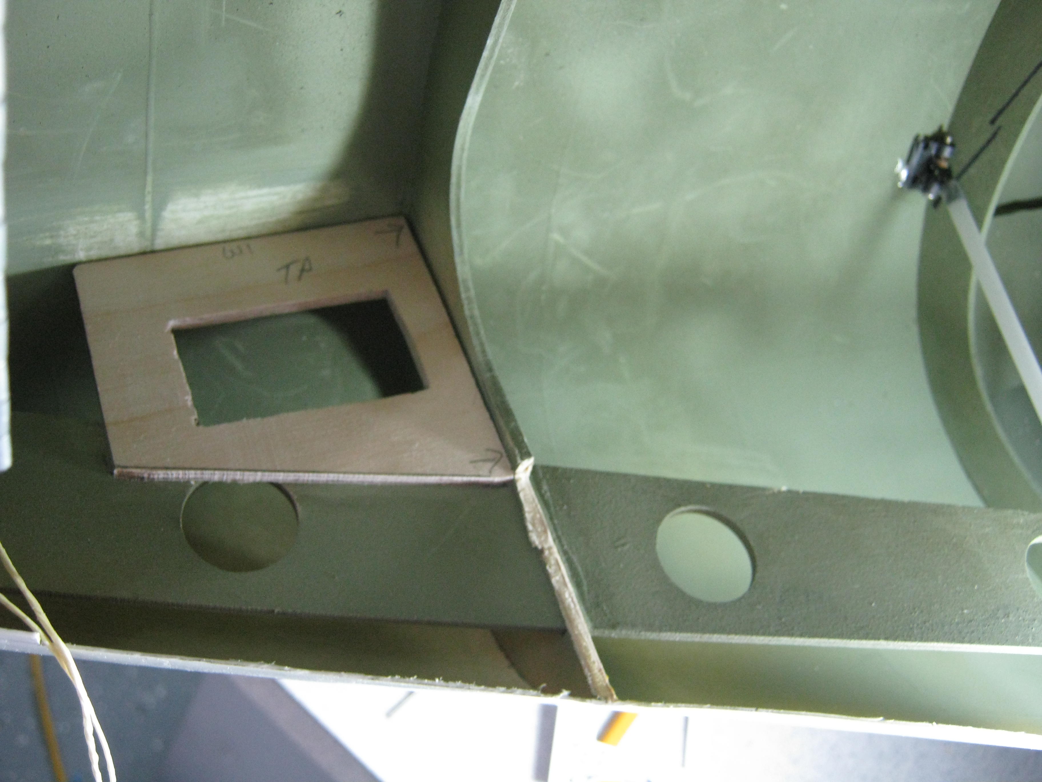

Here are some more pics of the starting job

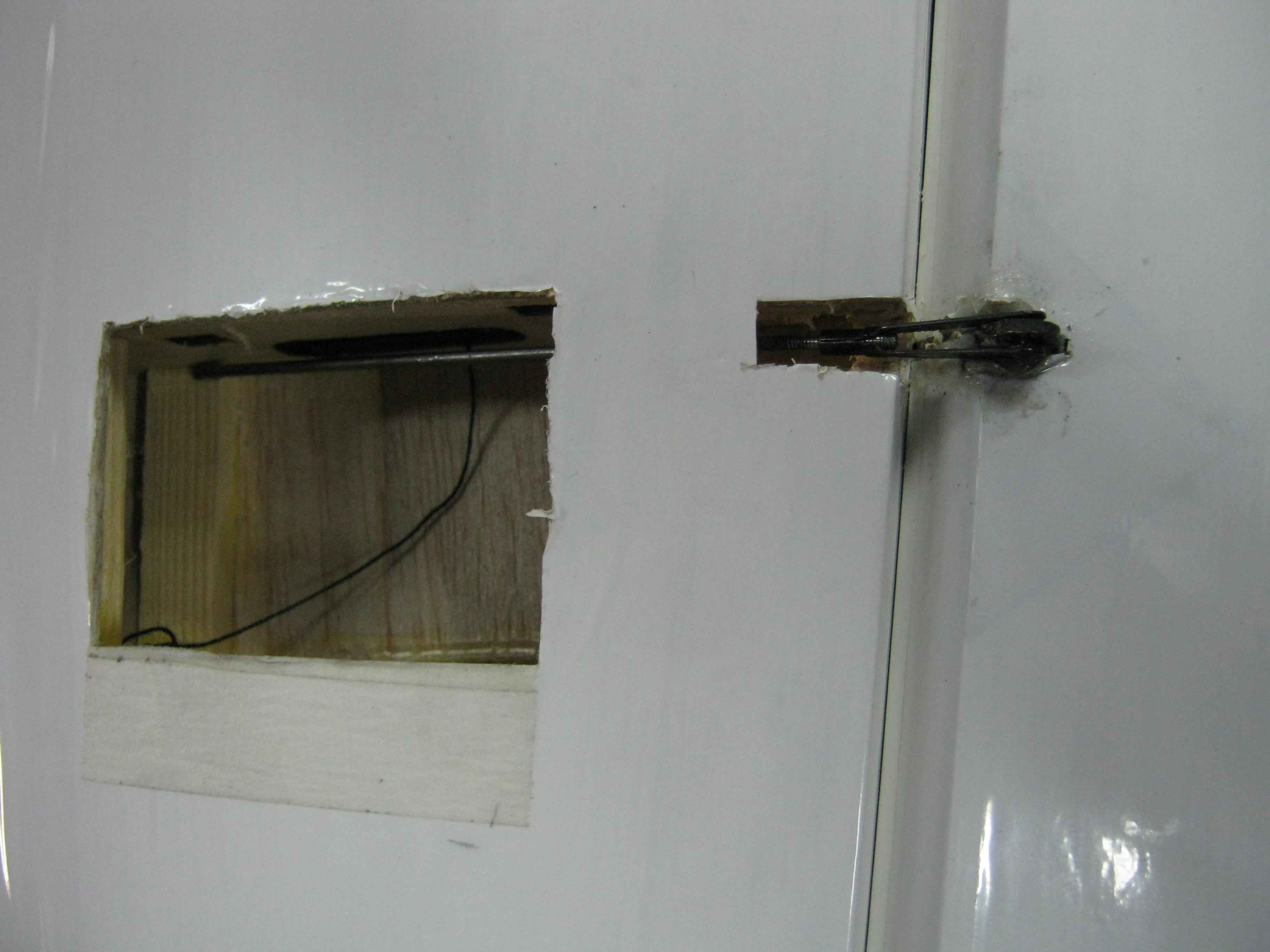

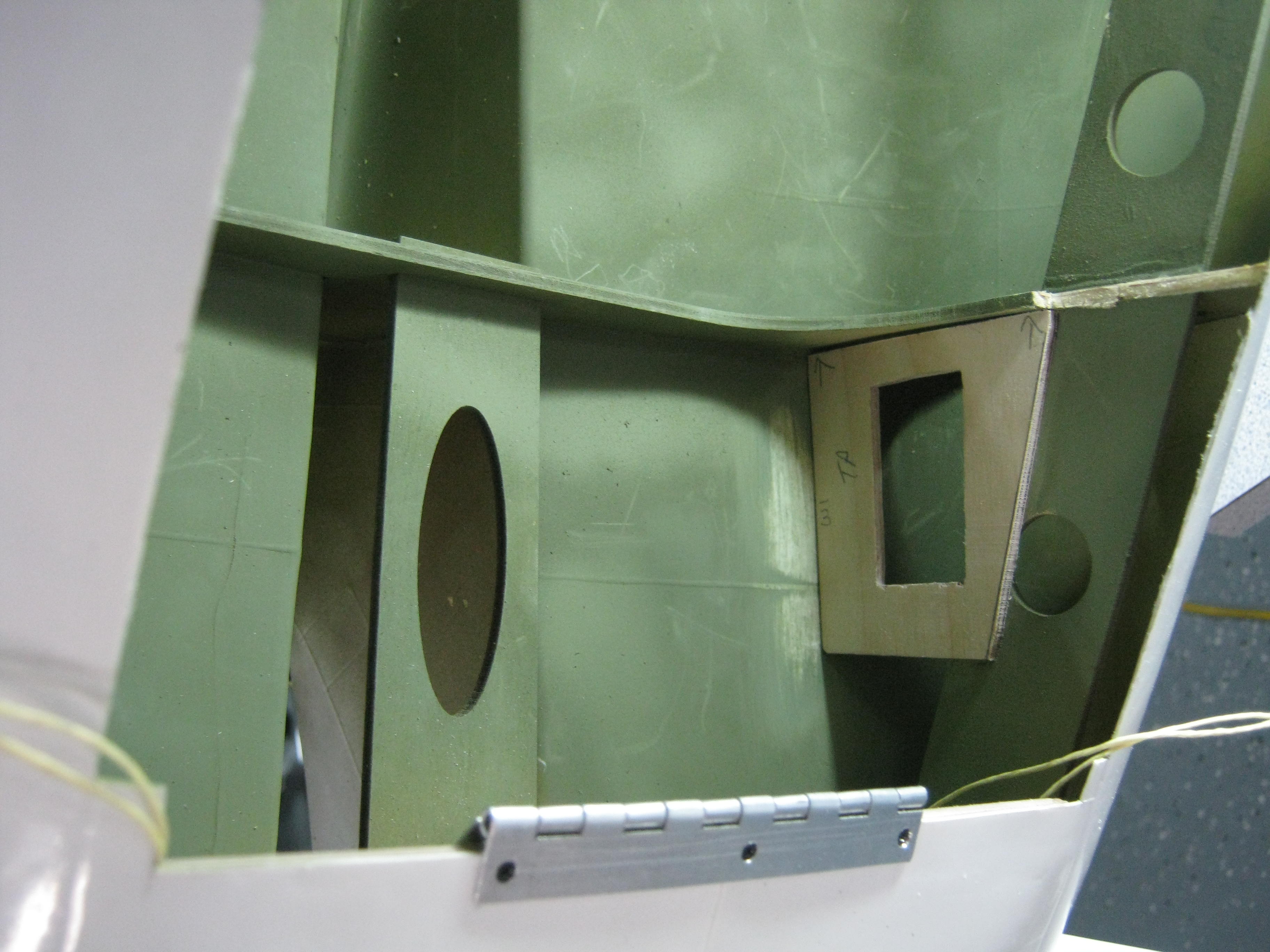

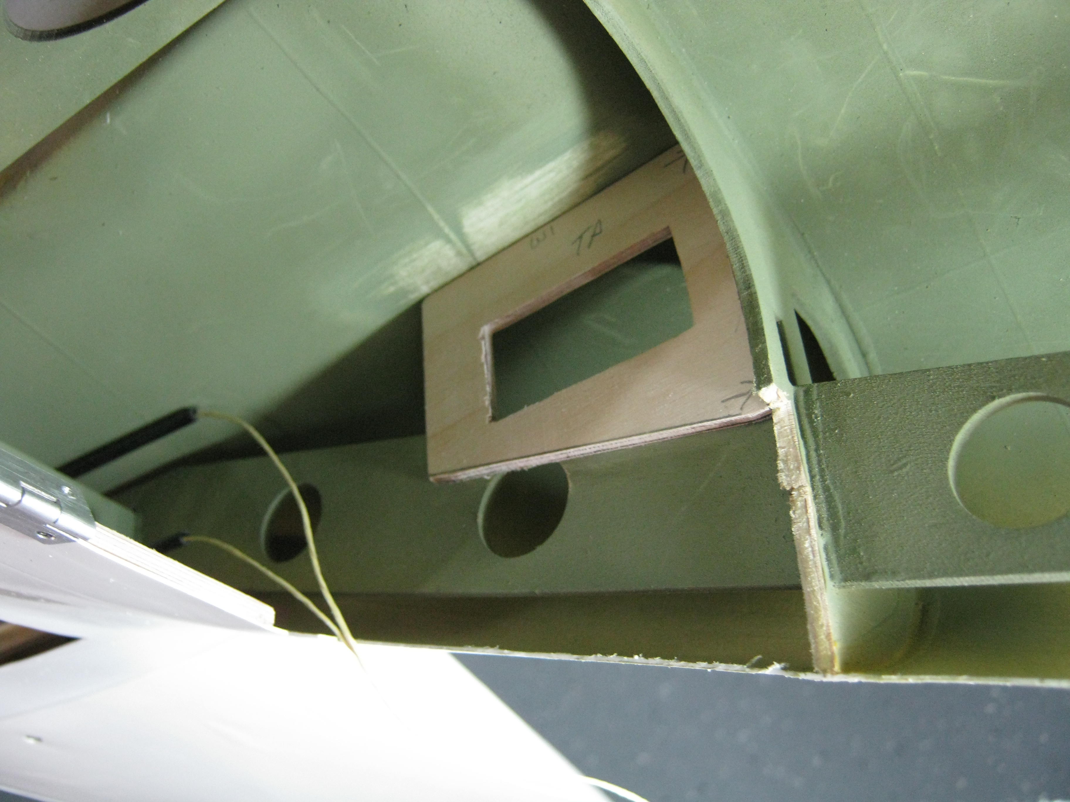

Old 08-24-2010 | 07:08 PM
Marvinf14's Avatar
Joined: Aug 2002
Posts: 689
From: Sunny/Hot/Muggy/Windy Miami, FL
Default RE: ASM C-130 101

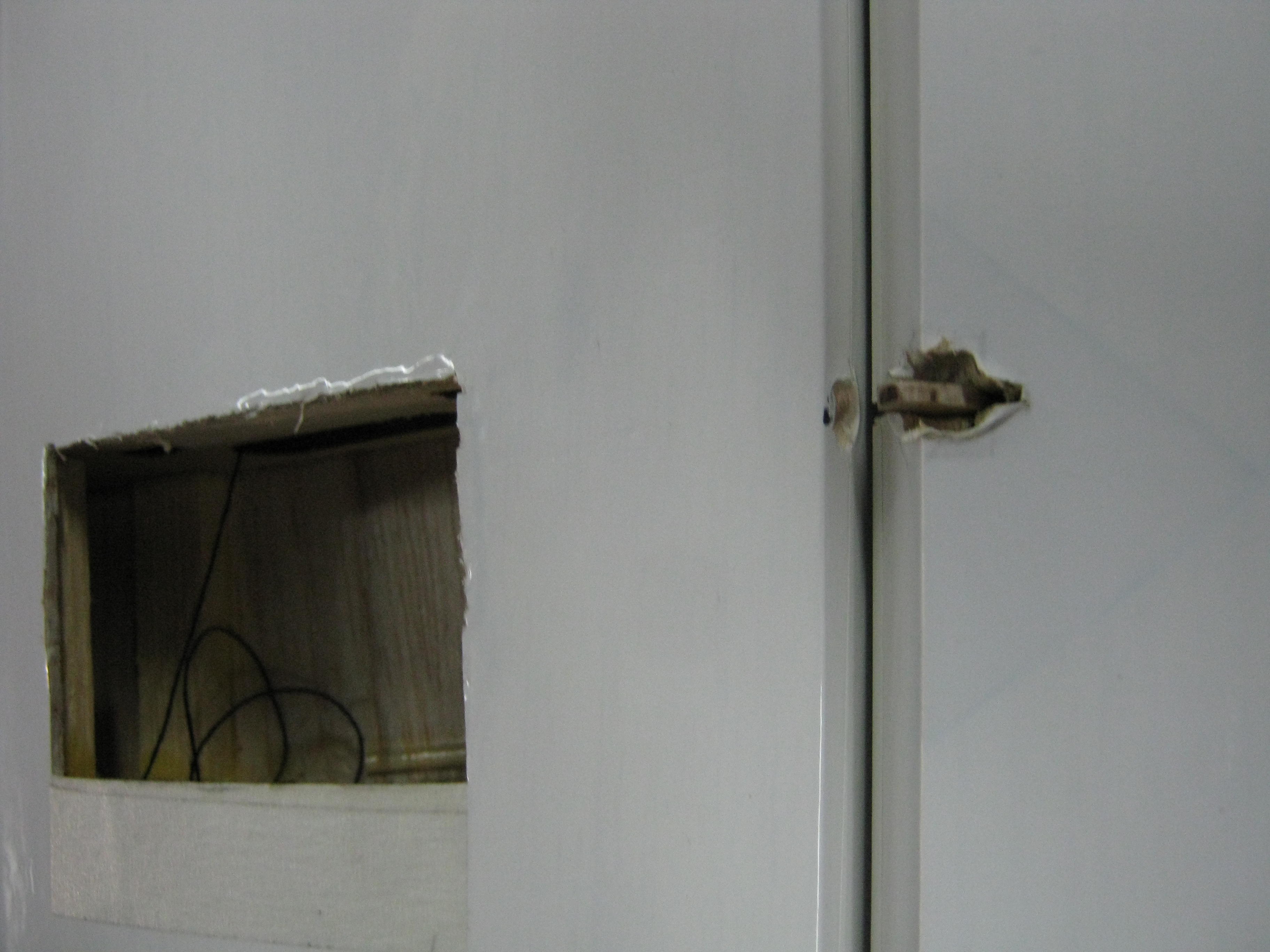

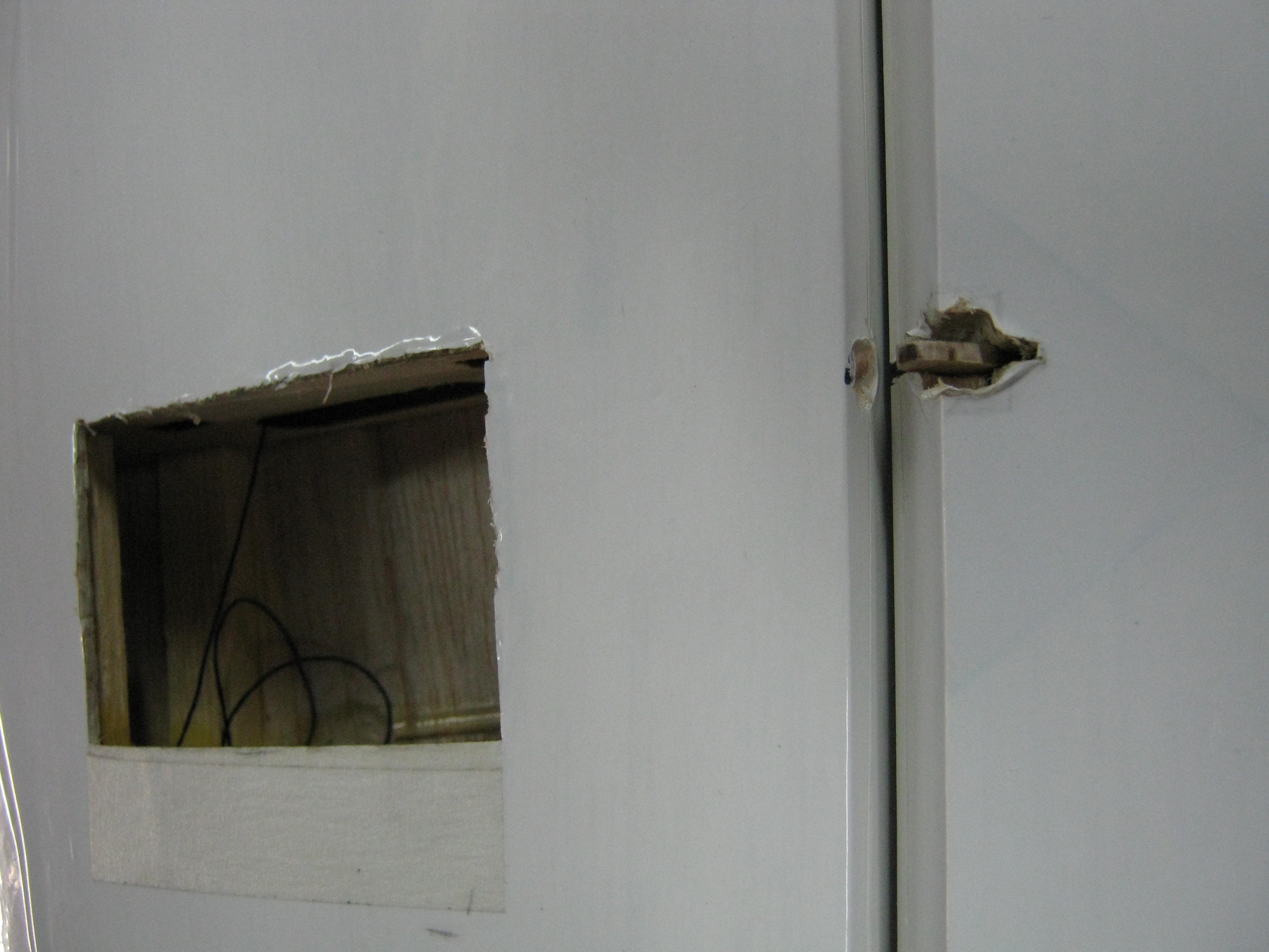

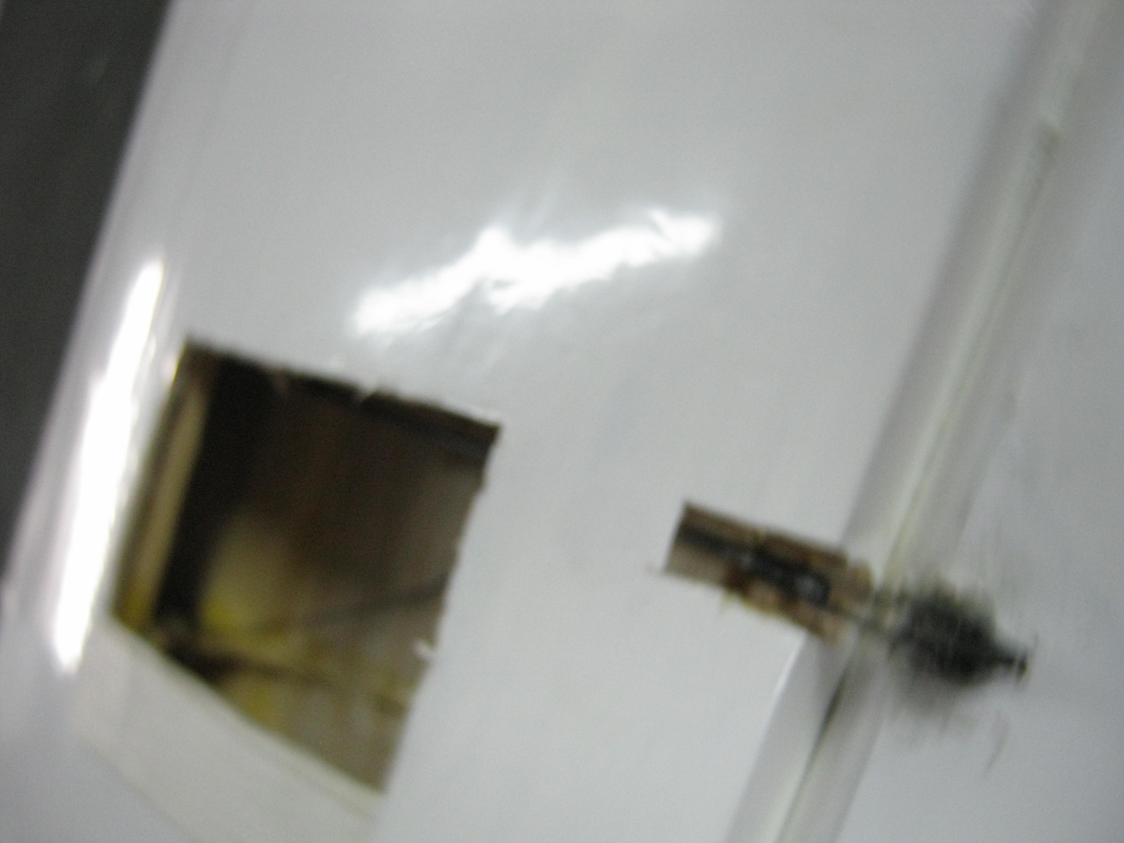

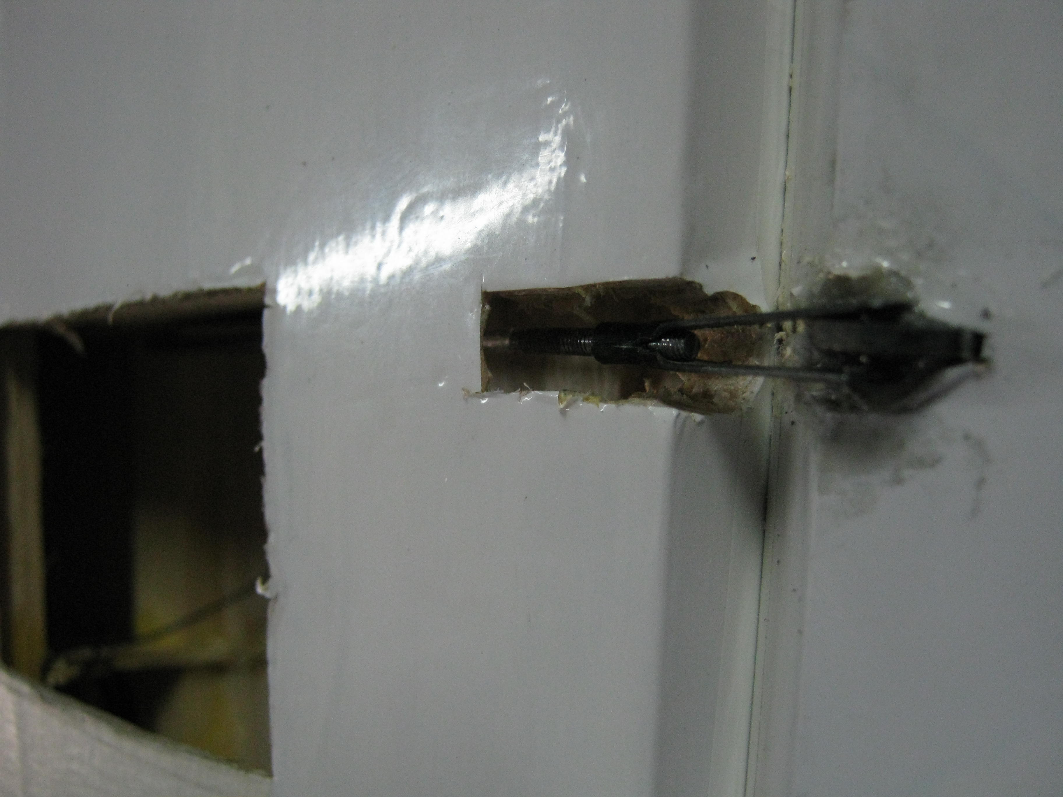

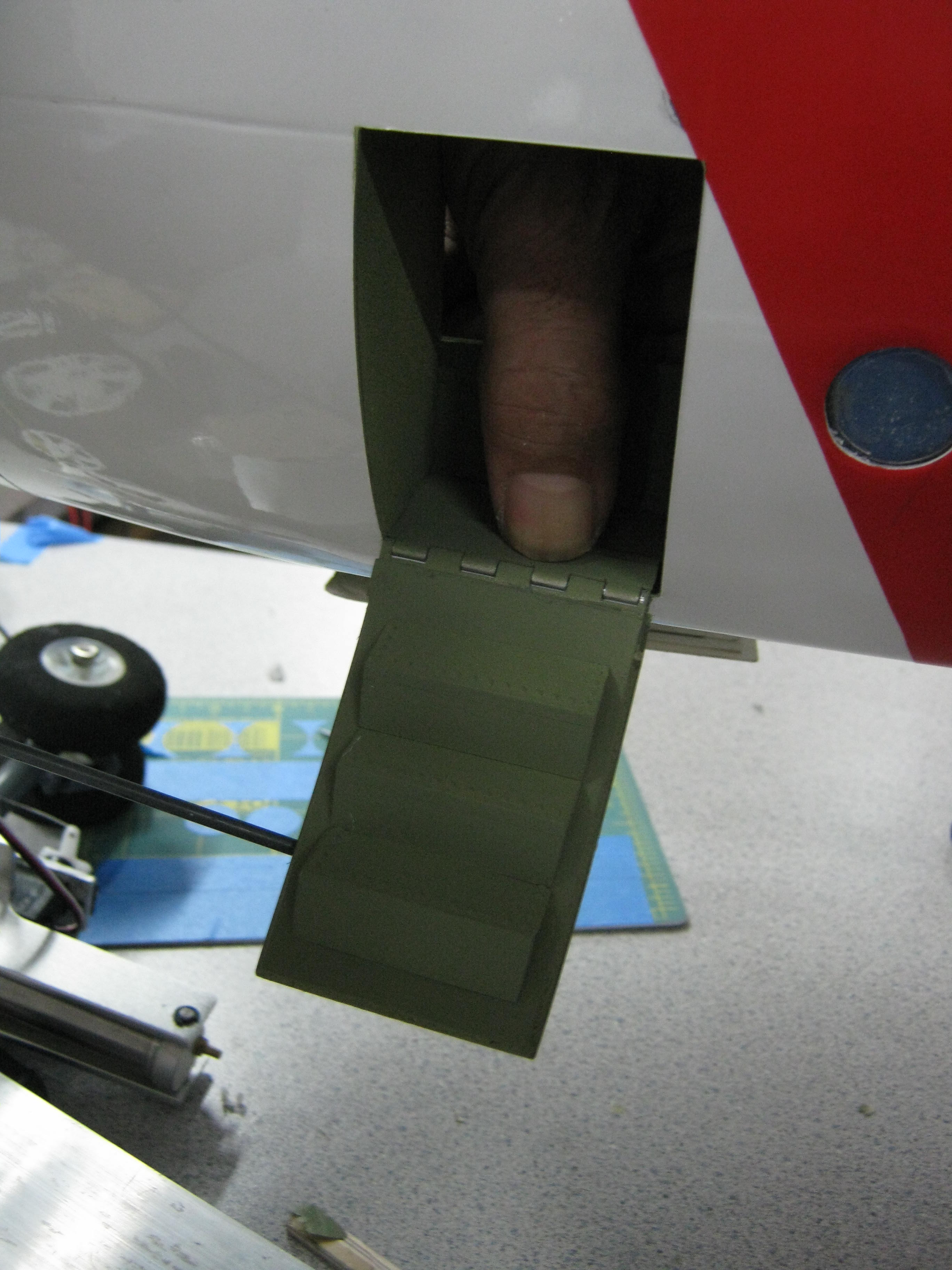

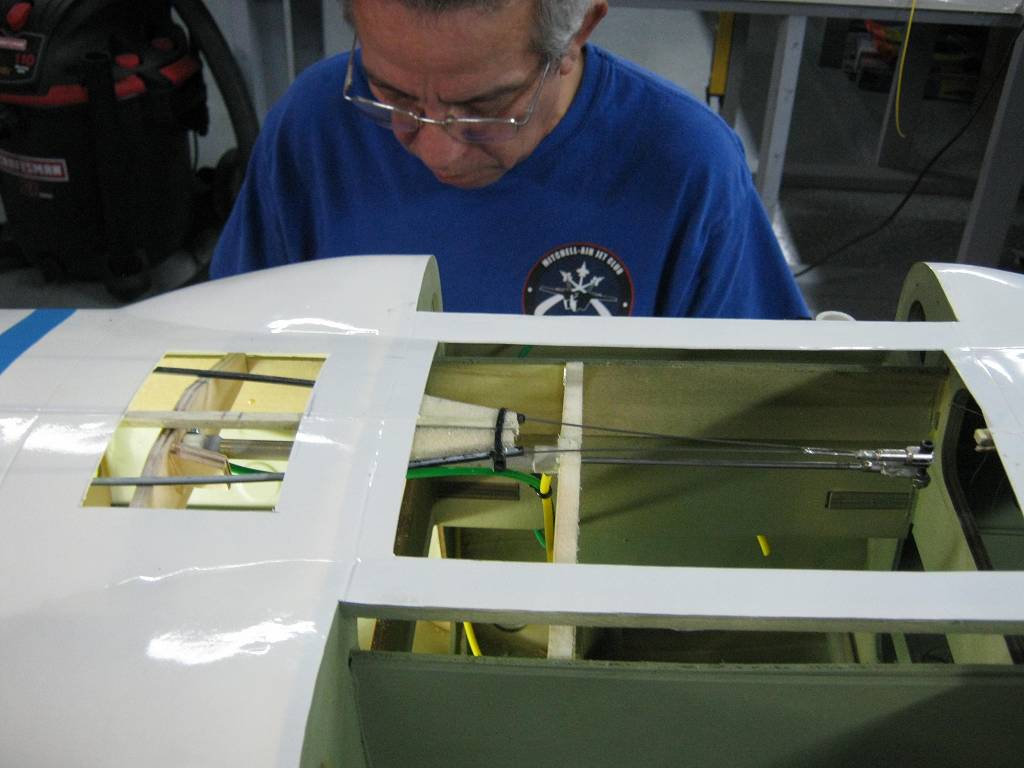

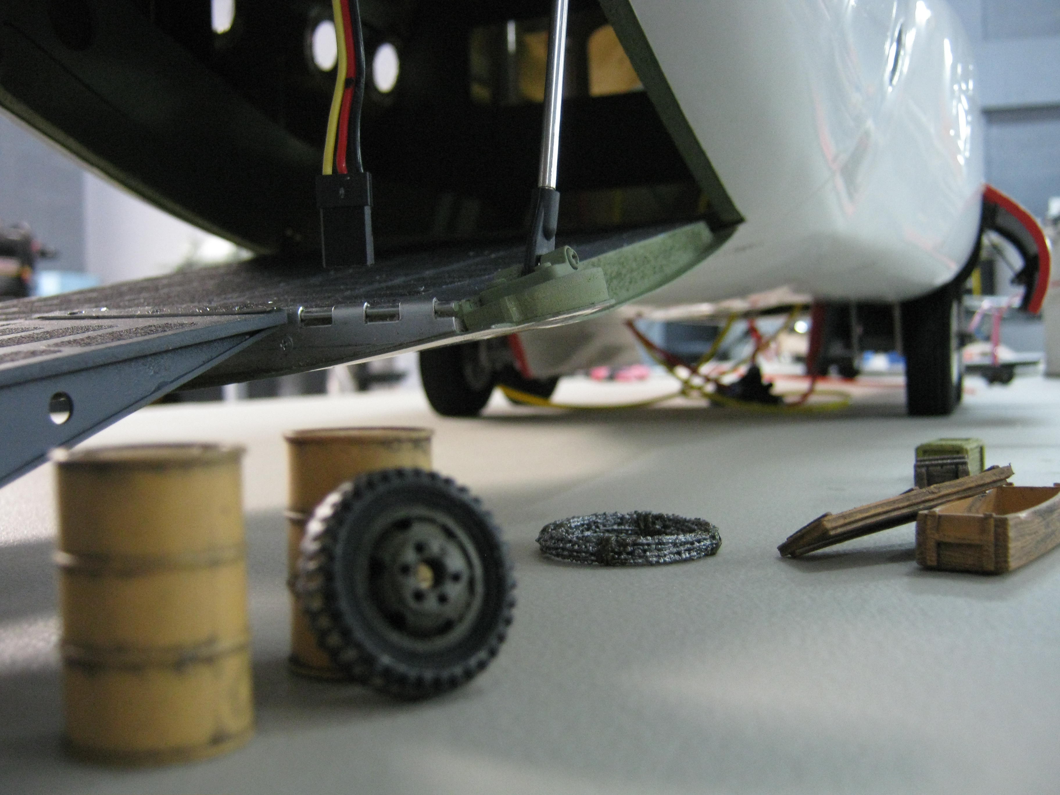

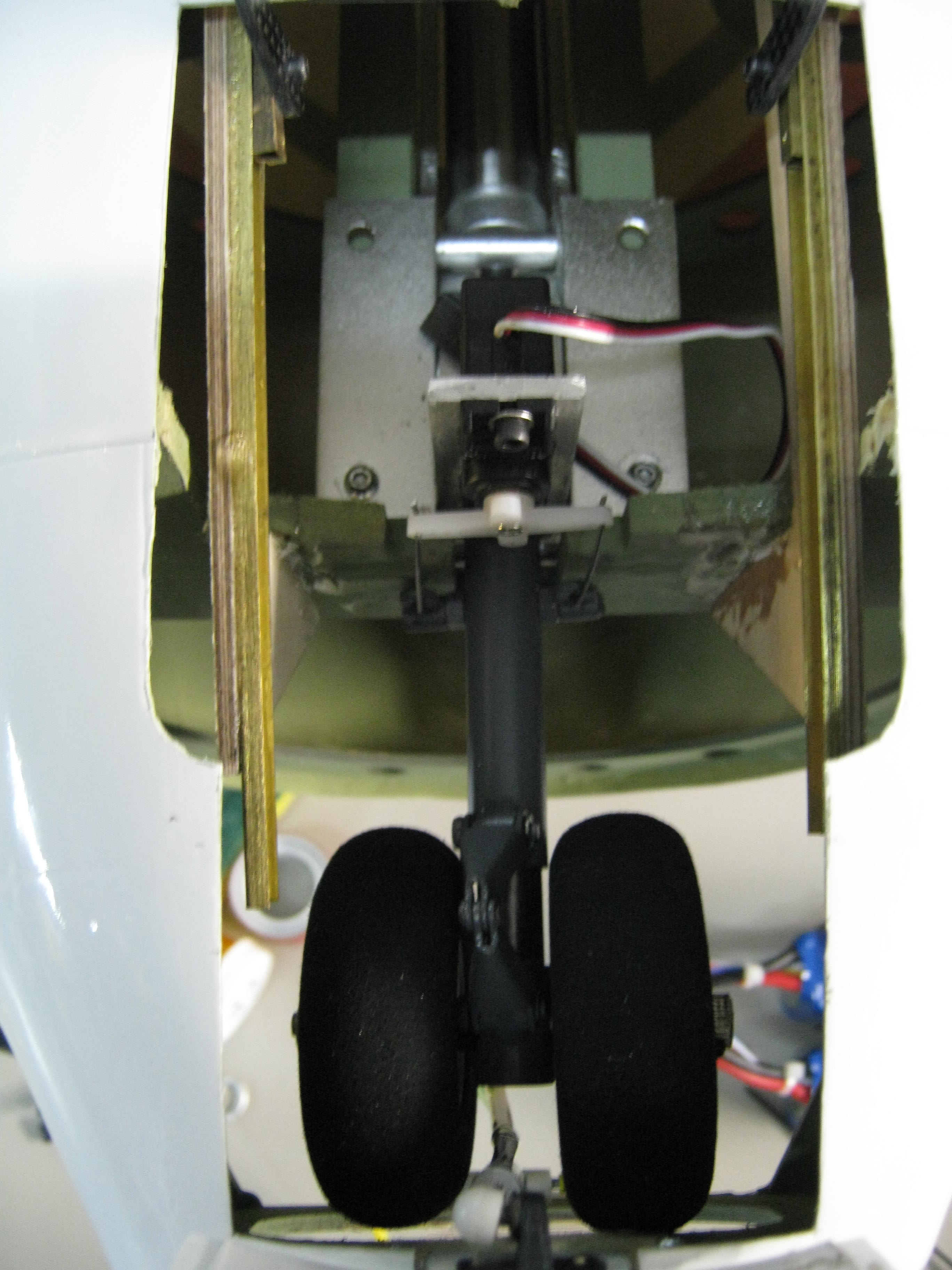

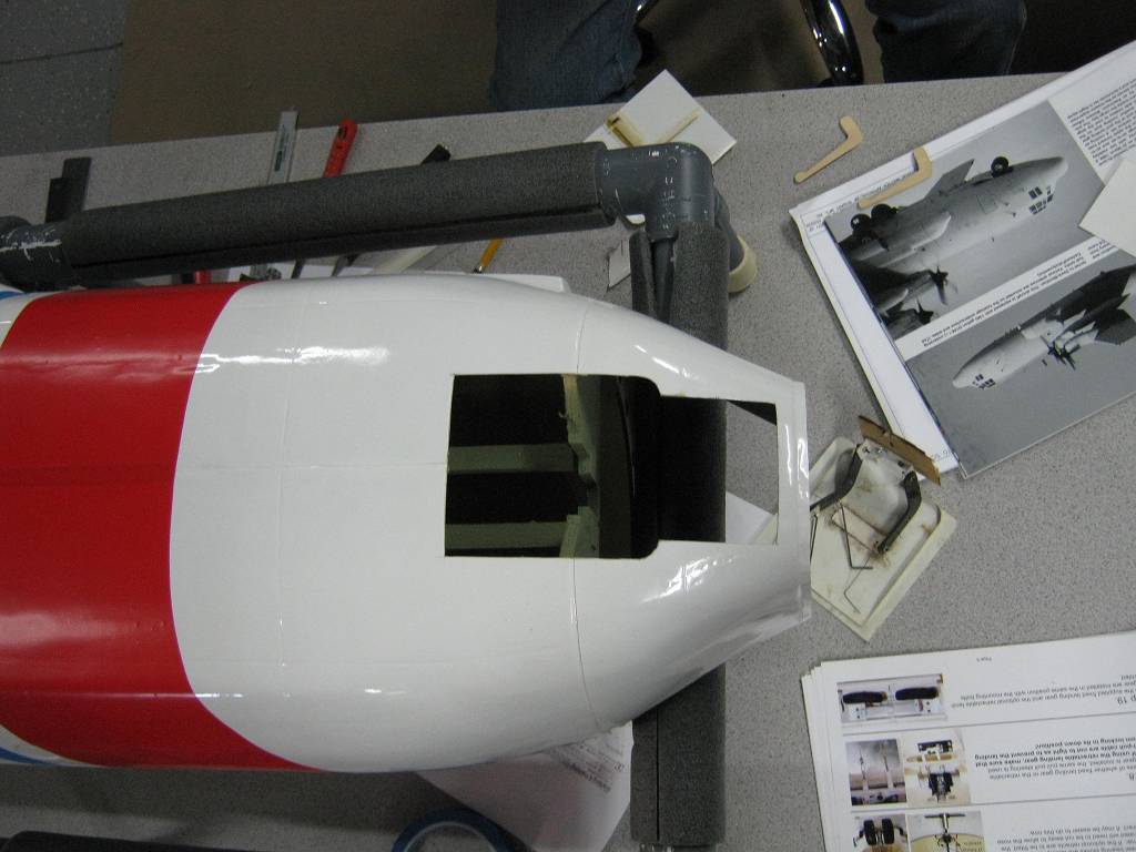

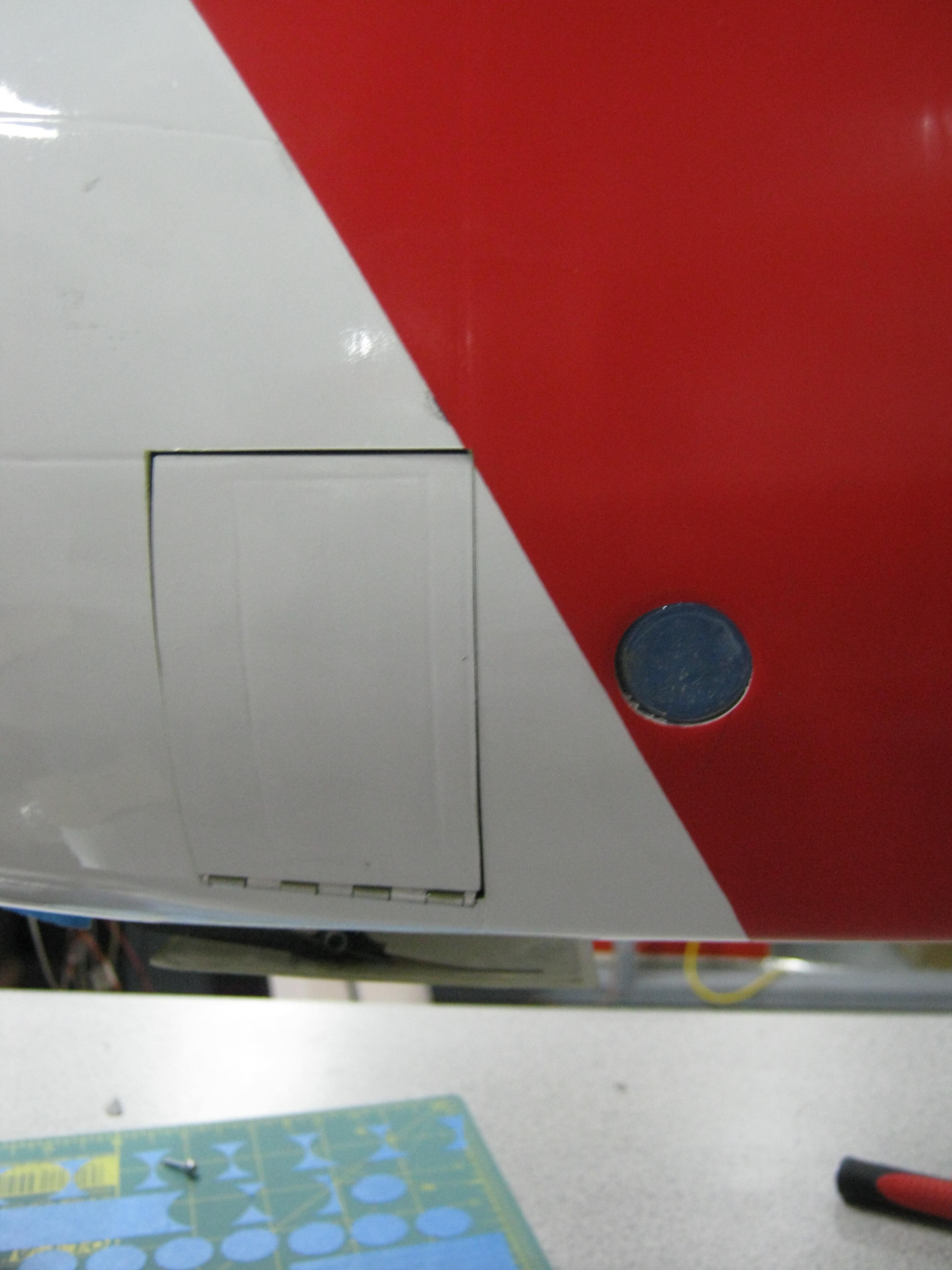

Working on the nose gear door

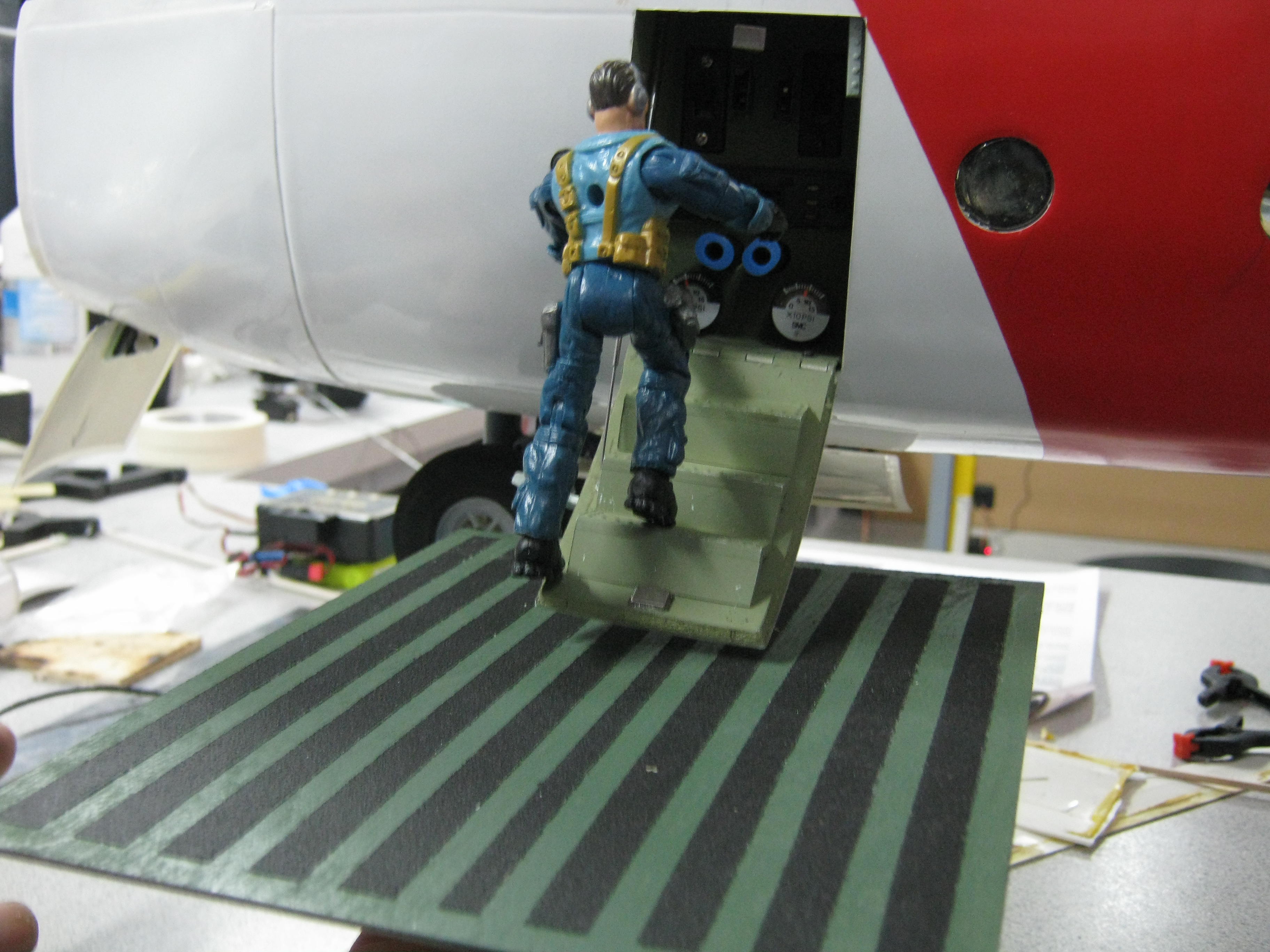

Old 08-24-2010 | 07:13 PM
Marvinf14's Avatar
Joined: Aug 2002
Posts: 689

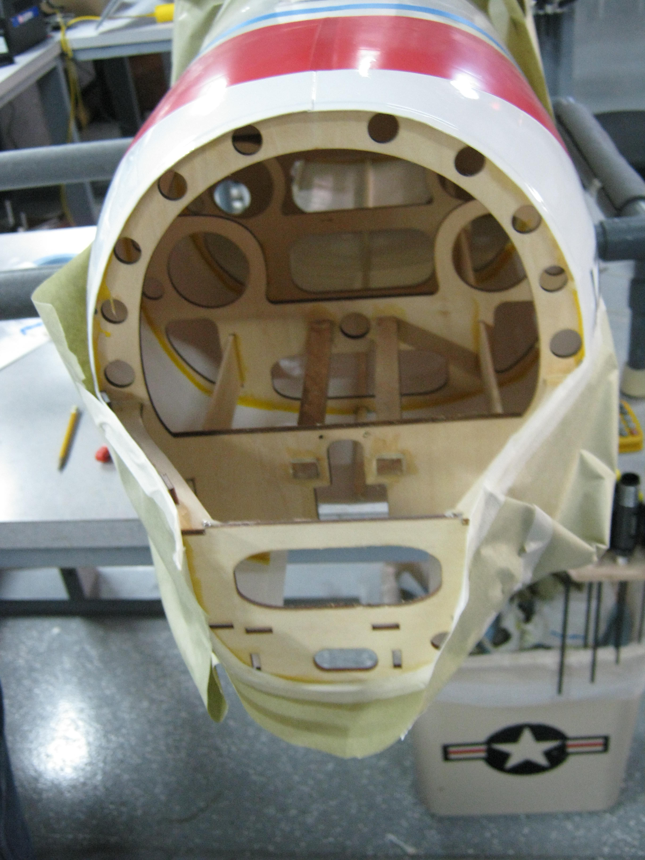

Some more of the nose gear door work

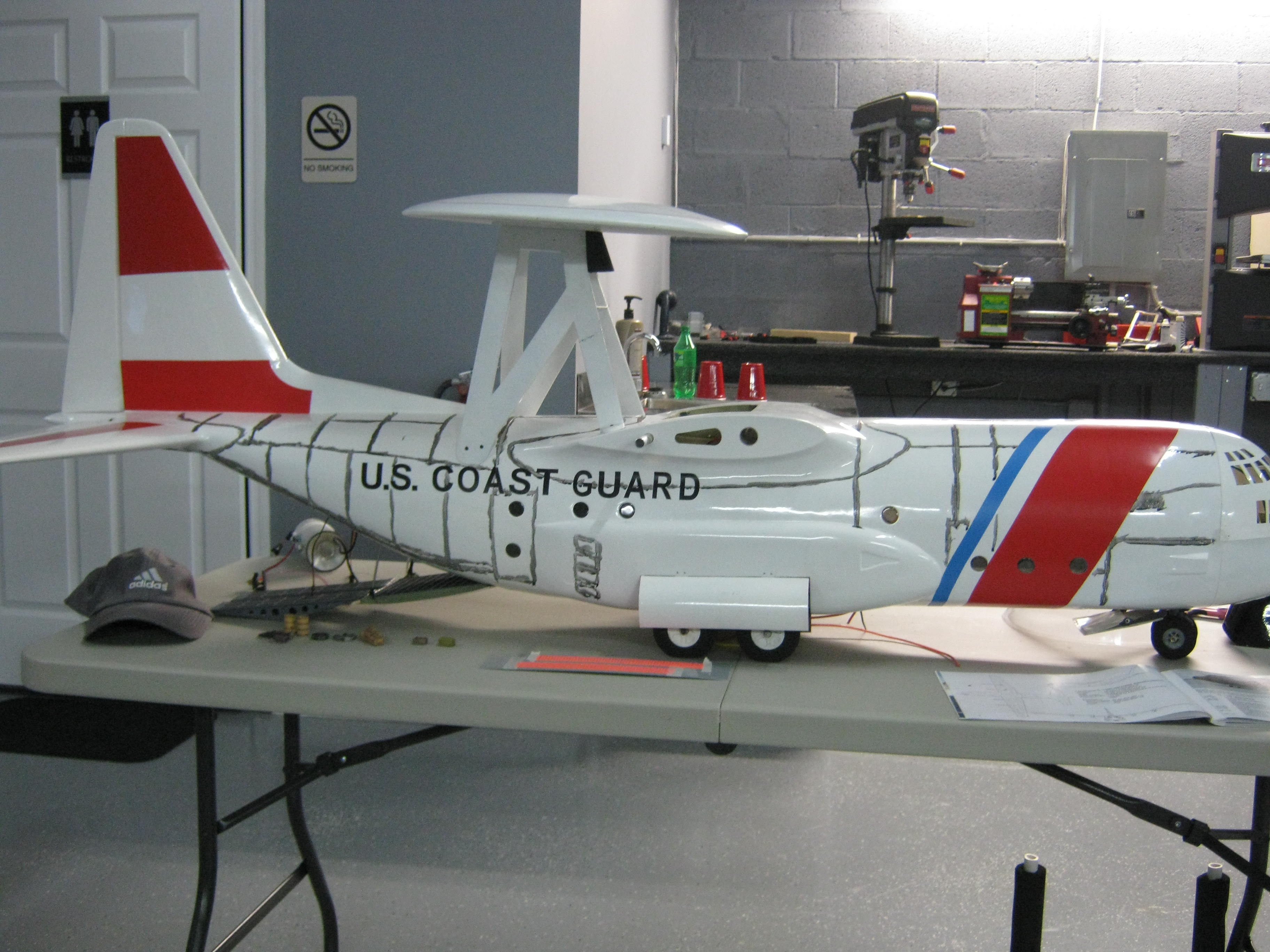

Some more pics

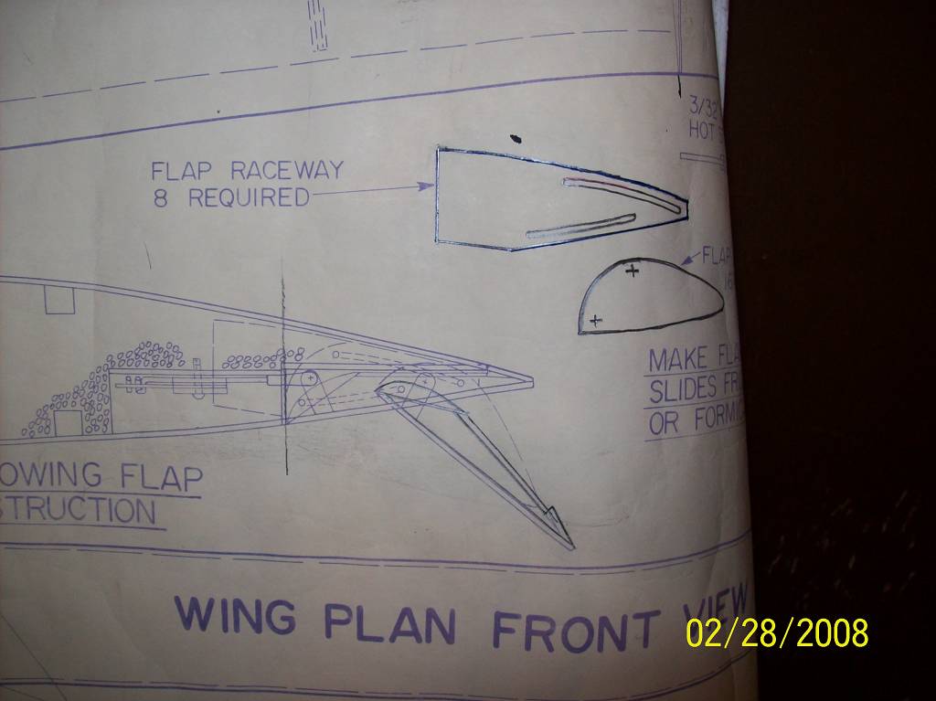

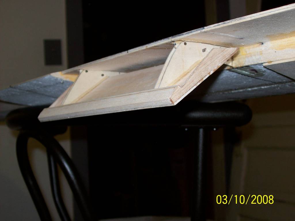

Hey Marvin,

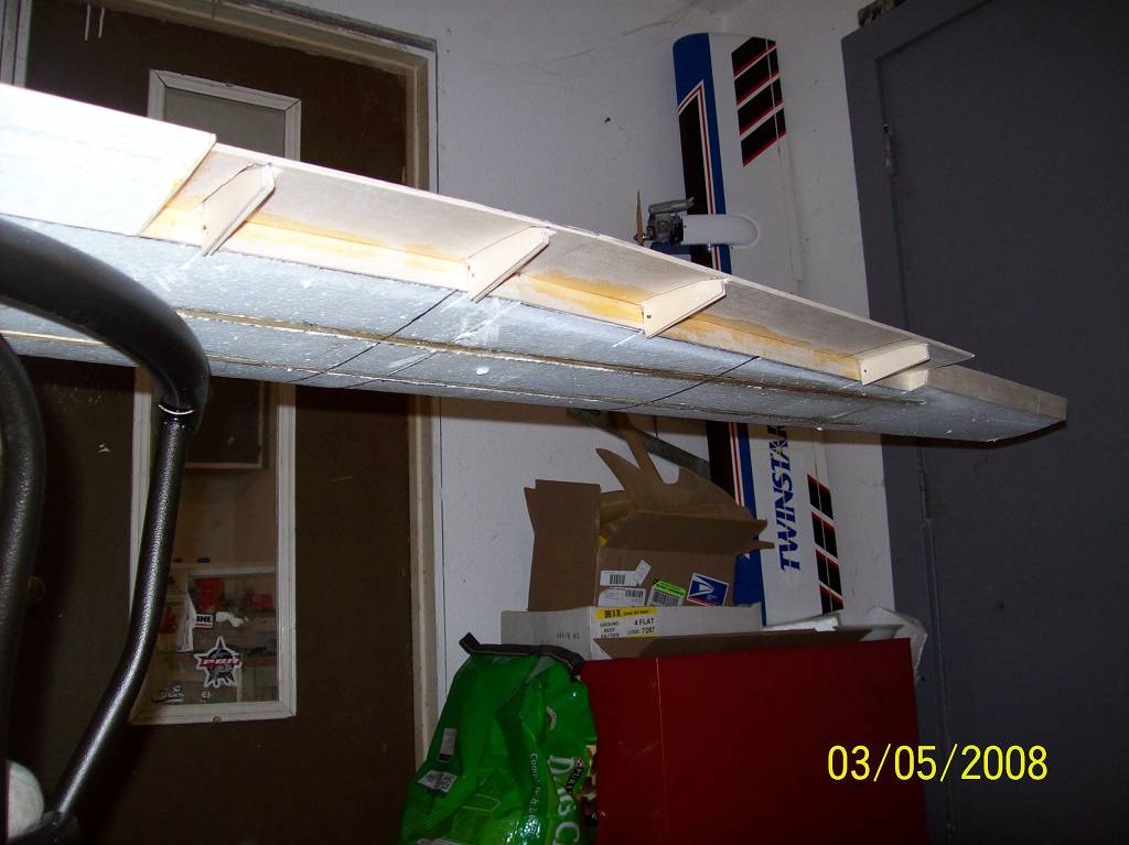

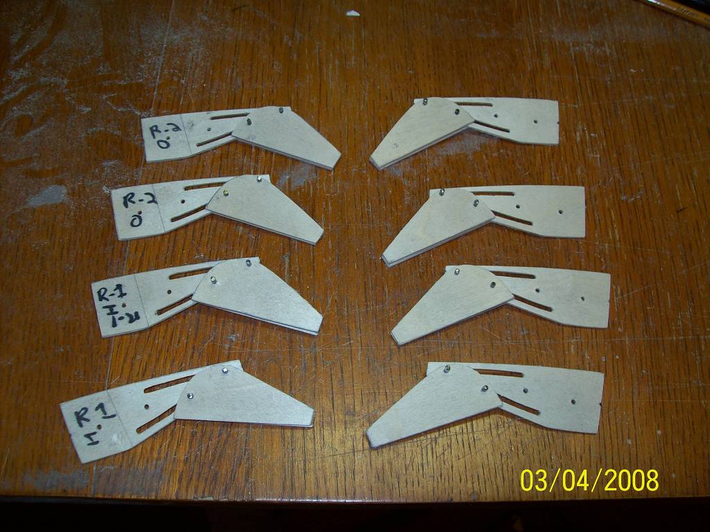

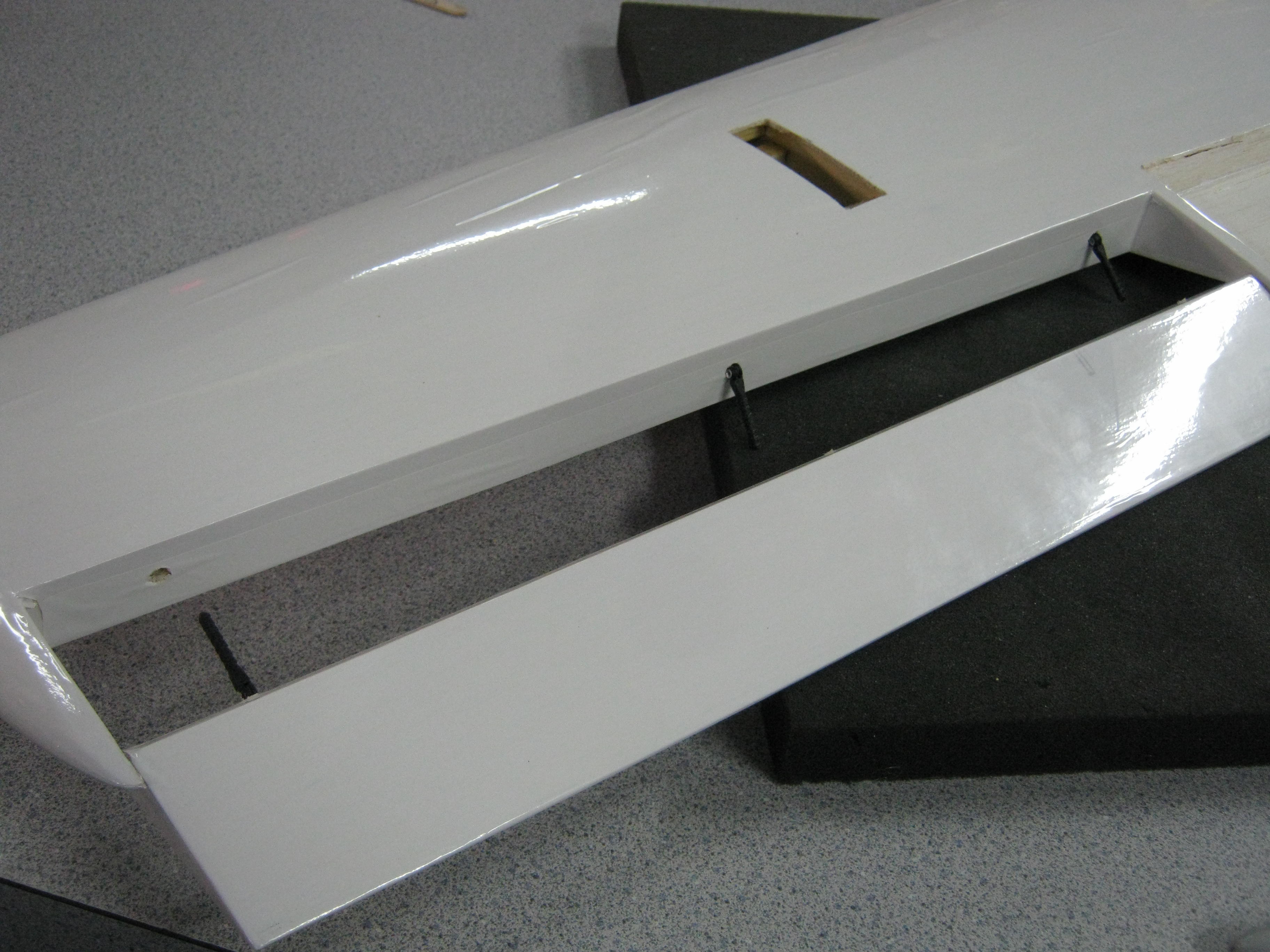

Got some ideas for the fowler flaps. I have a set of the C-130 Plans that was designed by Skip Mast. I looked at the flap slides for that
airplane. In fact i found my pictures when i built the flaps for my Quality Fiberglass C-130 and Im sure they will work on the ASM C-130 with some modifications . i got spare wings for the ASM C-130 so i just might give it a try. tried to upload some pics but having problems. Also i noticed on your main gear your using the stock spring. I modified mine with brackets i got from Troy. they work excellent with no bending and the gear doors are closed with small springs. Ill try again later to upload pics.
Jerry.

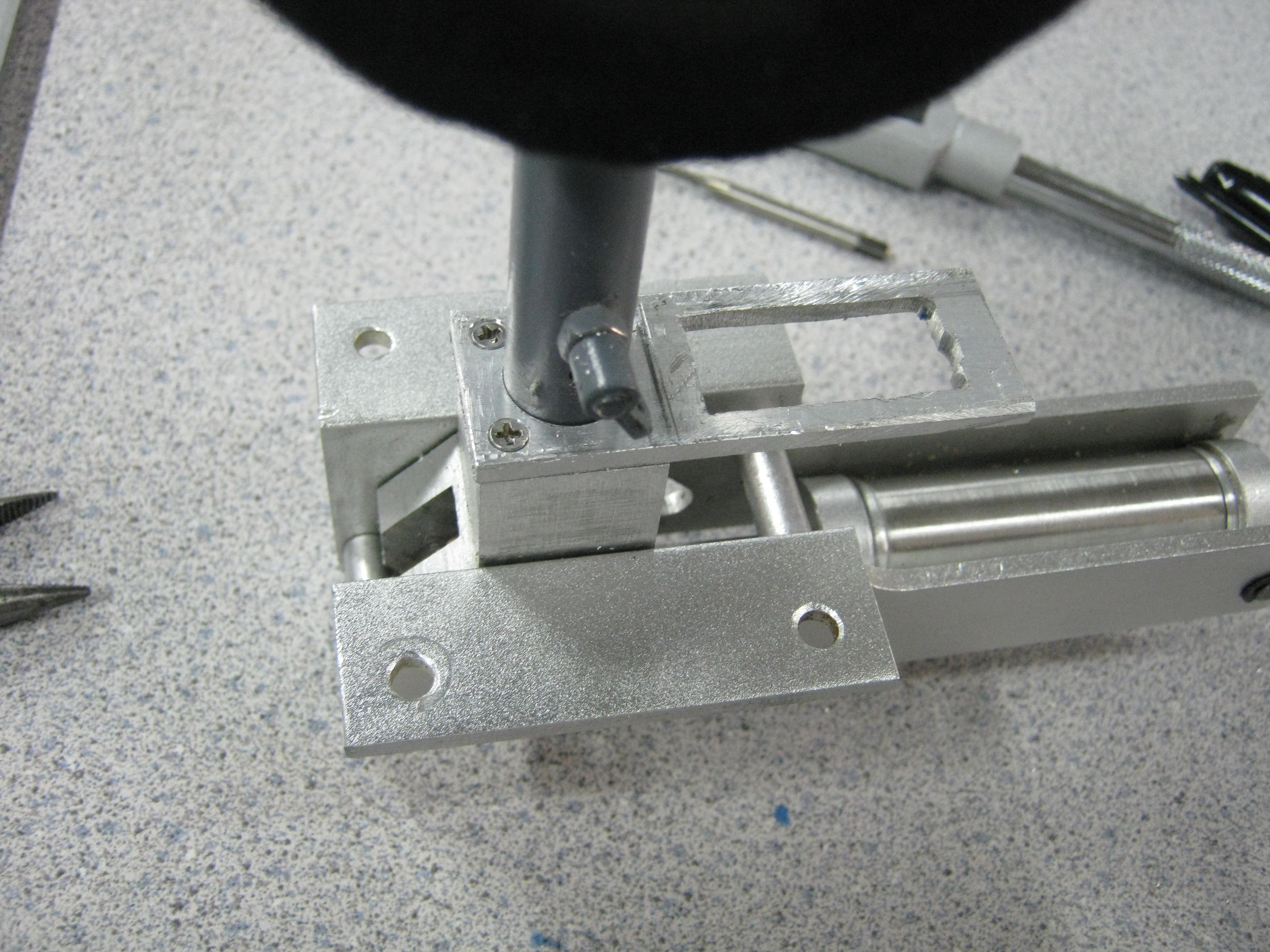

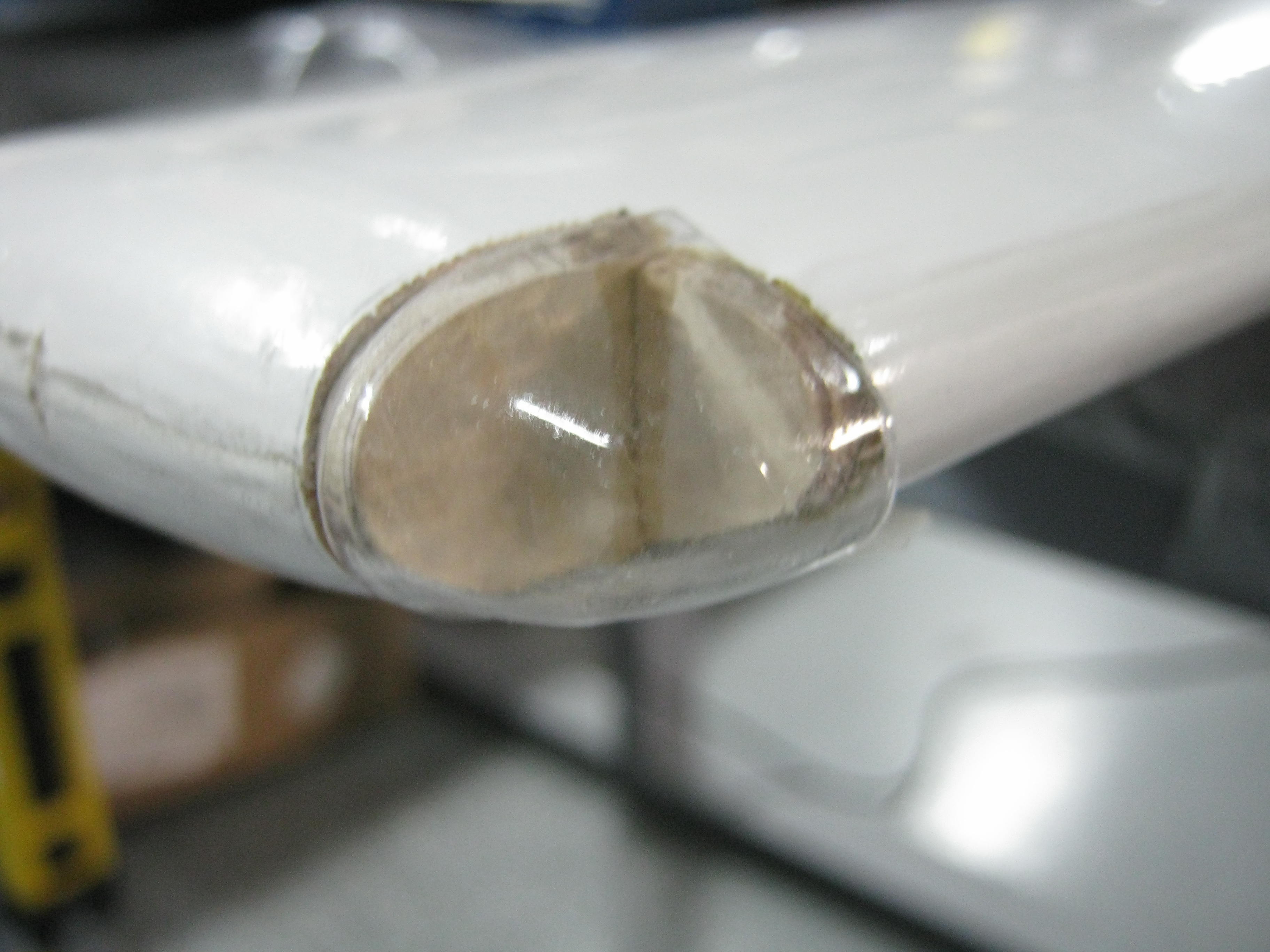

Old 09-05-2010 | 04:27 PM
Marvinf14's Avatar
Joined: Aug 2002
Posts: 689

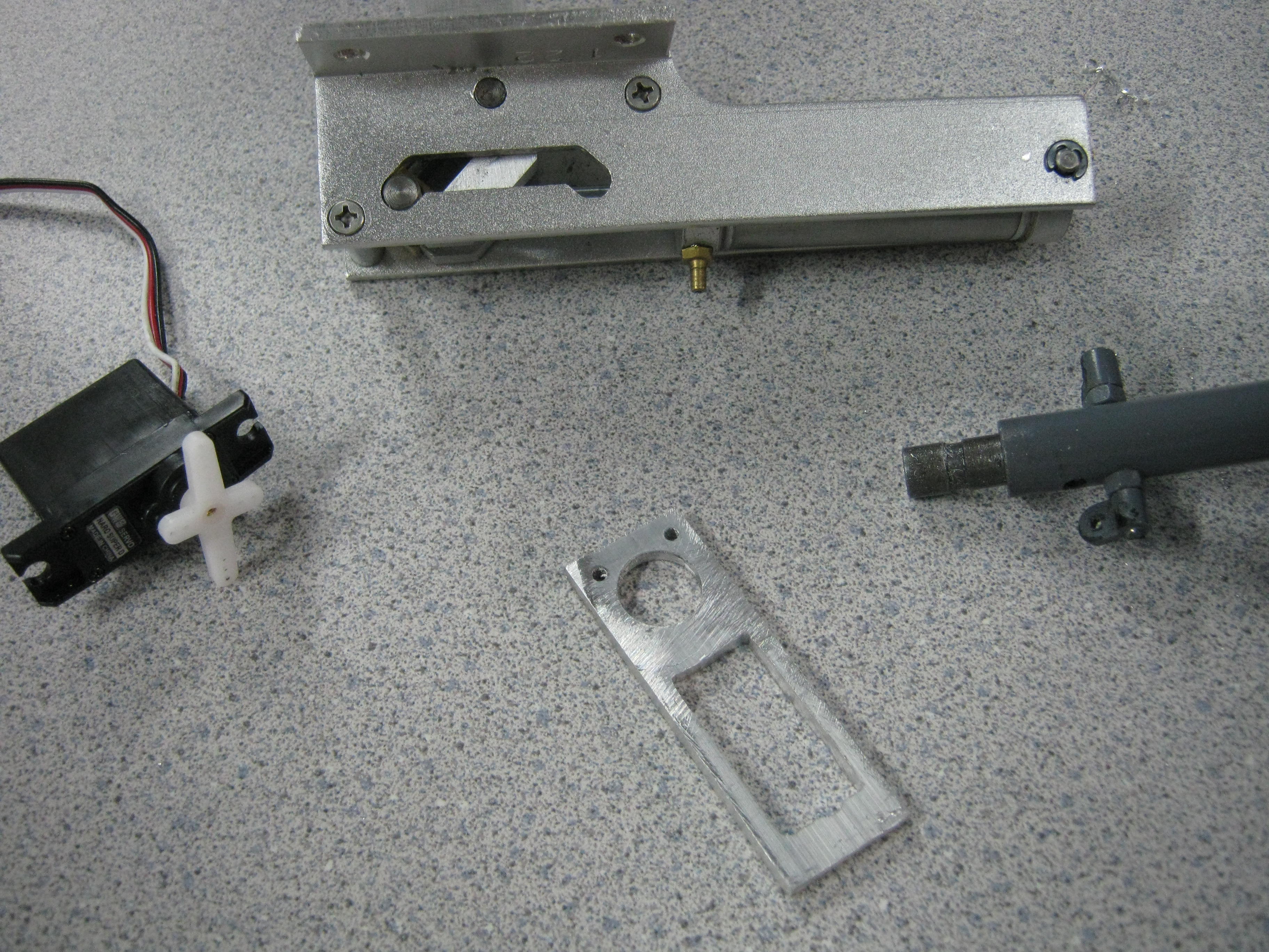

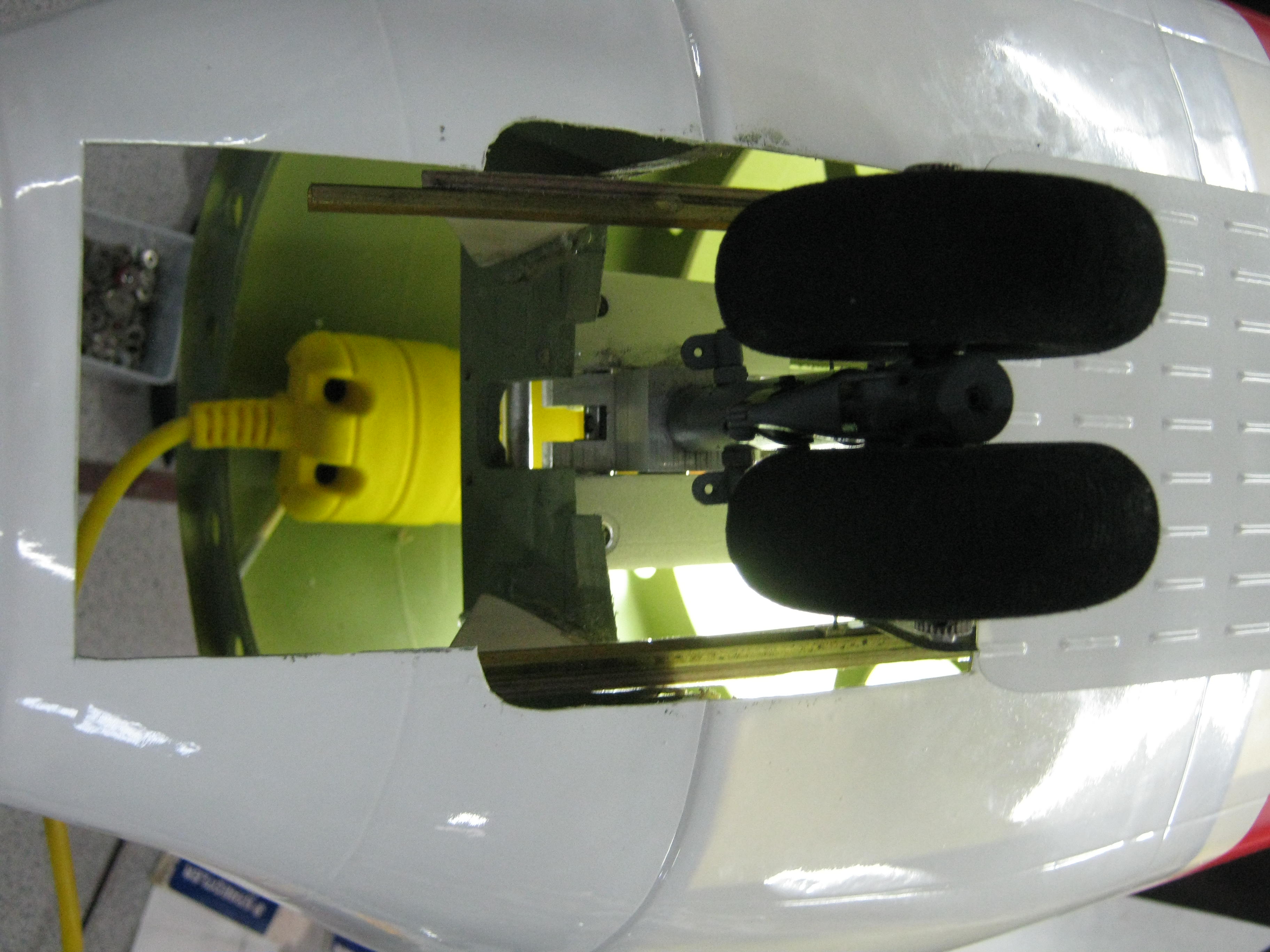

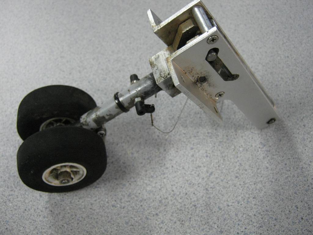

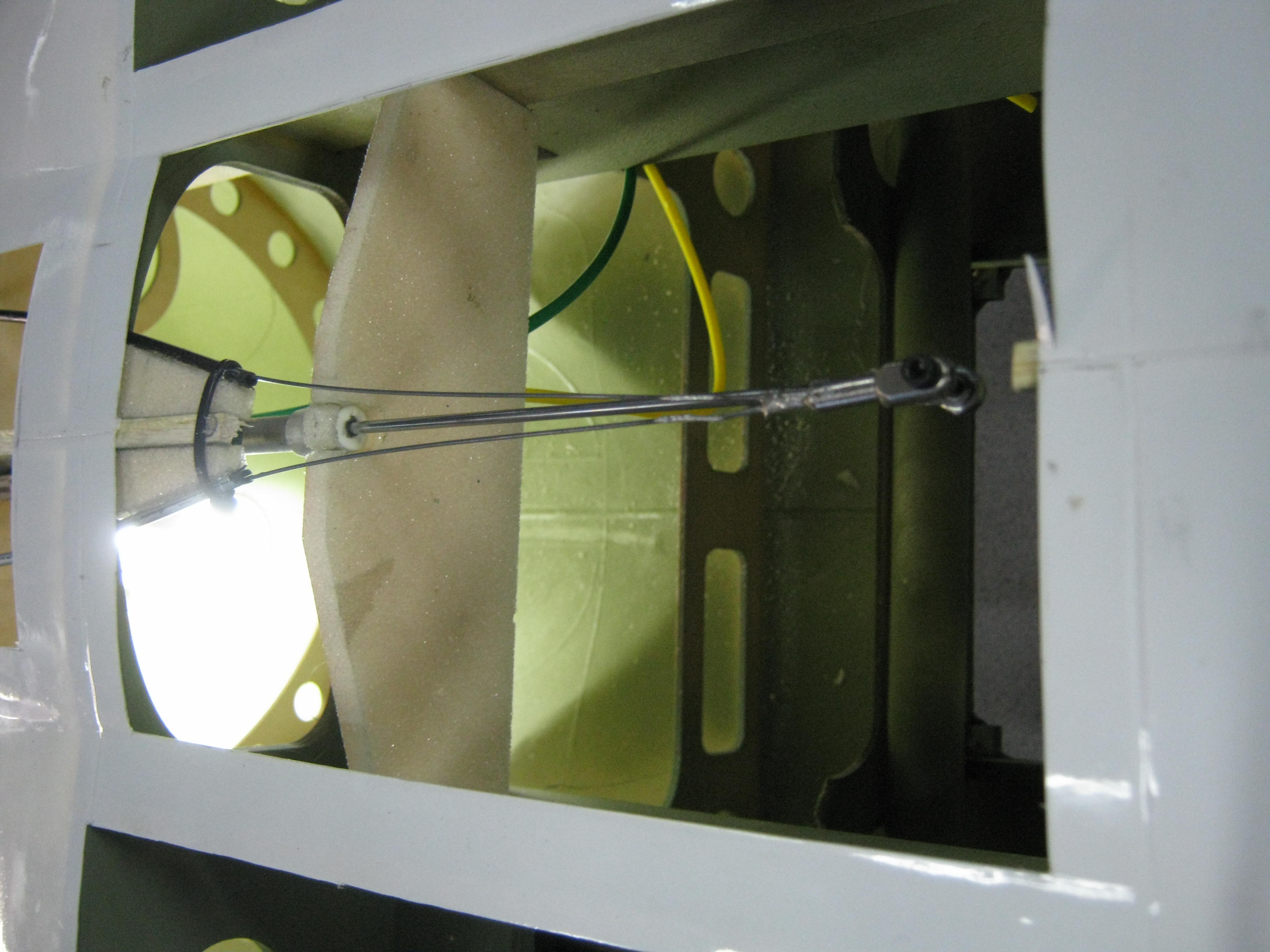

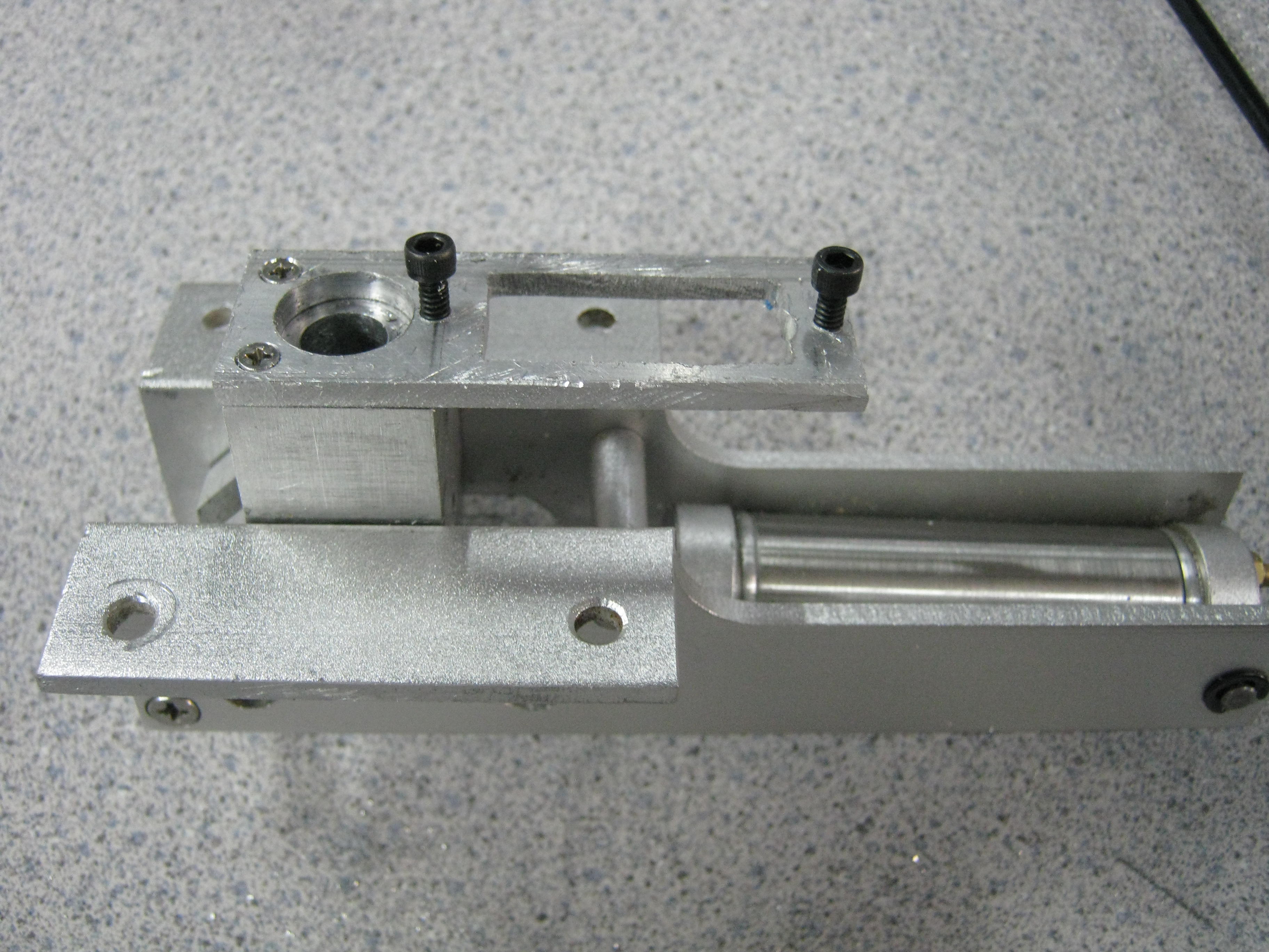

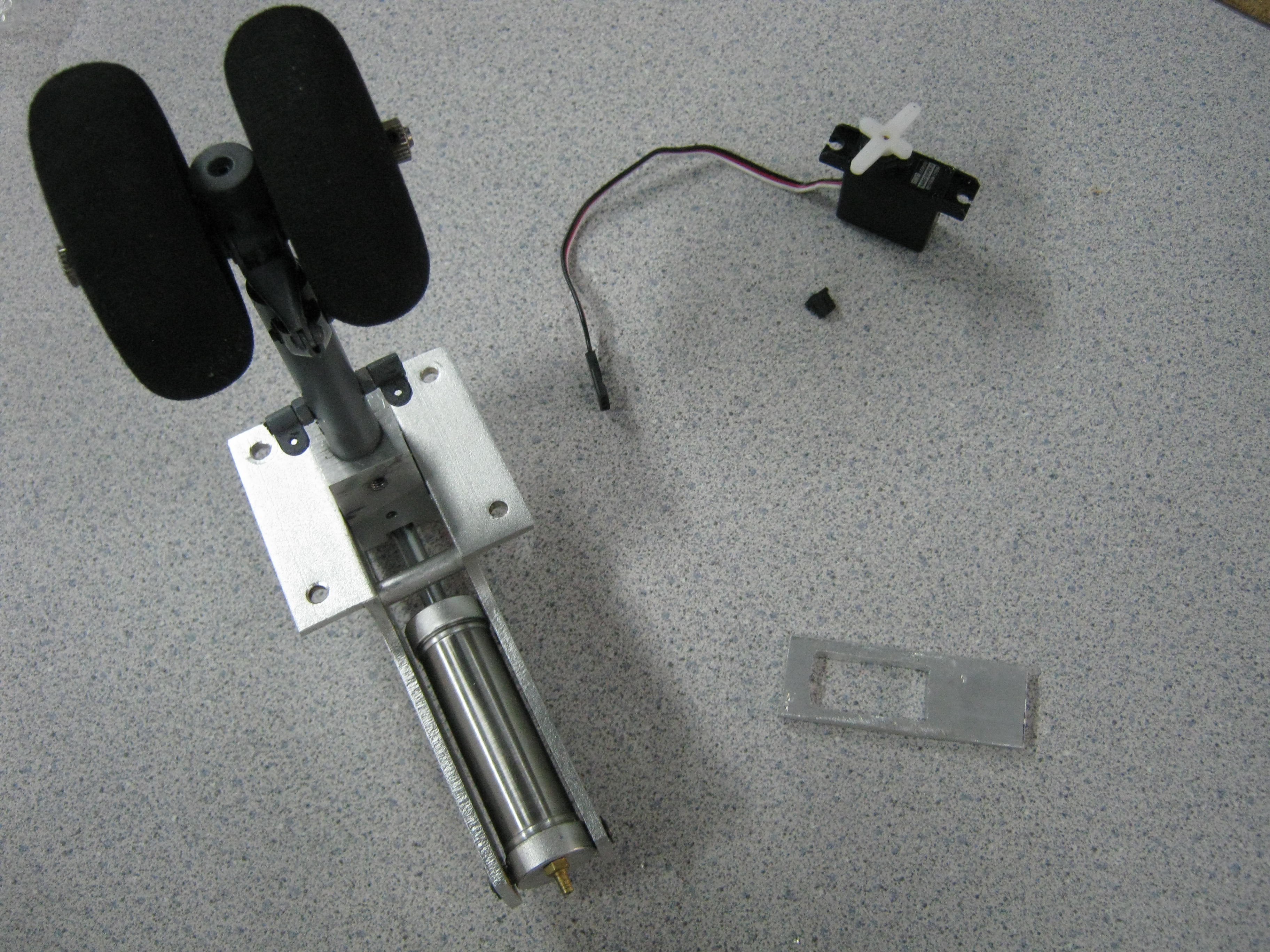

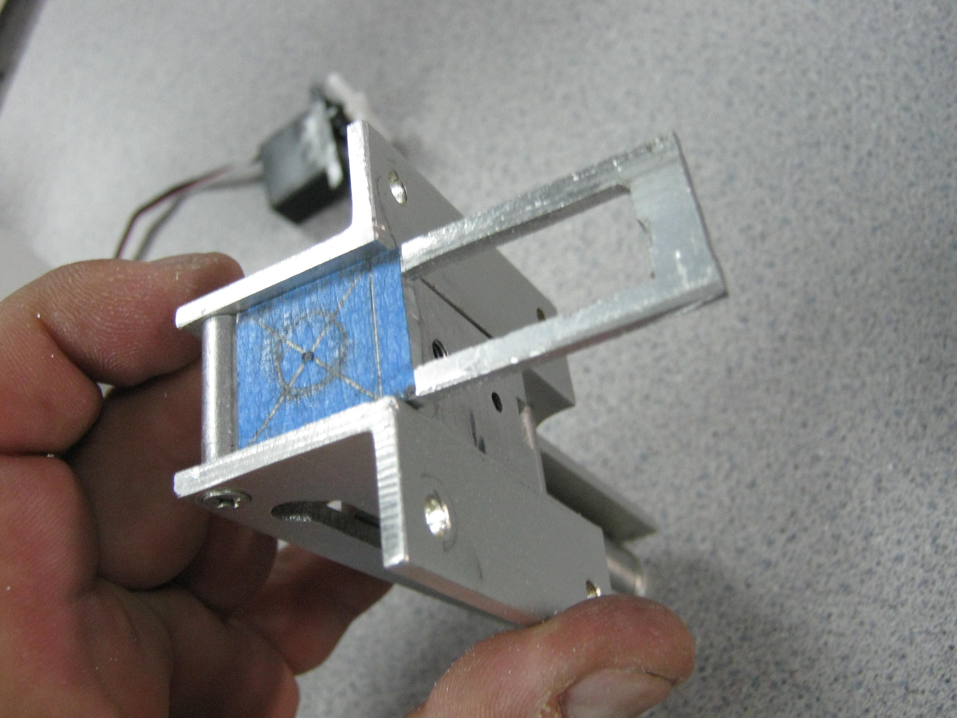

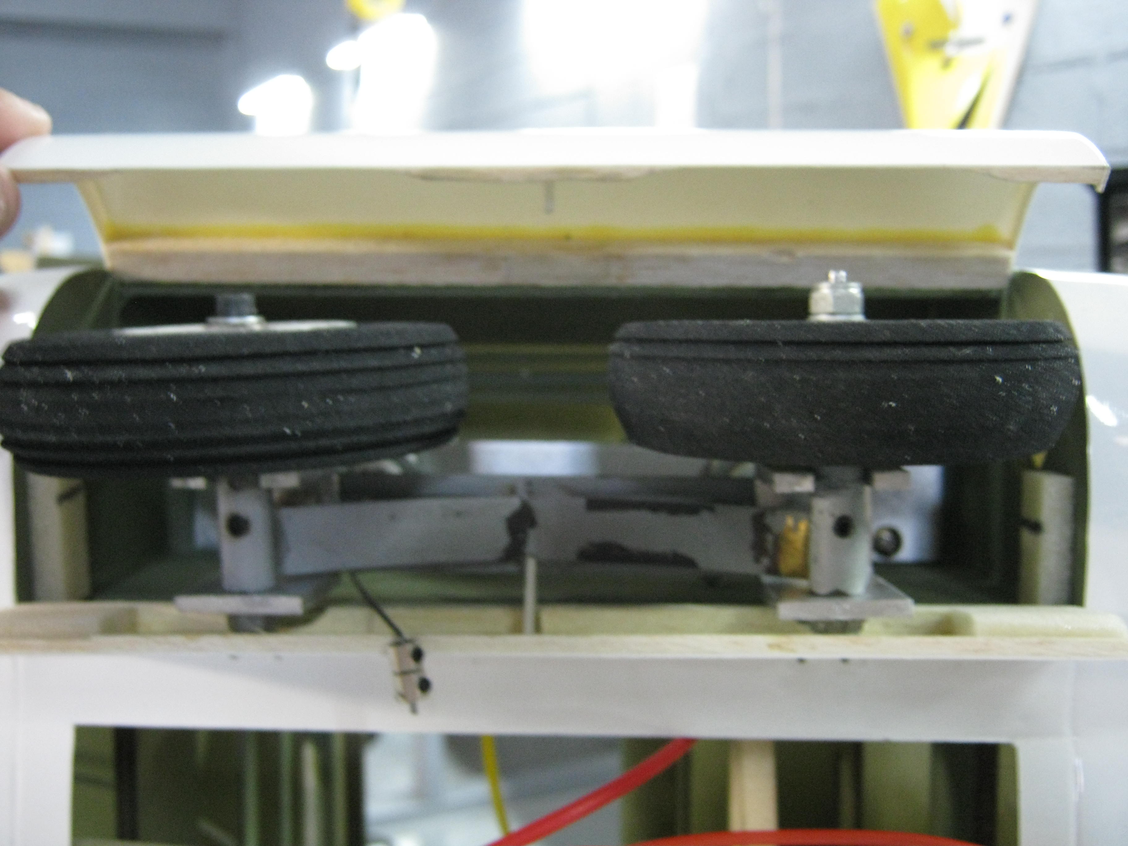

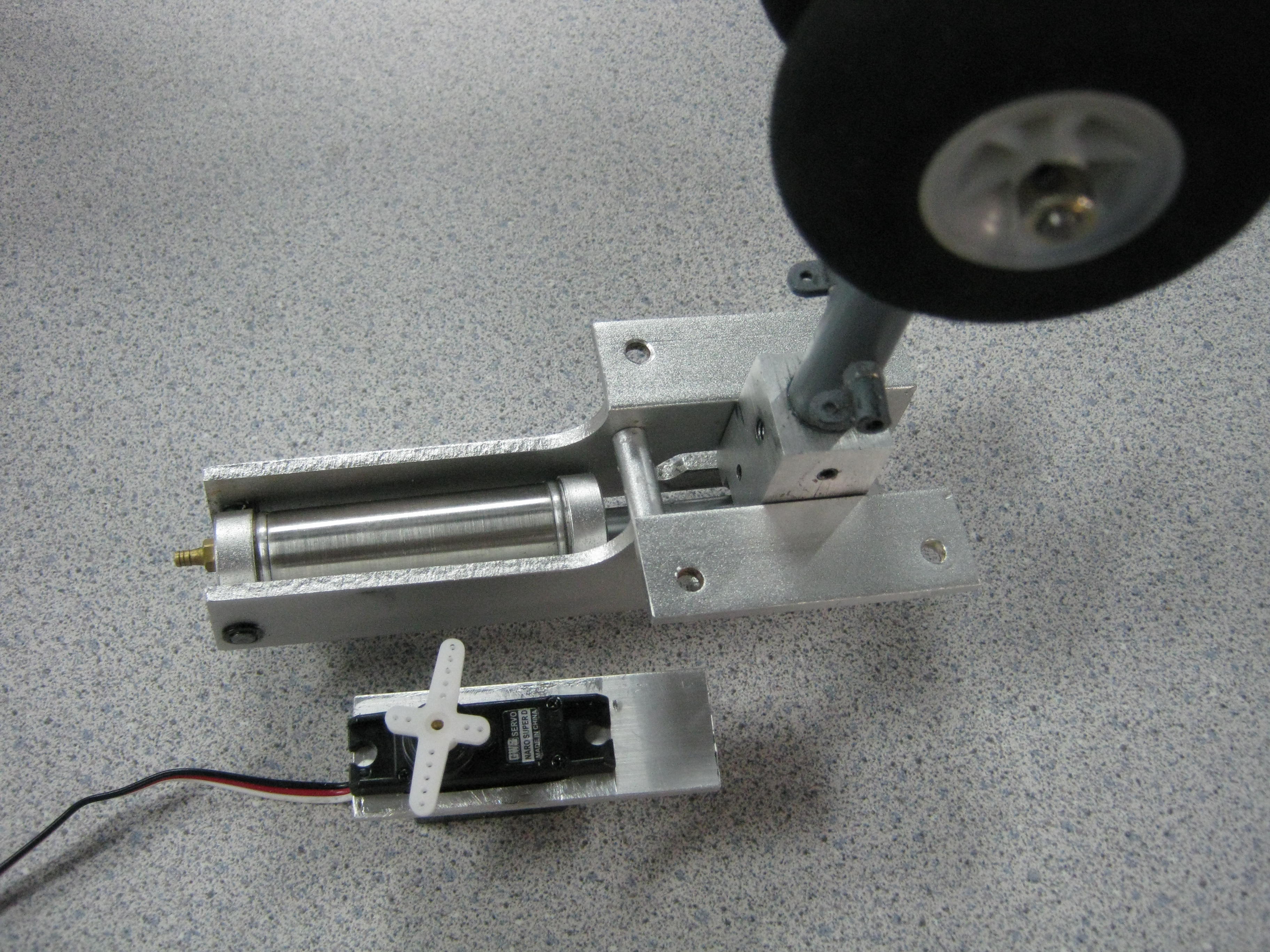

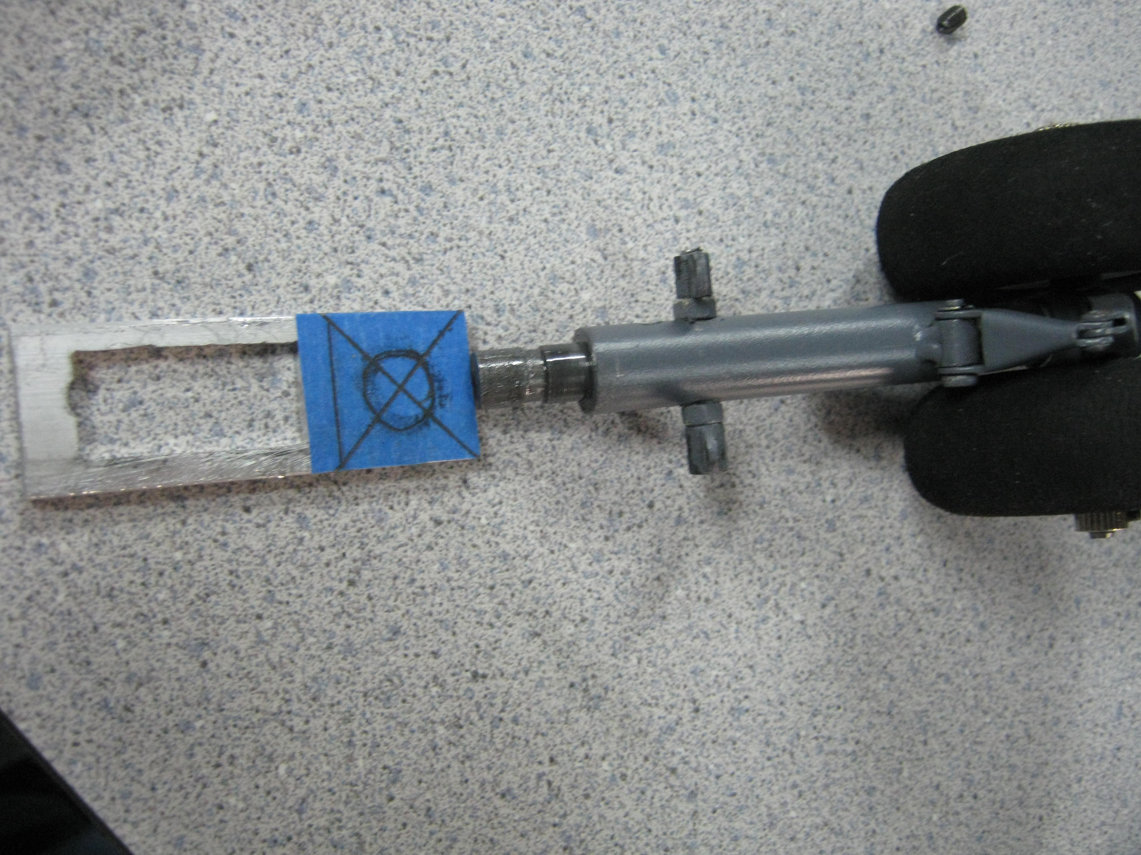

Ok so Dad modified the Nose Steering servo and let me tell you guys this works FANTASTIC, i know some guys have been wanting to get rid of that cable crap system we had I K NOW IT WORKS but it wasnt as good as it shold off been here are some pictures

Old 09-06-2010 | 12:10 AM
Joined: Nov 2008
Posts: 131
From: farmersville, CA
Hey Marvin,
Wow the nose gear looks great without the cable set up. On mine i had a couple of rubber bands attached to the middle of the cables
under tension and as the gear came up they pulled the cables away from the gear and cleared it. just one question with the servo
mounted like it is what will you use to pull the rear nose gear close when is retracted.
Also just uploaded pictures of the flaps and slides.
Jerry.

Hey Marvin and the others.
Hope you don't mind me checking out your project.
I like the nose gear mod. I used springs on my stock setup so I don't have to worry about a rubber band going bad.
I do have a question though. What servo are you using for the steering?

Hey there Testfly,
In the contrary thats why the RCUniverse its the IT!!!! cause we get to learn from each other so much and its an amazing way to help each other out aswell, the servo im using its GWS Naro Super @6vt its 69oz trq, i had to flip the servo 180dgrs to the front as it was hitting our modificatin on the nose gear door.
Here are some more pics guys

Hey Marvin how did the flaps turn out. I finally got the pictures of the flaps uploaded. love the crew entry door good place to hide the switches and air valve. Also are you using push pull cables for the elevator and rudder. just kinda concern about the slack on the cables and the equal throw on the elevator. Just wonder if a solid rod from the servo would be ok but hidden.
Jerry.
