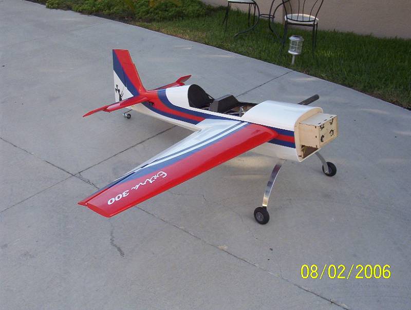

I'm really impressed with the new 300, the fit and finish surpassed all expectations. The wings are very light and were a perfect fit making this a very easy arf to build.

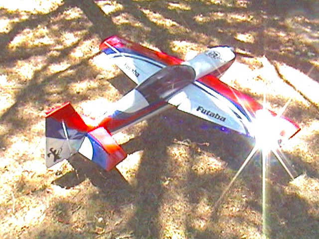

I just got my WH Extra today and wanted to post a pic of the red, yellow, black sceme. It looks awsome. I was truely impressed the way the plane was packaged. I arrived in perfect condition.

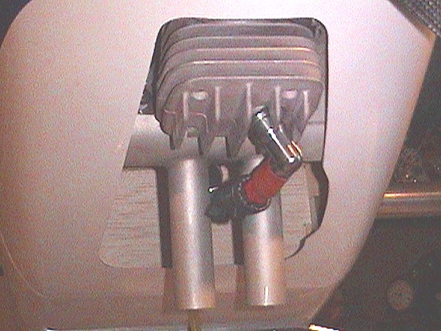

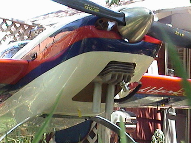

Looking at the pictures of the bottom of the cowl in post #77, I have some concerns about engine cooling. There's not much head hanging out the bottom of this one and the cowl is cut tight to the exhaust.
I hated to cut the cowl so much, but I finally opened mine up a little more also.
Shaun
By the way I just weighed mine. 17lbs 14ozs. . I built it pretty much stock with a DA50,pitts muffler,3x Fromeco 2400MAH batteries. I had hoped to come in a little lighter but I'll fly her as is for now.

OOOpppppssssss.......Those are the old pictures of the cowl. Sorry. I re-did the ign. wiring wire after those pictures.
