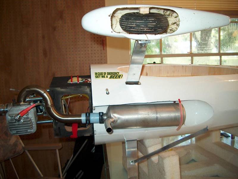

The weather was very foggy / misty and the cieling was LOW !
Cleared up later to around 70* and sunny....(sorry)
I had the plane balanced right on the center of the spar tube and It was a little twitchy in pitch.
Couldn't really get the altitude to do any trim test maneuvers.
As far as the pants, yea, I think they will be fine.
I added a couple blocks of balsa to the axle on the other side of the wheel and glued them to the FG pant to support the outside.
This is the only pic I have, but you just build the block of balsa as thick as it needs to be to fit between the pant and your wheel collar.
Drill the wood the same size as your axle and slide it on while assembling the pant, wheel & collars then jusd add a dab of thick CA to the wood and slide it up snug to the pant.
Very strong !
Jim
