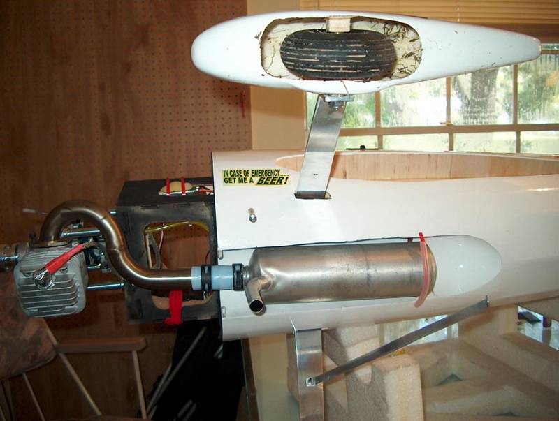

ORIGINAL: aaxiss
Tom...
For the canister?
Any problem with me drilling a couple small 3/16 holes in the fiberglass tunnel and running the zip tie inside?, I will be using a small silicone pad between the can and the tunnel and some between the zip tie also. Reason for this is I found out tonight I am severely allergic to the fumes from the RTV and also to the touch ( airway and eyes swelled shut as well as blistered Skin on fingertips). I would rather not have the RTV on there at all because it's not something I can replace myself if I have someone else do it.
You might want to investegate a food grade silicone. It does not use the same chemicals to cure and it does not have any ordor and if you happen to swallow any - its ok. It does cost a little more though.

I went ahead and drilled a couple small holes in the tunnel and ran a zip tie underneath I got a hold of some silicone strips about 1/16 thick by 1 " wide I will have a friend RTV to the underside of the tunnel for the can to rest against. I can slide another piece under the zip tie where it comes in contact with the can. this will allow me to take the can out if need be without having someone spread the RTV a second time. I picked up some batteries for my camera today and I will post some pictures later.
Getting really close to maiden now just a few more odds and ends to go

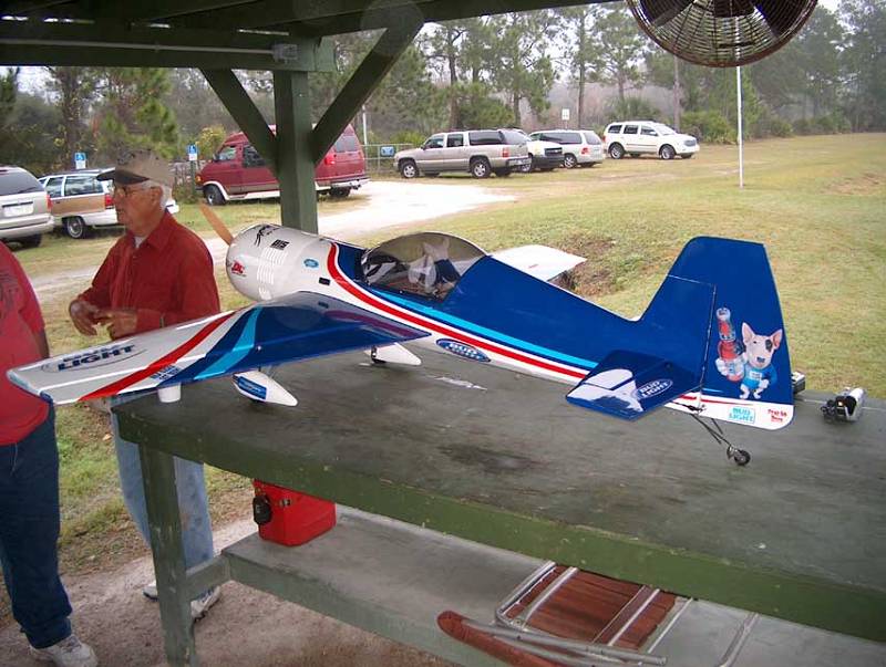

The Maiden flight of the Wildhare Sukhoi was yesterday morning at around 8:45 - 9:00 at Sanford Aeromodelers field.
After a GREAT range check I took her up for a few laps in the LOW sky.
She is a tad tail heavy, but flew fairly well for the first of several trimming flights.
She came in a bit heavy at 18 lbs. but the new DL seemed to have PLENTY of power for only the second run. And the canaster muffler sounds cool !
After a few minor tweaks I think this will be one awesome plane.
Looking forward to flight 2.... etc.
http://www.youtube.com/watch?v=8dnDeVWS9V4

The plane looks great! And so nice and quiet, very responsive. This is why I like the canister.
But the can is what accounts for the extra weight, it adds about 3/4 of a pound. Normal weight is around 17 lbs.

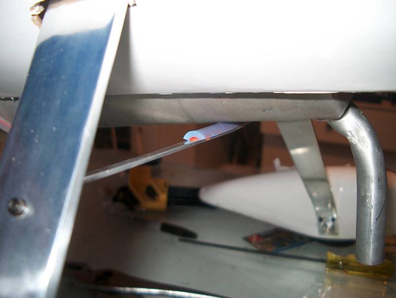

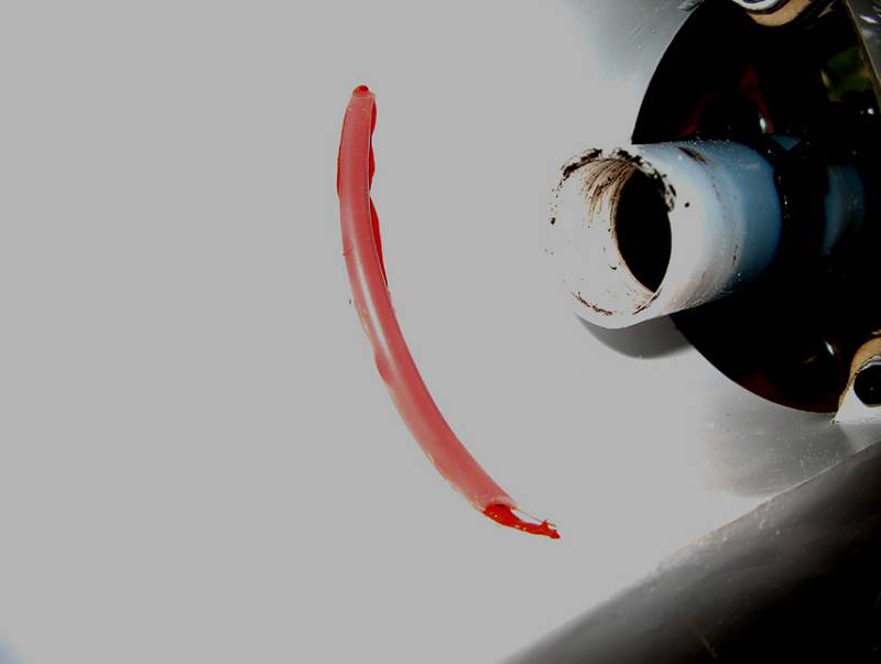

ORIGINAL: aaxiss
Tom...
For the canister?
I came down through the fuse and poked a couple holes on the outside of the tunnel right where fiberglass meets the wood.
Then I hardened the holes and surrounding wood with CA.
It took 2 tie wraps hooked together to make the loop.
Put some silicone tubing on the tie to support the can.
On the tunnel I split a piece of tubing and glued it in place with RTV.
I also glued a piece to the top of the LG support bar so no vibration (metal to metal) with the can and this adds support there as well.
Jim
