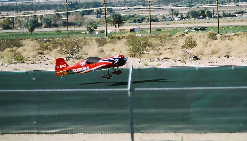

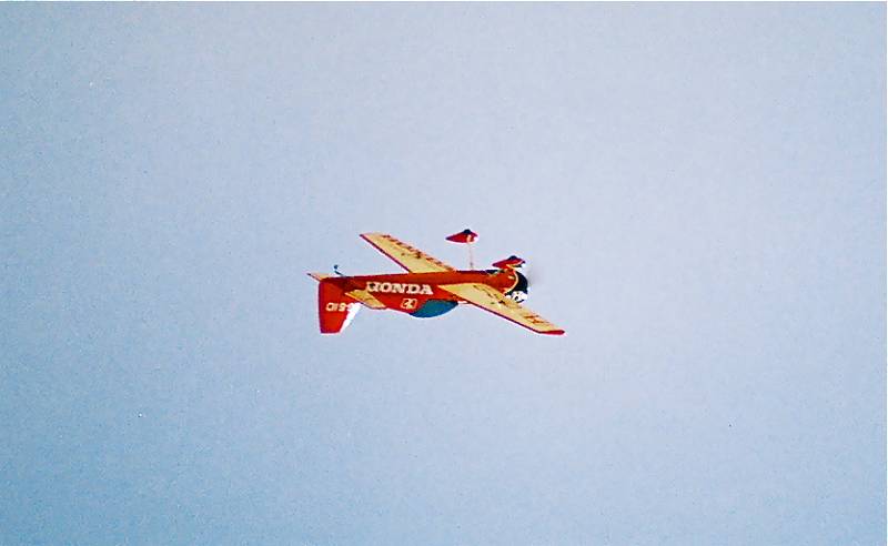

Here's a few pics- tried to upload a few earlier, but had some troubles..... maybe too many! he he!
ID:	1082505   Click image for larger version
ID:	1082506   Click image for larger version
ID:	1082507   Click image for larger version
