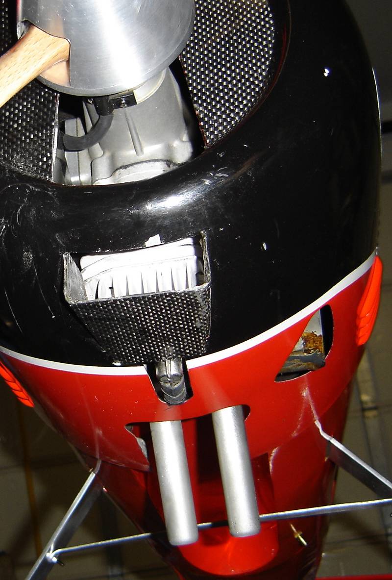

For those who are interested I am posting a couple pix of my baffled DL50. I baffle all my gassers, whether you needed or not.

Old 12-12-2008 | 08:40 PM
  #1477
exciter900rr's Avatar
Joined: Dec 2007
Posts: 142
From: Cathedral City, CA
Default RE: 50cc Sukhette Build Thread, now in progress!!
You've got to be kidding me........
I thought I was gonna be the first one to post pictures of carbon baffling in this plane.........
Where I fly, it gets HOT! in the summertime, it can get into the middle to high 120's and even up to over a hundred before 10:00 in the morning. Needless to say, I need baffling- I also made a CF scoop on the bottom of the cowl to introduce air to the middle of the head as it gets blocked pretty good from the cowl-
Very nicely done!!!!! Now I have to go out and finish it up and take some pictures!!!
Dangit! You beat me!!!!!

Ha, ha, ha,
sorry I have to laugh, but I sure tricked you, didn't I? That's no CF, although it looks darn close like it. It is simple plywood painted black and then glassed over it. It came out better than expected. I like the looks of it myself I would love to see your baffle when you are ready to post some pix.

Very nice.
Do you have any pictures from the inside or when you were making these?

How is the baffling attached to the cowl and how much does it weigh?
Next time the cowl comes off I'll shoot a picture from the inside. I will show you how it's attached. It weighs really not much to speak of, perhaps 1.5oz iff any. And since mine came out a little on the tail heavy side it was actually benefitial.

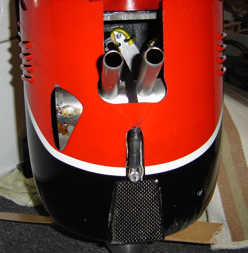

Said I was gonna post some pics of the cowl baffling, and never did...... files are huge, so I'll break it up a little..

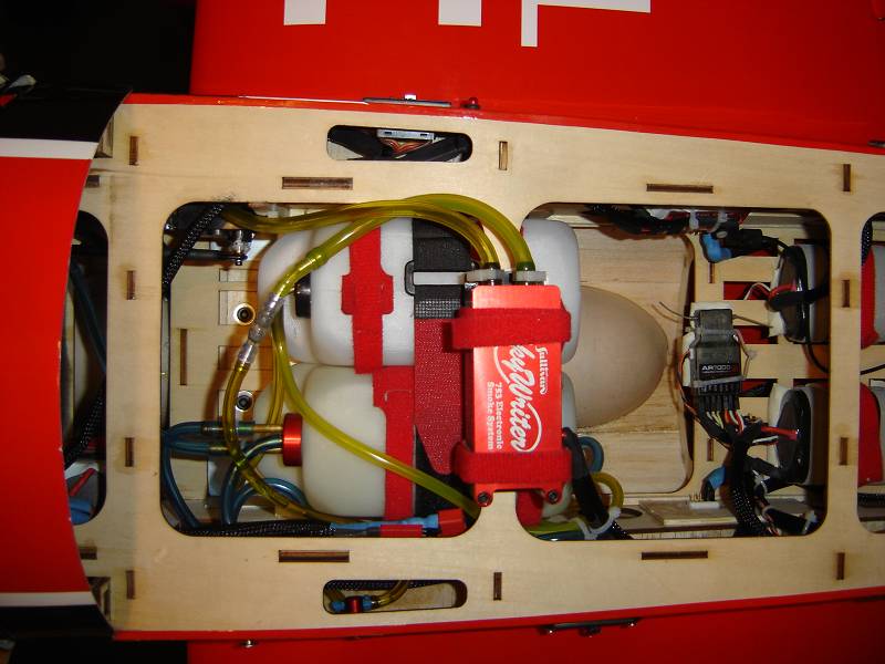

Just for giggles, some interior shots w/smoke system...

just a couple more.. there's plenty of room in this airframe, yet not that much at the same time- ***note*** I did manage to jam a $#!Tload of stuff into this bird!!
I do like the area between the engine box and the fuse sides- great place for wires and switches!

Hey Exciter WOW! thats alot of stuff, can it still fly? Must look awesome with the smoke on. What size fuel tank is that? Is it the original? What's the weight up to?

And people frequently wonder why a 50cc plane doesn't perform like they think it should.... This is where wing rock begins with a plane that normally doesn't have much, if any.

Hi Ruski-
The original tank size is 24 oz. This is not the original tank- it is 16 oz. and the smoke tank is 16 oz. as well- 7 minutes on timer with about 3 min reserve (main fuel tank) and about 3 to 3 1/2 minutes of smoke if left on at WOT. I have the pump dialed WAY down. doesn't take much oil...
The plane weighs about 19lbs, and flies great with right around 26 lbs thrust- 3mm toc53 engine with hop up kit swinging a 22/8 bunny or equivalent-
The plane looks awesome buried in smoke backing down in a hover.
I never complained personally about wing rock with this plane- Obviously, with smoke and redundant batteries, one wouldn't assume they were building the ultimate 3D machine-
Also, the camera makes it look as if it is jam packed with stuff, but that's kinda why I chose the angle...
Not to say anything bad about the plane by any means, but I found it difficult to build the plane bone stock to the 16 1/2 to 17lb range without ditching the redundancy and the ignition battery- thats only like 8 oz of battery and maybe a couple for the switches...

Hey Exciter is that a Bisson muffler? Tom said it wouldn't fit the suks round cowl, did you have change anything?

Ruski-

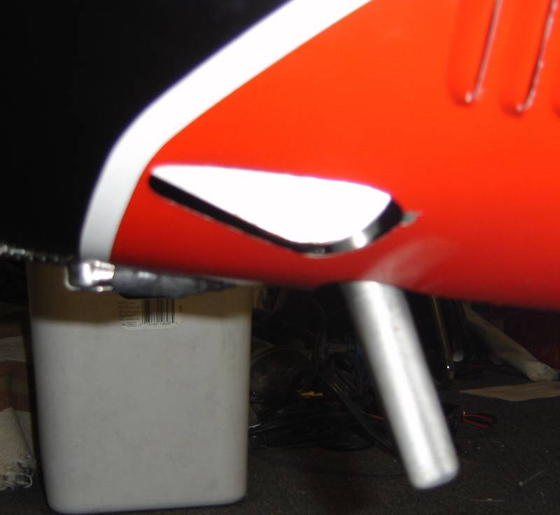

Yes it's a Bisson pitts, and yes it fits, but you will have to be VERY creative with cutting and notching the cowl, and cutting a bit more than one would normally feel comfortable with. I must say that the lay up on the cowl is exceptional, and it's plenty strong, just kind of a pain in the rear to get the cowl on and off with this muffler-
If you (or anyone else sees the pics with it in the plane, and decide to use it, the key is to make a day of fitting, cutting, marking re-cutting, re-fitting, etc, etc, until you have taken JUST BARELY ENOUGH material to make things work- It is paramount that you leave as much cowl as possible so that it retains its integrity-)
I'll post some pics when I have the chance- I am still recovering from the planes first "off runway landing" as I screwed up today and (a,) never set a high idle after takeoff, and (b,) slammed the throttle shut while on the smoke. I have noticed that the couple hundred rpm you will most likely lose from the smoke will transfer back to idle if you are abrupt with it- My assumption is that the smoke oil expands as it is injected into the muffler, and creates a bit of back pressure thereby reducing the overall rpm output- anyway, like the other bunny that I have, its a strong airframe and took the impact pretty good all things considered. just a touch of cosmetic damage, and the only structural damage was the right LG leg mounting plate in the fuse is fractured. all in all considering the wet weight of the plane (20+lb) It faired VERY well!

Muffler pics- Figured I'd just post how I cut it for the Bisson....
