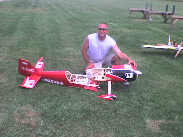

Ran my first one with a DL 50 and building the second with the DL 50.
Just added a removeable servo tray in front of the fuel tank (right behind the firewall) and put the throttle and choke servo's right next to each other. Worked great for me on the first one so I'm doing the same on the second one.
Or for the manual choke look at post #3007 in the DL50 thread Rigofly has excellent pictures of his setup in his GP Yak. http://www.rcuniverse.com/forum/m_64...21/key_/tm.htm
Jim

n57tc,
What happened to the first plane? This plane seems to make a big impression on people , as they replace them with the same plane. I know I will do the same.
Obee.
Old 12-08-2008 | 12:43 PM
  #1472
Joined: Mar 2006
Posts: 151
From: Elkhart, IN
Default RE: 50cc Sukhette Build Thread, now in progress!!
Obee,
See my post #1272 in this Thread for the story.
I did buy another one off a fellow RCU er who did not want to build his.
Tom was still out of stock at the time. I have it ready for next year, the snow is here now so I have to wait to maiden it.
Jim
