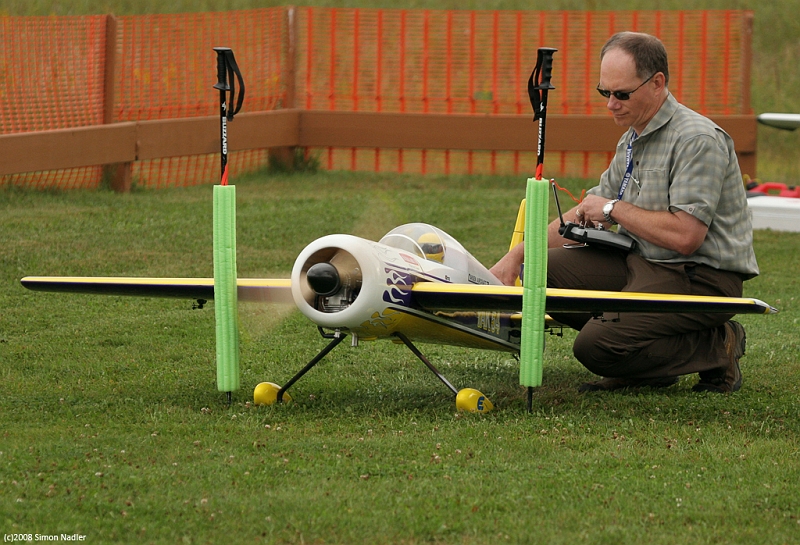

We used ski poles shoved into the ground, and we put foam pool noodles on the poles to protect the leading edge of the wing. Works very well.
