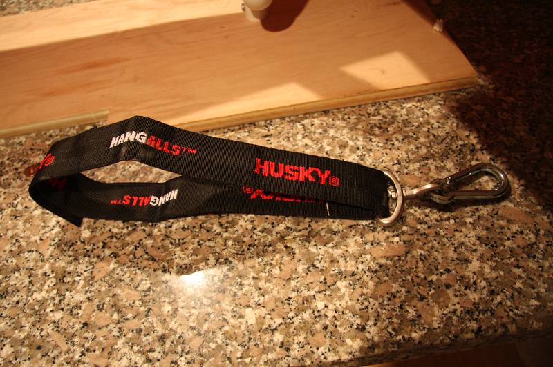

I think I came up with something worth passing on. In light of recent safety issues, I have found a very user friendly and safe way of starting a large scale plane that has proven to be more reliable than someone standing in front of the elevator. I purchased a package of Husky Hang-Alls (vecro strap hanger) from Home Depot along with one of those yard screws that is used to anchor a dog lead.
When at the field, simply put the yard screw in the ground in your pit area, wrap the velcro retainer strap in front of the elevator and over the fuselage. Then using the provided snap link, attach to yard screw. Make sure at least 4" of the velcro overlaps and begin your start up sequence. Once the engine is started, simply stand in front of the elevator to do final pre flight. When ready to taxi, simply bend over and rip the strap loose and voila! your ready to go. Total cost: $15 for straps and $8 for yard screw. See photos

yeah Fox6
I like it???? very simple. It wouldn't take up much room either
Lee

Awesome Idea gonna have to make a run to Home Depot

Okay, I just realized that Home Depot no longer carries these. Should have known because I bought 4 packages on clearance about a year ago. Anyway, the only place I found while searching the internet is Harbor Freight or Tractor Supply Company.

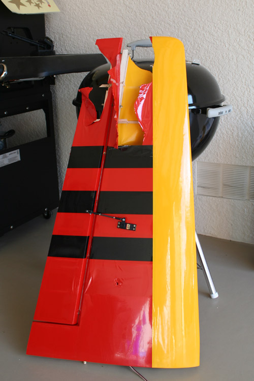

Old 11-18-2008 | 02:03 PM
  #1419
Bdegan's Avatar
Joined: Feb 2008
Posts: 487
From: Newmarket, ON, CANADA
Default RE: 50cc Sukhette Build Thread, now in progress!!
What does the bottom of the Red and Yellow look like ??
Anyone have photos or a link to photos ?
Old 11-18-2008 | 03:17 PM
  #1420
My Feedback: (17)
Posts: 1,427
From: Goodyear, AZ
The bottom of the fuselage is yellow, the bottom of the wing is shown in the picture below. (The damage is from a mid air with another plane and with some help, I got the plane on the ground. Tom had me a new wing panel in fives days.)
Chuck
