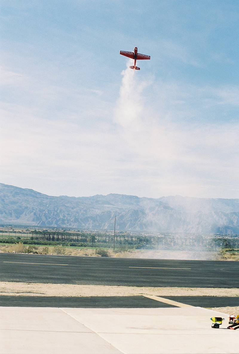

Old 01-11-2009 | 09:36 PM
  #1582
exciter900rr's Avatar
Joined: Dec 2007
Posts: 142
From: Cathedral City, CA
Default RE: 50cc Sukhette Build Thread, now in progress!!
No offense, but I'm surprised anyone would run a zinger that big- a friend has one that he had ordered at his (our) LHS, and it looks like it would not hold together on one of these 50cc engines- I could only imagine there would be a great deal of flex in it, thereby reducing the efficiency. I would not stand within 30 feet of the plane with that prop on it! Try Toms 22A prop on it- or 23/8 bunny- you want a solid thick prop on these birds, the engine/airplane combo should have NO PROBLEM hovering, even with a red brick in it! SERIOUSLY!
Change the prop and it will be a completely different bird.

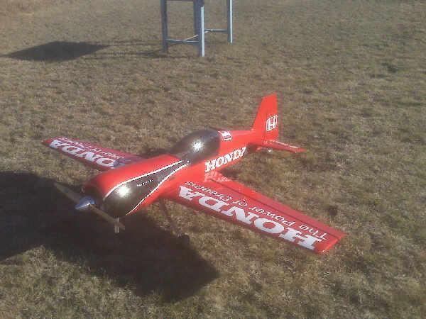

I flew my Sukhoi today! After rebuilding my landing gear, and rechecking my C.G. and adding in some more expo, I finally got to really maiden this thing.... One word... WOW!!! She flew like a dream! Thanks to all of yall who help out by answering my questions... Here's a pic from the field today, it was taken with my Blackberry, please excuse the low quality.

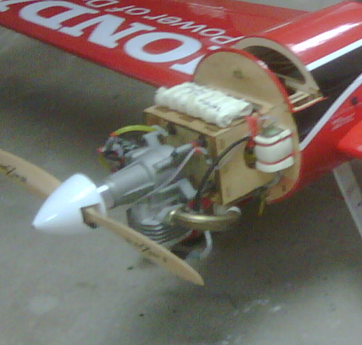

I have a question for TOM, can i install a smoke systems in my WH sukhoi, i have the 3mm toc 53 cc with hop up kit, and the canister. Can i make some smoke with that? if so where do i install the gas inyector? Thanks.
Old 01-18-2009 | 05:57 PM
  #1598
Posts: 18,602
From: Valley Springs, CA
No problem adding a smoke system. All you need to do is move things around for the second tank and the pump. Depending on your throttle servo you might be able to belly a pair of 16 ounce tanks togeher in the tank area. If you're not running a pipe you might be able to do an over/under installation. Keep all the added stuff as close to the wing tube as you can to avoid a CG that changes as smoke burns off. Things can get ugly when that happens.
To make a smoke muffler all you need to do is add an inlet nipple to the muffler close to the exhaust port.
Old 01-18-2009 | 06:25 PM
  #1599
Joined: Dec 2008
Posts: 10
From: MaracaiboZulia, VENEZUELA
Hi TOM, thanks for so quick reply. i have the throttle servo up from, and im running a pipe. i have a 24oz tank up fron, and 16 oz tank just behind the wing tube. i installed the inlet nipple right where you said, close to the exhaust port. here is a pic of the installation, sorry for the quality but you can see the inlet nipple. Let me know if this is correct.
And again, thanks a lot for your help.
