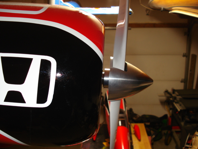

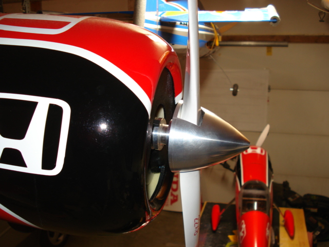

Hey Virginian, I used 1.25" long stand offs for the motor, that put my prop almost an 1" away from the cowl, makes clean airflow at slow speed. But any way thats why he needs to post some pics so we can have a look cause even something as small as I just mentioned can make a big difference.

Wow Skyriter, stange I only have one A123 pack and it's way back and I never put my wheel pants on. With the stock muffler it was nose heavy, then I put a canister on and I still moved the battery back some more! The wheel pants wont make much difference if I put mine on I wouldn't even check the CG. Also it's OK if the CG is more on the back of the wing tube I don't find this plane so CG sensitive, planes with thin leading edges and thinner chords are more sensitive in my opinion.
