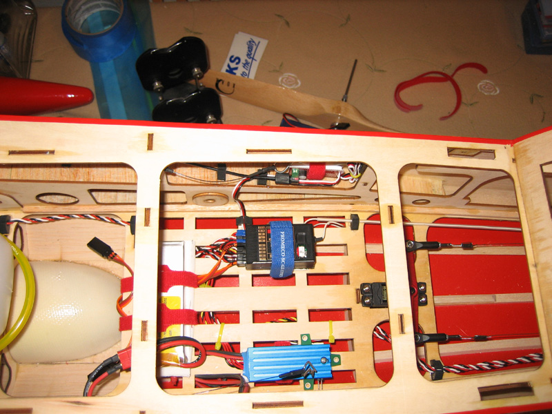

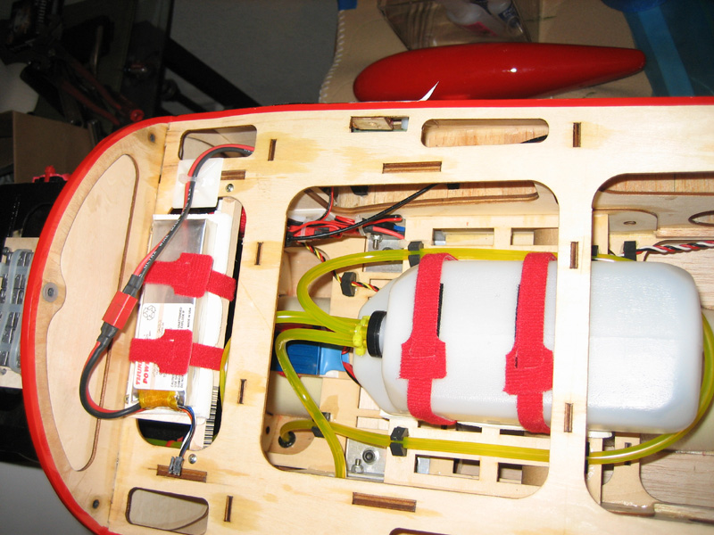

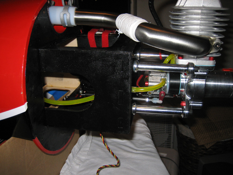

Default RE: 50cc Sukhette Build Thread, now in progress!!
I had to add 1 oz. to my right wingtip and have everything else balanced laterally. Figured 1oz wasn't too bad based on wood densities and the amount of glue used on each side...
Maiden for mine is next weekend. Fired up the DA and set high/low idle and checked for linear throttle response. All ready to go so getting ancy. Haven't added graphics yet and will this week.
Here's a couple snapshots of the interior setup... I used the snap linkage on the throttle for length and have replaced it with ball-joints so no worries there
Jason

Nice neat build Henna. I like the black paint in the engine area....assume you'll paint the inside of the cowl black as well? That always makes for a nice look and sets off the engine.
I've yet to jump onto the giant scale wagon, but really like what I've seen here from Wildhare.

Thanks - I did paint the inside of the cowl black as well. I debated red, but the black looked much better.
This is my first large gasser (even though years of Nitro and Electrics) so new to the experience as well... Very happy with the WH plane so far and can tell that I'll own a few more WH planes before all is done...

Just watch the engine temps...mine was overheating and despite what Tom says i dont think theres enough cooling at 100f outside temps.
Same setup as yours.
Would sag after a few minutes in the air despite needle settings.
Added a baffle and will try it once my wing tube gets here as I bent the original.

You might think about "cheating" a little bit. The bottom lip of the cowl is dead in line with the top of the head. Cutting an oval air entry in that lip helps with cooling more than you might think.
Good point I looked at that, now I will have to do it.
