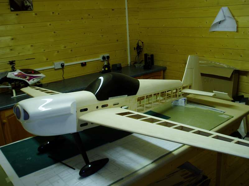

Foofy + whoever else is interested,
Here are the pics of my home made nose ring support. It made out of 1/8" lite ply, 1/16" birch and 1/4" carbon fibre end grain balsa.
Angus

Ok,
Fuel tubing is to stop the needle extension ratting against the cowl.
I need to support the nose as with the mount ive got (regular Hyde) the front of the engine would move far too much if i didnt plus you would wear out the two discs in the mount. Mounts such as Gator or Hyde ARI dont need this.
I have not used a wooden prop on a Dingo but its the right size so as long as the hub doesnt compress at all when you tighten it up im sure it would be fine. Not sure about the Model Technics 20/20. Again, ive not used it but a friend of mine has and the engine seemed happier on the Coolpower. Most pilots use 20% oil absolute minimum. Coolpower has got about 22% oil or so and lots more nitro and the engine definitly sounds better and goes better. CPLR's Cosmo fuel has about 23% oil i think. If you can i would recommend you use Coolpower or some other fuel with more oil from the start. Could always add more oil and nitro to your model technics but i dont know what oil is in it. It's probably advisable to use a thin, low viscosity oil and i would'nt touch castor with a barge pole.
The engine is still rich so the fuel consumption will decrease a wee bit. Also going to put on a bigger prop once ive put a gallon through it. Will probably go from 16X12 to a 16X13 or 17X12 (18X8 to run in, 18X10 or 19X8 thereafter for 3D). Basically you want a 18-22 oz main tank (use the foam clunk by the way, stops air getting to the header tank) and a 2oz header and you should get a 10min flight.
Also, you will need to clip your fuel line when filling to stop the engine flooding. Some pilots use surgical clips for this. I just bring a small length of the feed line out of the fuz (see pic) and then clip it with a bulldog clip when filling and immediately after you land.
Angus
ps yes, go for a 160! Best engine they've ever made

I would be wary of using a wood prop on this 4 stroke Luke.
Its interesting the views on the header tank.... was speaking to the folks at ZN the other day and they dont feel the need. So far as I know CPLR doesnt use one either, but dont quote me on that havent spoken to him for a while... he's due a call maybe I should ask !?
Angus... interesting mod for the nose ring... been considering how to do something along those lines myself..
Fuel tubing on needle.... I'd say to limit chaffin on the cowl and to reduce vibration overall when you grab it - I do the same often, although this time I elected for a bit of bowden cable with a collet on the end so its not rigid.

Ive heard that CPLR sometimes does'nt use a header aswell. I dont have a header in my Capiche and it stopped once after a wall. Was near the end of the tank so i gave it the benefit of the doubt - been ok since. The Synergy does have a header and the engine has never stopped. You could try it without a header but i would say the header would guaruntee no engine stops.
Aye the nose ring support is a sublime piece of engineering eh
Angus
