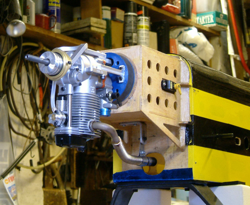

Default RE: Capiche 140
Ys160 is in!

Luke not keen on the single bolt each side motor to mount [:-]
PS. Luke I used Ola's dwg and added all upgrades to 140l spec then drew the hyde ARI to suit. Mine has fibre arms and bolts on all four holes.

Y do u need a nosering?

Adam. It helps stop the motor ocilating @ low revs.

But then it be a hard mount It stops the front of the engine flapping about (technical term)
Angus

cool, how come on lukes 160 he has no bolts at towards the front of the engine?
adam

Its bolted onto the rear holes of the engine mounting lugs

Luke, are you telling us Hyde recommend that the motor is fixed like that?
on pylon engines we use big solid cast mounts to help maintain the crankcase shape (there are big forces acting on the crankcase) and a lightly made high performance 4 plopper like the YS160 must be subject to some serious forces (especially with a heavy glass 19" prop doing 9k) I don’t know if we have any "real" clever people out there but i would like to know what gyroscopic force is applied to the mount when an up line flick roll is done at WOT.

I can't quite understand the logic in stopping the beams 20mm short like that [:@]
Unless its because it is dificult to swing the motor into place. On my ARI with the 140L I had to take the nose ring off fit the motor then reattach the ring.
As the boy said a 19x8 in a snap is going to give a lot of greif to those 4mm bolts and that last bit of cast ally with holes in [:@]

not to mention a wall[X(] how many bolts hold the back case on luke?

If you mean how many bolts hold the mount to the fuz, 6 bolts hold it to the firewall, and each of the engine mount beams have two bolts securing them to the mount.
The rubber of the mount does have quite a lot of rotational flex in it so should help.
malc i dont think thats the reason why they did it, because i had to take the nose ring off to get the motor in too.
I willl try it as it is at the moment, and if its not up to the job i will get some fibre arms or get dad to make some.

I have no issue with firewall to mount Luke. Its the mount to motor I hate.

i see how it works now,the nose ring is the main structure for strength,does the 160 run smoother on idle than the 140?
