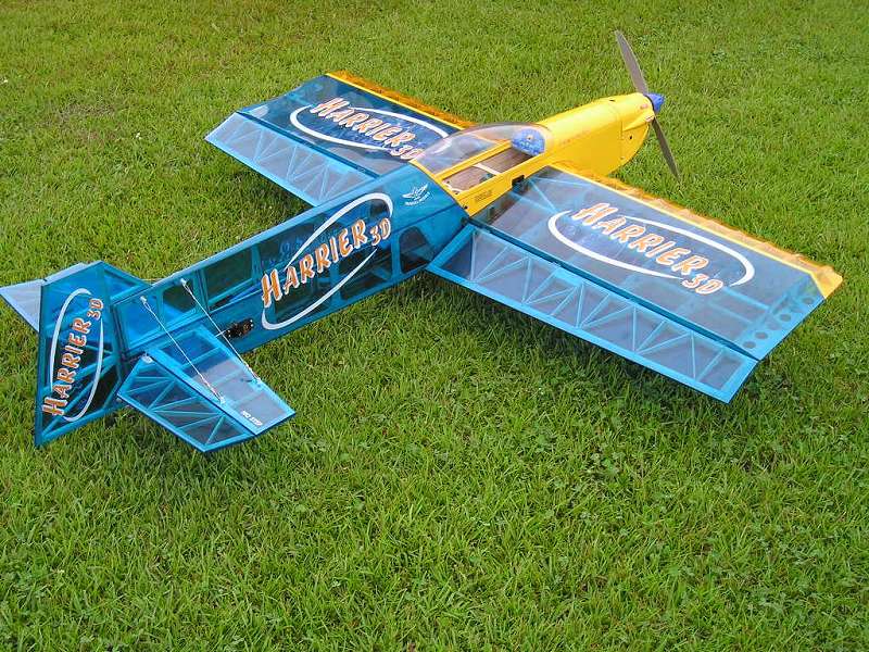

I just flew mine -on a Saito 100 plus a 15x4 APC on Magnum #1 fuel.
Mine weighs exactly 7 lbs dry -
The servos are all up front and balance is spot on the recommended mark. I did quite a few equipment mods and the tail wires are simply two pieces -contineous.
Real thrust is 9 lbs
so -I have 9/7--or almost 1.3 -1 thrust.
Nothing to yell about and dead slow compared to my electric foam stuff.
But it is very nice to fly and I really like it.

I swapped out landing gear - tore out the huge blind nuts -used none of the tail hardware and used only 5 servos -no spinner - etc..
I was SERIOUS about the weight as the Funtana was a real power to weight problem----------
Magnum fuels are a step up in power - from 15% -
I can easily document 12 ounces of dead weight left out - no problem
servos in the rer typically add over 3 ozs per servo - counting leads/linkage etc..
put up front - using ONE elev servo and a good fork pushrod is a huge savings and balances thigs much better.
Ever see a full scale plane with big ol servos poking out under the stab??

My cg is at 175 mm behind the LE with the tank empty. it seems like a good location. i was flying in a lot of wind, so i couldn't give you an accurate idea of the mixes.
#46
Stick the 180 in it- and it will pretty well balance out -
Note of caution: The plastic control horns are really a bit light weight and flex at their base.
I would recommend slipping on down to the spares bin and finding some sturdier types
Also the push rods are smaller than 2/56 types made by Sullivan or DuBro etc.
I fly mine, VERY slowly so there is no real problem but if you ever develop some speed -the existing horns may flex too much .
As for the "harrier rocking -- ANY tapered wing layout will rock - -It is simply restabilizing at work
The short low aspect ratio wing is best ( my opinion) to provide a steady vertical sink.

This is the easiest arf so far. Had a few packages of GP control horns, a bit more sturdy.
On my way home from work last night grabbed some 4-40 misc rods I can cut to length.
Also upgrading the H9 clevices.
It took a matter of minutes to glue all of the surfaces. This is usually a time consuming
process on my larger gas models drilling, tapping, and installing the robart hinges etc.
I went back over the hinges a few minutes later with a little more thin CA, then wiped them down
with a little paper towel coated with debonder. This AM when I checked them they seemed very firm.
I've just finished cuting a true turn 2 1/2 (per instructions in this thread or another) and using an
APC 16x8 prop... not sure if there enough room for a 17x8... I will try it later.
It also took a matter of minutes to install servos in the wings. Very easy when you can see what you are doing.
Having the wing tubes is going to save a lot of time as well. I suppose this all makes up for all the time that is
supposedly spent on the flying wires?
Now, got to dig up that Saito...........

Well, good news; I finally sat down to do some work to the model. Noticed when I glued the ailerons
they are slightly inset so the tip of the wing and the aileron don't line up. Did the same on both sides... must have been
looking at the trailing edge of the aileron. Oh well, minor! lol
In one evening, All servos are installed w/ extensions, new pushrods cut and installed on ailerons w/ new hinges.
Fuel tank and tubing installed, and I futzed around with the stock engine mount for a bit before I got the Saito
1.80 to fit. I manages to make a small inset on the firewall for the edge of the saito's carb to sit in, giving me
a couple extra mm to work with. Throttle linkage was easy to relocate, and worked out nicely. The saito barely fits,
as it is a little wider then the smaller engines. Lots of trimming on the bottom of the cowl, but it came out nicely w/ a small
hole to the left for needle valve access. This thing looks like a monster w/ the hemi sticking out the bottom. I love it [8D]
The only thing I am wary of is the carb feed is below the tank. I ran the exhaust to the tank instead of using the crank option.
I bolted up the landing gear brackets just to take a look at clearance issues, if any, and made some adjustments to the
saito's muffler.
There is not a heck of a lot more to do! Just attach stabilizers, and make new pushrods for them. Do the landning gear + wheelpants
and make some final adjustments to the cowl. Finishing touches will be my tru turn spinner, and decals..... then test the CG with RX/battery placement.\
This is a fast ARF so far. My club picnic is this Sunday.. and this one WILL be flying. I'll spend most of Friday and Saturday breaking in the engine however.
We'll see how far I get in the next night or 2.
saito's muffler.
