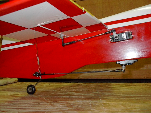

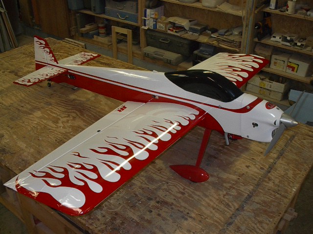

Here is what mine looks like presently. You could see the slight angle in the cowl and there is a pick of my pull/pull setup. Unfortunately, my library of mod pics is in a landfill somewhere locked in my old puter. Joe

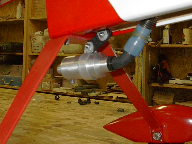

Sorry, thats the old YS muffler on the Hatori header which proved to be restrictive. Here is the new setup with a Saito 180 muffler for better flow. Joe

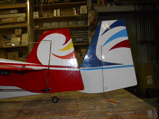

Here is a fresh pic of the results of the mod. Originally I just peeled back the original covering, removed about 30 sq. in. off the top, added a new top rail and ironed the covering back on. I later refined it with a tapered trailing edge before I recovered the plane. Joe

And the end result was not roll tendency?
Also.. with the removal of surface area.. will it still knife edge loop? Currently.. it will pretty tight.

Nice pics, last time I saw her she was white with the red flames!!

It did a great job on eliminating roll coupling. Mixing will have the same results. The rudder has an 80+ sq. in. area and you won't notice the 30 sq. removed. I felt that the high profile of the rudder was what caused it to lean or twist.
Yeah Stoney, the flames were cool, but the visibility factor was worse than when it had the blue on it. I struggled with the blue on overcast days. I could see it well now. Joe
