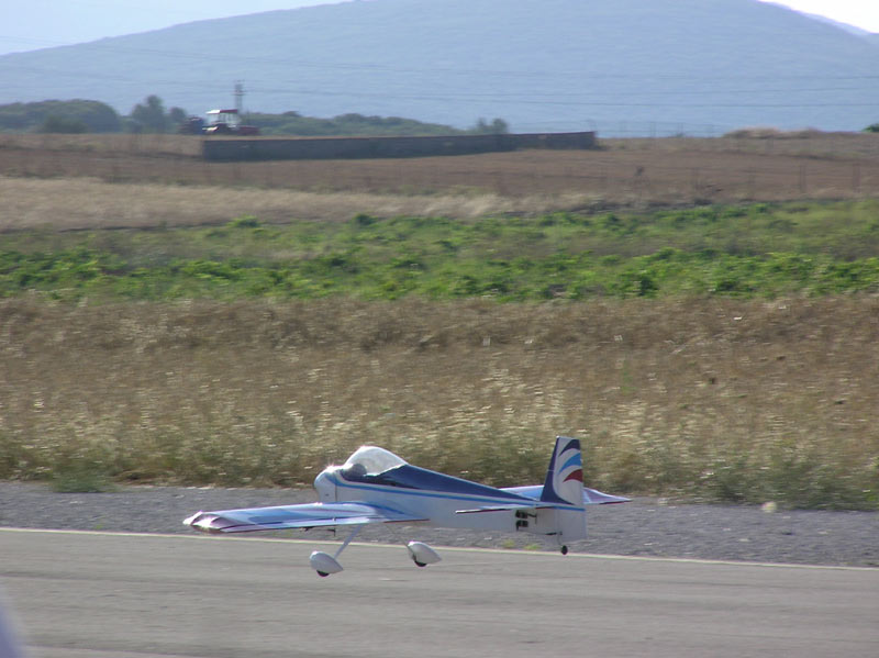

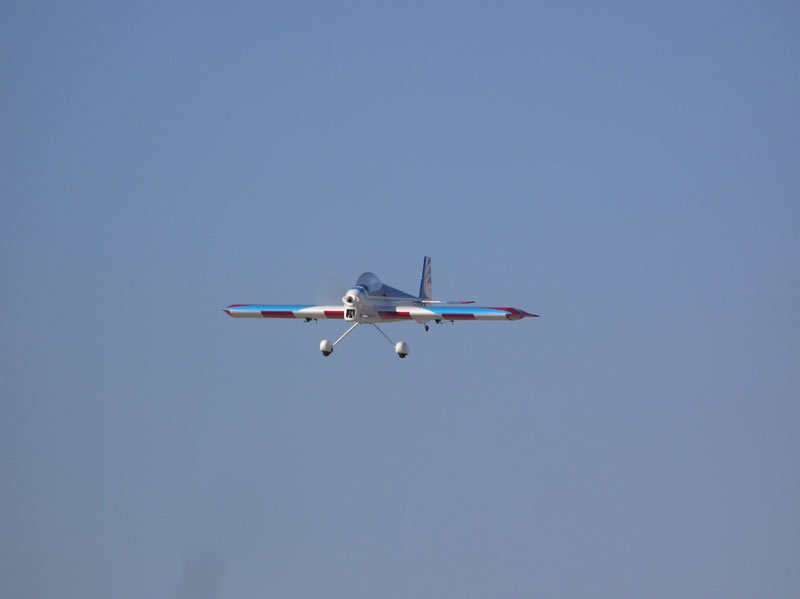

Hi everybody,
I just wanted to share a couple of pictures of my UCD. I just finished it a couple of weeks ago and it is my first 3D plane, so I'm still getting familiar with it.
My flying buddy took those pics. I hope you like them. Oh, and that last one is not only edited for motion effect, but also the mountains in the background were not there. There is no snow in Greece in the middle of August. It's 100 degrees here!

Serafim,
It looks very nice.
I do like the edited picture!
My UCD is awaiting my radio from the shop.
I was in to RC back in the mid '80s and for some reason I insist on using my old Futaba 8SGAP radio from that time!
Do you have any building or flying recommendations?
What did you power yours with?

Hi JLK,
Mine is powered with a Saito 100. I use an APC 15X4W and it flies great. Maybe when I get better at 3D I'll need more power, but for now it is great. I'm glad you like the pics.
By the way, mine is a UCD 60, but you propably have figured that out from the pics. I hope I haven't posted in the wrong thread!
