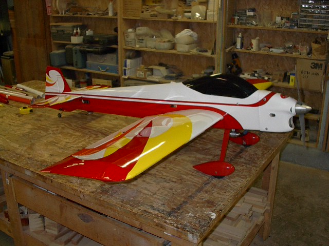

Man joe! how many UCD color Schemes to you have?
