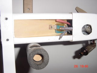

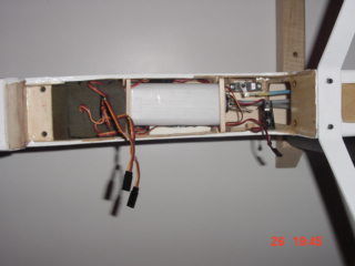

Picks

If you look at the first pics you can see them, Drill about three 1/8 holes in the side of the fuse into the bulk head and glue in 1/8 wood dowels into them.
Milton
