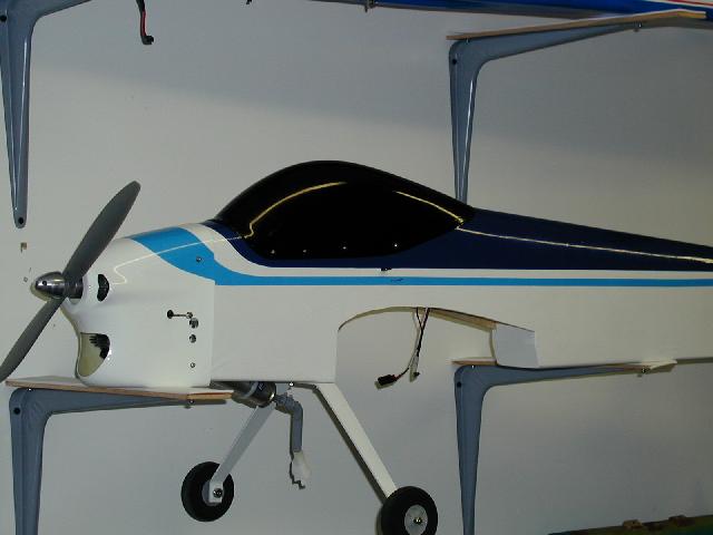

Default UCANDO Saito 180!
The only substitute for cubic inches is more cubic inches!
