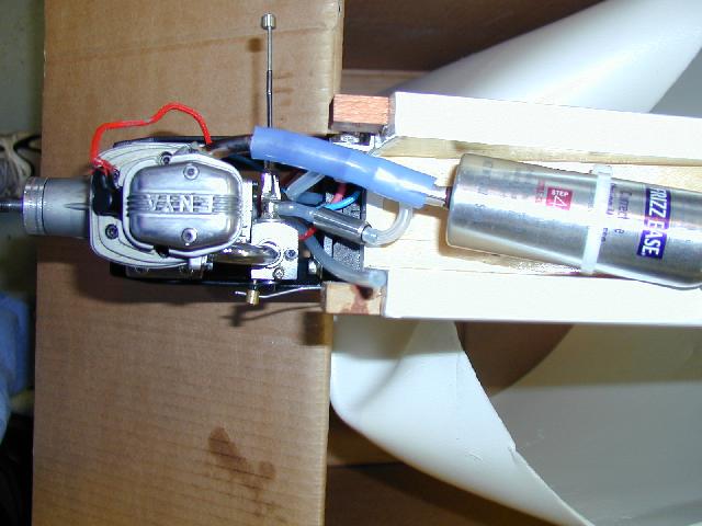

Dave McDonald might take interest in this shot. It's a shot of the exhaust and plumbing. I used a 2 oz mousse can, tapped for pressure, and 5/16 tubing from the header to the can, and a 5/16 stinger. That size matches perfectly to the Enya header pipe, and I gained an additional 1400-1900 RPM's, as well as muffler pressure (the 80 didnt have one when I got it). It's also much quieter than no pipe.
Next time I have the cowl off, Ill take a pic of the engine install. I have a 91 fx coming, in case this engine doesnt have enough pull, and will put a 8-10 oz mousse can on it for better midrange.
All up weight is under 7 1/2 lbs, and balances around 5 5/8 for its maiden flight this week.

Both myself and m.gramling are flying our UCDs with the ST 90, and both of us are currently experimenting to find the best mousse can pipe setup for a ST 90 on a UCD. (go to this thread for more details about the MCP)
http://www.rcuniverse.com/showthread...435&forumid=21
The purpose of using a MCP is to get more power with less weight instead of using a bigger and heavier engine. So far, my ST 90 w/mcp is spinning an APC 15x4w at 11,400. This is about 1000 rpm faster than the stock muffler, and the throttle transistion and response are improved over the stock muffler too. Overall, I've been extremely pleased with my UCD!!

That is a neat mousse can setup! And I'm really surprised to hear how much RPM gain you got out of that Enya 80. Can't wait to hear your flight report.
Smartwork,
Thanks for improving stevezero's photo. Until I saw your photo, I couldn't figure out what that "black rectangle" was supposed to be.
Smartwork,

Sorry about the pic quality, I took those last nite on a whim. The 80 is a four stroke, and after new bearings and many hours of playing with it(perry pump, no perry pump, insualted tubing exhaust, etc), I had it running like a top with a 13/7 13/8 APC prop on a Kyosho Majestic). That plane didnt take too well to running thru a stand of birch trees, so the engine was looking for a home.
By going with the can, I was able to get muffler pressure on it, and have removed the perry pump. I have been testing it in the driveway with a zinger 14/6 wood prop, and went from 8300 to just about 9700 with this can. I also have a much broader needle valve on it too. I now have an APC 14/4 on it, so the RPMs should go up a tad more.
Steve

Here are a couple of other shots of the engine/mousse can setup with the firewall off. I drilled a small hole in the bottom of the pipe tunnel on the plane, and routed the pressure line up thru there to the tank, which is an 8 oz tank moved back toward the CG. I put the largest fuel filter I could find at the LHS (dubro final filter) to supply as a very small header tank.
If the weather clears up (so far weve had thunderstorms every day this year
), I'll try to get it out tomorrow.
Steve
