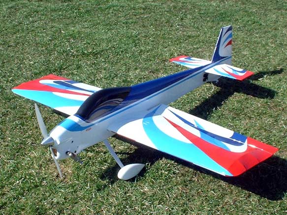

BTW, Here is a picture of my UCD. The only graphics I have on it are the Saito stickers.

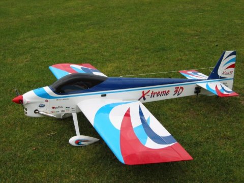

TOMAPOWA - Is that paint on your wheel pants, or is it trim? Looks nice.

Hi coomarlin,
Why did I think you were going to ask that.
Actually, way back in this UCD thread, I posted a Powerpoint slide or two that included the X-treme decals and wheel pant graphics (a few days later I posted the often required Font file). After printing on decal paper (inkjet), I scuffed the monokote lightly with 000 steel wool, applied and then covered with a light spray of fuel proof clearcoat.
You can either search for "X-treme" in the thread or simply start at:
http://www.rcuniverse.com/showthread...eme#post430239]

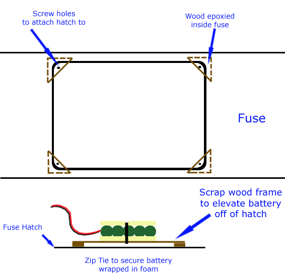

Can anyone give me some info on the best way to cut a hatch on my UCD to move the battery back? What is the best way to retain the battery once the hatch is cut? I need to move my CG back and I refuse to add weight

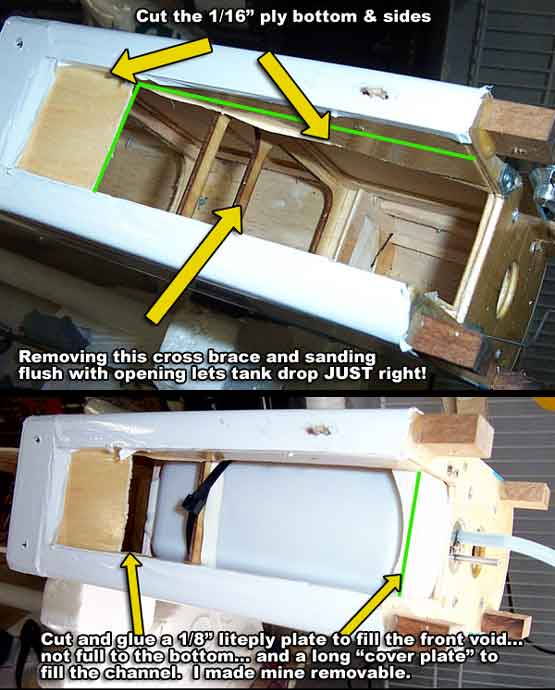

Default Tank dropping pics...
Someone shared an idea of how he dropped his tank to match the carb level... he didn't have pics but said it was straight forward... he was right...
Here's a couple pics of what's in there...

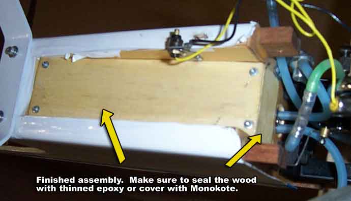

Default And the finished project...
Here's the bottom after the tank has been dropped...

I guess Ishould have stated above...
I had problems with the engine sagging after about half the tank was used up. Violent maneuvers would cause the engine to lean and quit too. And it leaned and sagged during inverted flight...
The above mod, along with the needle twekaing required because of it seems to have fixed the problem entirely.... saving me the $60 for a Cline just now....
I may still move my tank to cg and add the Cline, but this mod fixes the inherent design flaw of too high a tank in an inverted engine mounting design...
Hey Great Planes!!! Take note...
1) Stronger or better yet carbon fiber gear
2) Beef up the wing/gear former than seevral have had go out... maybe bump it up to a 1/4" part
3) swap positions of thsat cross brace to allow the tank to set on the bottom of the former... not the top... (and move the tank opening in the firewall accordingly)
I'm the one who didn't have pics. I'm glad you were able to follow through. These are nice pic's and exactly what I did except I lowered my tank all the way to the bottom of the fuse and made the hatch flush with the bottom. I used white Ultrakote to cover the hatch. I haven't had any engine problems or flame outs since making this modification (even on violent outside maneuvers). Nice job, Mordib.

I'm thinking of trying to cut a hatch using the following method. I need some contructive critizism.
I've attatched a diagram of what I was thinking. I'm was thinking about using epoxy to attatch the small trianglular pices to the corner of the fuse cut out and I intended to use small screws to attach the hatch to the plane. Do you think this would be strong enough to hold the battery in place?
Also, do you think this would even be worth while, or should I just add lead to the tail. I need to get the CG back about 1/2 inch so I'm not sure how much lead that would take. I'd like to keep the weight as low as possible.
The reason I elevated the battery was in order to get a zip tie to go around it.
Comments?

Should wok great if your hatch plate is made of ply... Otherwise the screws MAY pull thru the plate. I suppose you could epoxy 1/32" ply strenghteners to the inside of the hatch corners... but really a hatch that size made of ply wouldn't hurt a thing... Just get ply the same thickness as the fuse sheeting...

Yea, wouldnt try anything less than ply,

Good call. I didn't even think of that. The weight of the battery will produce more stress on the tips of the hatch. How much more does light ply weigh vs balsa? With a lite ply hatch and the mounting rails I don't want to end up adding a lot of wood that will increase the weight to a point that I could just add lead to the tail and forget about a hatch. What do you think?
Or maybe there is a better way to mount the battery inside the fuse and then there would be no stress on the hatch.
