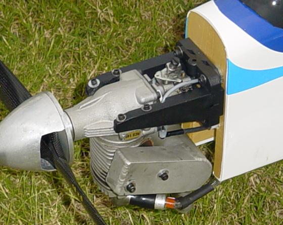

test flew this baby today with a rcs 1.4 gasser

Did you guys reinforce the firewall ? How did you do it ? The firewall seem to be just a butt joint with a couple of 1/4" triangle stocks glued to the left/right sides. Scary :stupid:

I did not do any mods to strengthen anything on the plane, i.e. no glassing or pining the firewall, tri stock extra to the landing gear. I will see how all holds up the plane lands easy to me with this set up on bounching landing it will land 3 point with just a touch of elevator on the last 6" to 11" from the ground. She slows down nicely with the 6-pitch prop.

Yep, it will certainly be interesting to know how well your ucd holds up.

How is the power in a hover with the RCS? Been sitting on my UCD waiting for the YS 110 to be released.

the rcs will finally pull out with authority,
on this plane running a 18 x 6W apc is the best prop for this motor and plane, previously swaped out the 18 x 6 mejzlik i am getting a grand less in rpm but you would not know it as the plane is stonger & much faster with the 18 x 6W better knife edge 2. i missed ya Saturday as i meet BADANDY, Dale and Lee R at the your field, BADANDY is bad on the sticks....

KrayZC, are you going to use the engine cowling on that 1.4? mine used a rear exhaust, it fit just right but just noticed from the picture that it might not work on you side exhaust without some unsightly cutting out of the engine cover. I'm getting to love the sound a this gas engine makes over my other tuned pipe glow fuel engines, I'm still using the 17x8 but i retuned the needles and gained a few RPM on top and it really pulls out of a hover now and it seems to be idleing better on landing approaches now too, I guess it was just running to rich and flooding out some on the landing before. this plane is making me want to sell some of my other sport planes, I'm getting ready to put together a 40 size Funtana and kinda wish it was a 60 or 90 size so i could put anouther 1.4 gas in the Funtana too.

supertiger i am also going to try a tune pipe on the rcs as the cowl is going to have to be butcher seeing how i don't have the RE version as you have. I noticed that in your pic and said Hum!!
The 18 x 6W has very good speed compared to the 18 x 6 Mejzlik and pulls very hard on this light set-up.
