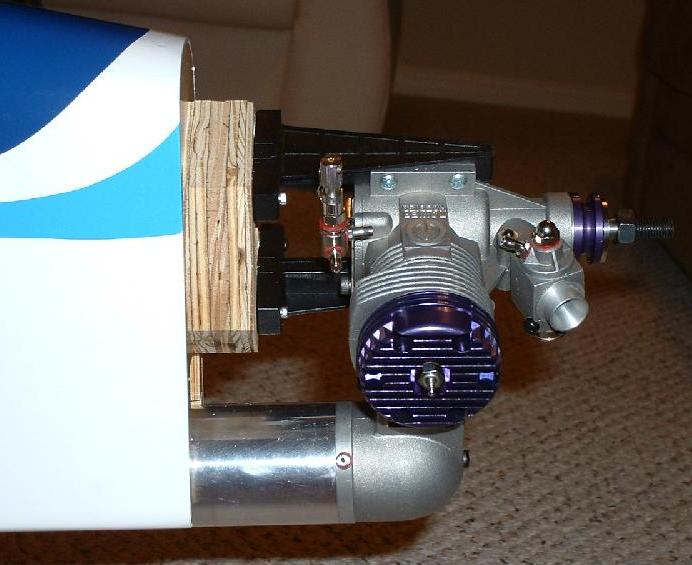

I just got the Tower Hobbies .75 installed on my UCD60. The chin tunnel was just a little too narrow for the fat muffler, so I had to widen it a little. I really don't mind fully inverted engines, but that tunnel was just too tempting a place to place the muffler.
My question is: would a little bit of down thrust be bad for this airplane? Because of engine being mounted roughly 30deg. down, it's kinda difficult to dial in just right thrust. I get 1deg. of down thrust for every 2 deg. of right thrust I put in.

Here's a profile shot. About the only things sticking out should be the cylinder head and carb. I'll give the TH .75 a try, since I've heard it's a stout little engine. After several grossly overpowered projects, I'm really trying to stay light on this one.

Hi Volfy, from the front view, your thrust line is way off center. I'll be more concerned on that than the downthrust. The chin tunnel is basically to facilitate airflow path over the cylinder head in inverted position. I will be reinforcing my fuse in various areas by using 1/16" maple dowel pinning and ply doubling and good old epoxy, without adding too much weight. I tested the glue used throughout the fuse and wing structures, and I'm sure it's hot glue, just like my other GP ARFs. Put your finger thru the firewall hole and press on the glue fillet with your fingernail, and you'll know it's not epoxy. Good luck........

Rajul, it looks off-center because the darn photographer was off-center.
You can tell that by looking at the main gear. Actually, as shown, the engine mount is offset to the left 1/8" and has two thin washers on the bolts, giving the engine slight right thrust - probably around 1deg or so. The prop hub is only about 1/8" over to the right of the center thrustline.
I realize the chin tunnel was originally designed for airflow exhaust, but I'm think hiding the big*** 2stroke muffler is better than hiding the engine cylinder, especially since the TH .75 has that purdy purple anodized head.
The two cutouts I did on the sides of the chin tunnel make for convenient places to add glue to the backside of the firewall.

your not gonna be happy cuz your pertty purple head will fade off in about 20 flights...... plus before you put the cowl on make sure that the screw throught the muffler is very tight.

Rajul, the exhaust tip is barely poking past the bottom of the fuse, so yes, an exhaust deflector is definitely in order. The bottom of the fuse and stab will still get gunked up a bit, even with the deflector, but at least that's all. Plus, I've found through experience that folks holding my planes (including myself) much prefer a bottom exhaust outlet.
Raptor, that's not good news about the anodizing. Oh well. At least I'll get to admire the purple head for 20 flights.
I never liked the bolt-on style muffler either - the inside bolt is a pain to get to - but the deal on the engine was too good to pass up.
