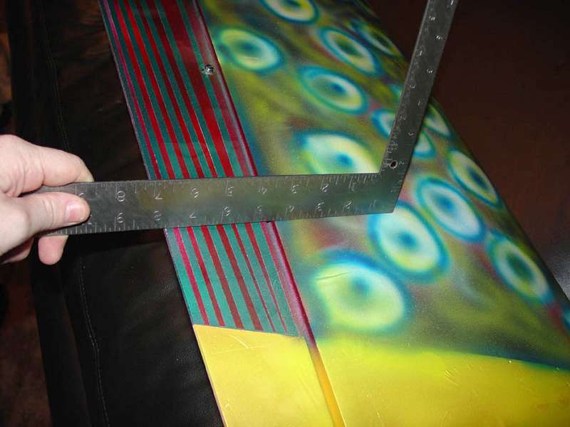

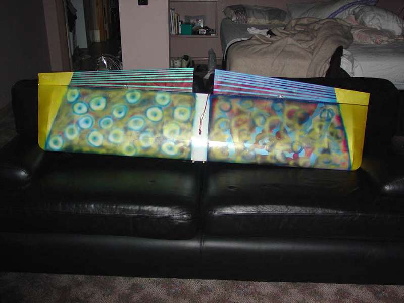

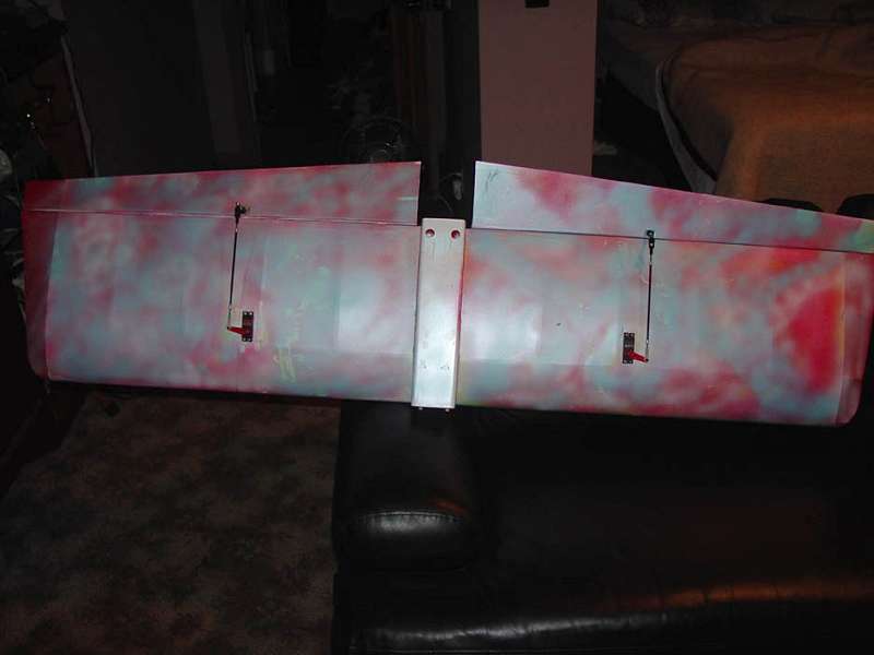

I post this by request of a member who has some problems to post pics
I also post a copy of the mail he sended me explaining his concerns
Hello
I was wondering about something that I should know the answer to, but for some reason I just guessed at it and never thought about it and that is, When you put the UCAN's wings together, The control service on the wing you know the part that goes up and down and controls the plane (Alot of people dont know that so I wasnt trying to be a smart ass) but anyway I took some photos of my wings to put on the Forum but I cant figure out what I did wrong to put them on, I went to the Upload files, and then I put in my photos, but it waiting about 5 secounds a then gave me a white screen telling me that this page could not be loaded, I'm using the right format pictures and all,, But anyway my question is this I cant figure out how to find the center for both of the wings, like if I look at it from the side and I match both wings up perfectly level, that steal doesnt tell me if I'm a little high or low, or if the plane is going up or down, I want to know where I can set it at where the plane flys perfectly stright but like I said I cant tell, If yoiu dont mind Iv taking some photos of a way to use my level on both sides to see what would be the best to make it fly straight,, I hope I'm making since to you, So if you dont mind could you email me back and give me an adress so I could email you these photos to look at, or tell me how to put photos on, I'm wondering if the photo server is done..

Randy, the best you can do is to line up the ailerons with the rib on the edge of the wings as a guide. Keeping the line from front of wing to TE of aileron. As a personal preference you can then adjust them up or down mechanically to find what works best. On this plane proper setup is neutral control surfaces, not needing positive or negative set up. If you activate flaperons on your radio it is easier to find out if your model needs positive or negative aileron attitude. Joe

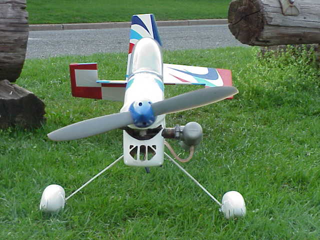

Hello guys , heres a happy U Can Do , can you see the smile ... Well this has a Supertiger .91 on a 15x4w on a 10 year old eng. runs great.

.....thought about doing something like that myself actually ......but i would probabally have knackered te cowl up or such like ...some teeth down the sides ...?..

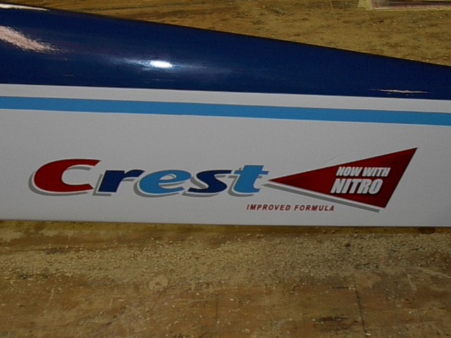

Contempo, you got that right. Its a whole different plane with this engine. Now, in the second season of flying the UCD, it went from 'been there, done that' to wow! I'm liking it. Thanks again for the use of your logo, check it out. The color match is perfect. Joe

Joe
NICE LOGO
Did by yourself or buy somewhere?
