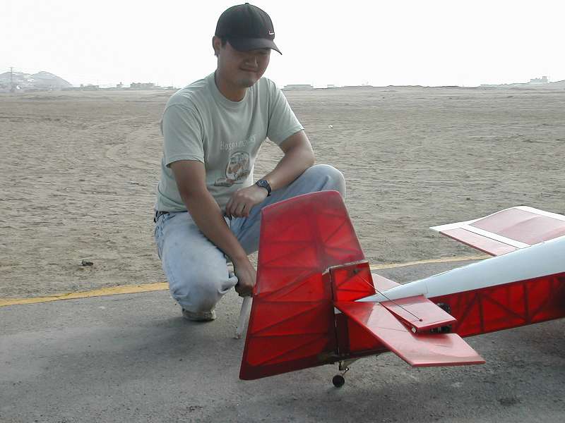

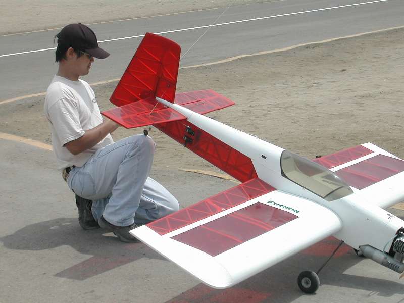

ORIGINAL: southern_touch9
ERRR...I hate to say this but if you really got to have "just the right conditions" to get that low then you might not really want to try it. Touching the tail on the ground is safe if you have complete control over the plane but if you need the right conditions to do it (within reason nobody wants a 35mph breeze) then it could get dangerous.
i agree, if a little brezze or 0 wind is goint to make u suffer, or make a diference, dont try to tail touch yet...
just get it as low as posible and try to keep it there, if u have perfect control of the plane at 1 foot of the ground in tr, u might want to try to keep it at 5 inches then, ull see that probably it will automatically drop and touch the tail...
but 1 very important thing... when it touches, u have to apply power inmediadly, or maybe even before it touches, or ur plane might end up like this...
this is a 1/4 scale plane with an os 160fx in it.. not much happened to it, i got it fixed in 2 days, but still...
u can also see how the plane tilts when u tail touch, inmedeadly power added is a must..... this is my funtana 40 after tail touching....

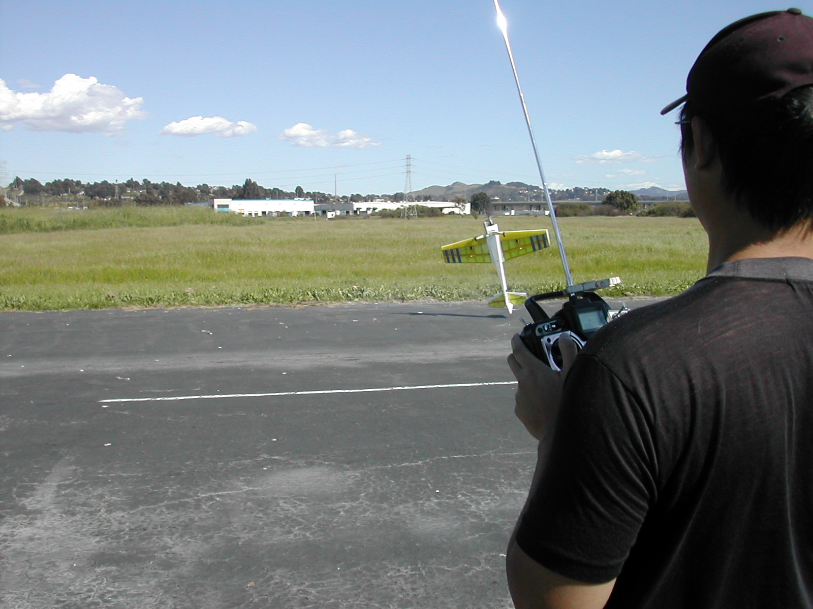

ORIGINAL: FKY1000
Dude, you been at the whisky or sumthin? [sm=spinnyeyes.gif] Thats a laser 3d dude, and if you got a 160 in there, you'd have more than enough power to pull a brick out of trouble.

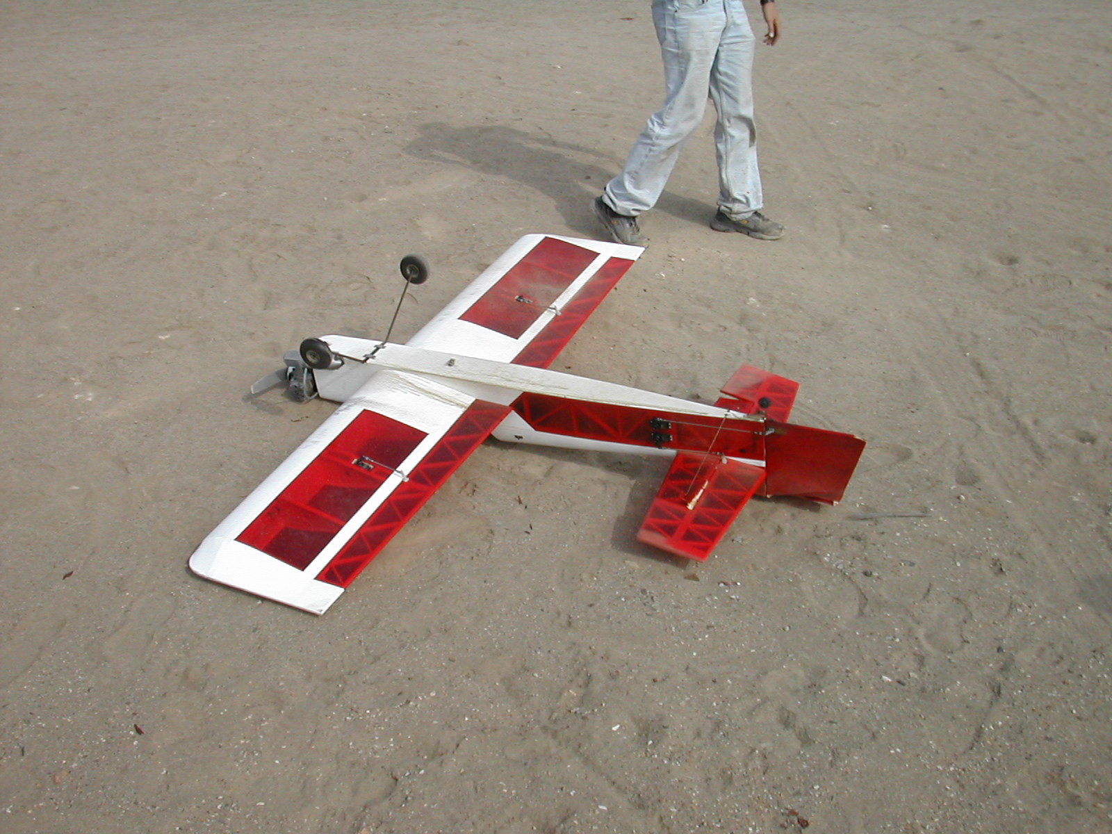

[/quote]
i really dont know what to say about ur coment... this plane i design it myself and i scratch build it, it spans 2m x 2m... it weights 14lb wet and pull out is just enought, my 160fx is spining a 18x6w at 8000rpm, producing about 16lb of trust, thats why the pull out is not so great... ill send more pics...

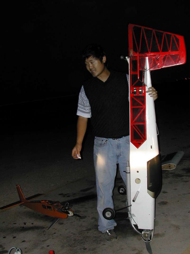

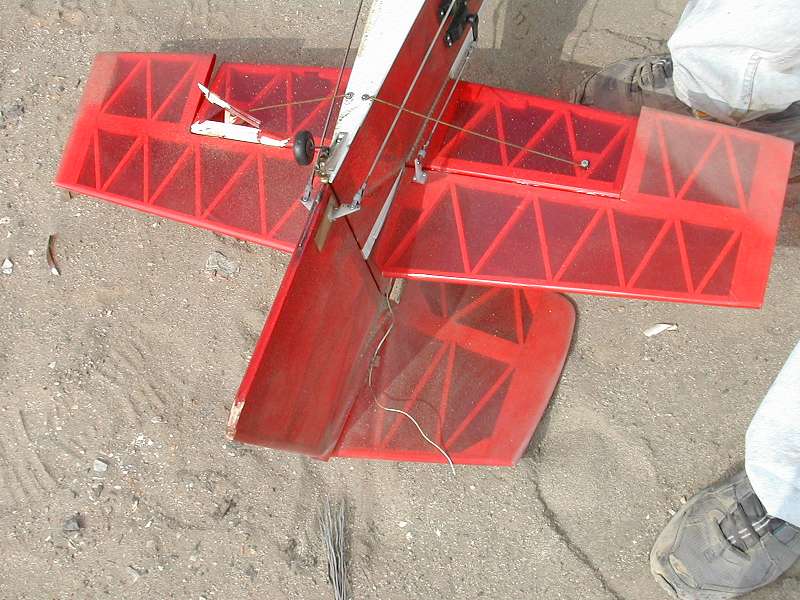

this is another crash i sufer while tr, it was too windy and when i lost balance, i came out with tail wind and the wind push the plane down, it landed on its wheels, so not much happened...
its a 1/4 scale, just compare the size of plane with me!!!

to clarify, my last post:
1st picture is the other crash, and the last 3 pics is the same crash as before for trying to tail touch...
