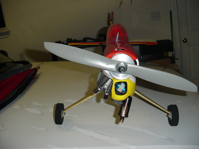

Anyway back on the Showtime. I myself just bought myself the 1.25 for this bird. It was a toss up between the 1.20 AX or the saito and im a sucker for the 4 stroke sound. Im sure it was said before somewhere on this thread but, I want to put the tank at the CG or as close as possible. When i was at the store I almost bought the vp-20 shaker pump to use but, was unsure about location / mounting. A guy at the field said to mount it to the top (since the motor will be inverted) 2 backplate screws. So it could get the maxium shake effect. Very unsure about that.

i run vp 30 on my 4 strokes it works great
since it actual for 2 strokes u must have crankcase pressure...

Thanks for the pics. And the quick response!! May just go ahead and us the VP-30 but, would have to special order it since it isn't currently in stock at the store.

In the picture of the vp30 pump being in a up & down position. If you read the manual that air bleed hole should be on top with the pump being mounted sideways. Or am I wrong.

u r correct sometimes i break the rules
i feel i must stay in a certain postion for this to be true
ie no inverted flying, knife edge and such[8D]

That hole should be pointed DOWN, regardless of the pump orientation.
