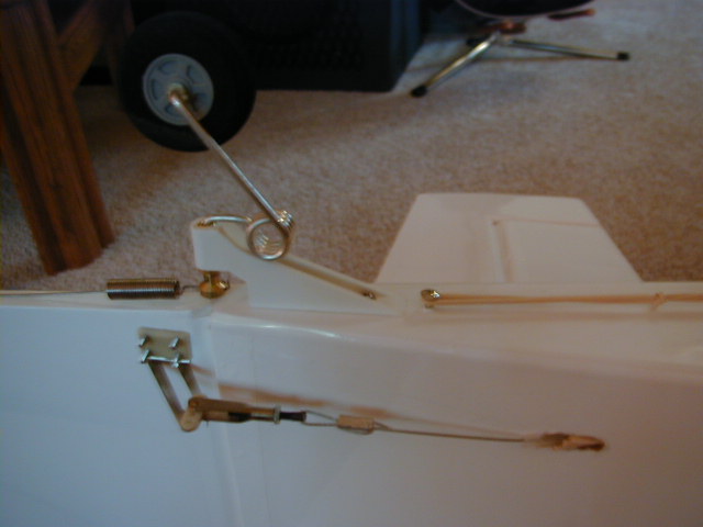

Here's a couple pics of my pull-pull setup...
I used a carbon rod to determine the straightest shot... The cable on the right side exited just infront of the servo bay, on the rear side of the close fuse side opening and about 1/8" lower than the top of the servo bay...
Here's a pic of that:
