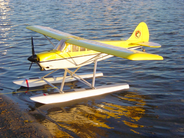

Well the cap is in the barn for some clear pretty blue sky days of crisp winter mornings. For now it's fall float flying season. I've had the Husky hanging forever waiting on floats. Now it's time.

ORIGINAL: CowboyLifesaver
Nice [sm=thumbs_up.gif]
