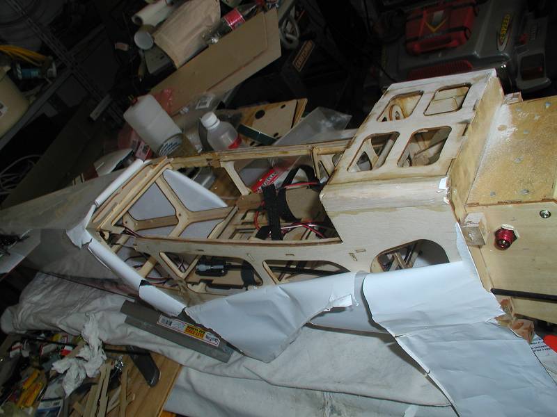

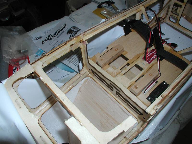

Hey elvir, why did the landing gear and cowl chip like that?

On the first flight I had. Got everything tougher and did a radio check at the clear field and also with the engine running it was all ok. I was using my jr 10sxII heli radio so I thought i was ok as i used that radio with my other smaller nitro planes. So i was excited and nervous at my first gas sorry first big gas plane. went to take off and 15 seconds into the flight i was getting hard glitches i thought at first it was to high rates on the plane somehow i got it back 200 feet from me and lost it and went down and broke in to parts. it took me a month to rebuild it and the second flight had glitches again , but got it down and broke the landing support behind the firewall . Now i have 3 3mm laminated ply as a support for the landing gear and boy dose it hold , but heavy. So a friend was going to the states for two weeks and got him to bring back a jr 9303 plane radio and now it is perfect no more glitches. i think it was to the fact that i was using a hitec receiver with a jr radio and that the cap has very long servo leads . so that was the story of the damage due to radio problems.

I have been using hitec FM equipment but am hopefully going to be switching to spectrum DX-7 this month. Haven't actually had to many problems with FM, i am hit with a few glitches here and there but i am staying high as i wait for my engine to continue to break in anyway.

you may be having the same problems i have had . so be carefull.

You aren't the only one who has had problems with a JR 10 channel anything. My buddy Cublover lost a plane he had for 15 years to a problem with the 10 that sounded exactly like the problems you were having. It was a 34 year old hand me down plane. I fly a few JR receivers with my Hitec Eclipse 7 radio all the time. I have the Hitec QPCM in my cap though. Can't wait for a day that the wind is not blowing to get that thing up again. I've opted for float flying the last few nice days. Can't help myself. OH....Al.....that thing smoke like there's no tomorrow. I even have some new smoke fluid for it. I'll have to see how that works.

I still got glitching. Since the new radio no more problems.
