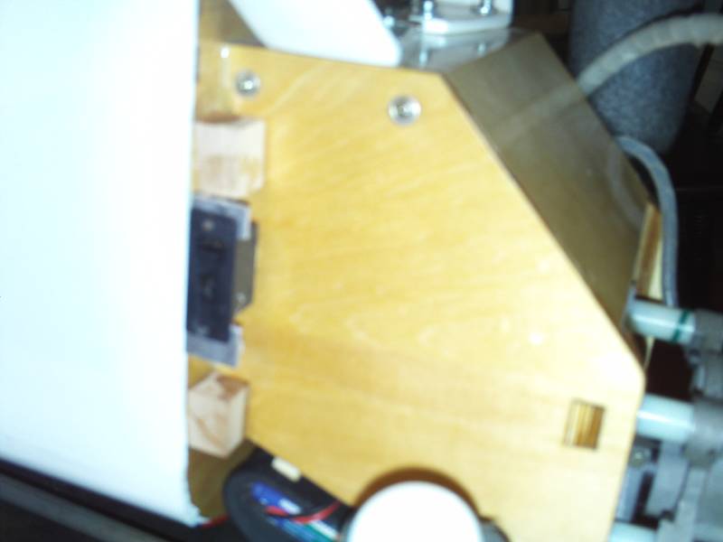

Hey Guys ,
I've read thru all the posts and I'm almost finished with my Cap. Great thread.
I have a zdz40 installed, all hitec digitals, spektrum 9ch, a123 bat.
Trying to keep this one on the light side so no smoke. I'm about to install the mpi on/off switch. Does anyone have pics on what they did and where your switches are located. I mounted the ignition switch on the firewall by the cowl mounts with a piece of angle alum.
Post pics if you can,
Regards,
Dan

I added a piece of balsa in the open area aft of the former that the wing dowels go into.
Edit, Might want to consider buying the landing gear for the gp 330. It's a little stiffer and still matches.

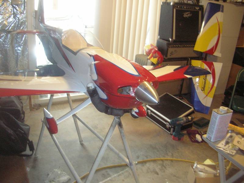

Finally got to fly my caps last weekend. Havent had the front cowl on yet,still breaking in the motor, went with the rcgf 45cc gas motor..
This is my third plane, first gasser....just moved up from a GP RV4...I have seven flights on her now, flys great,getting use to it being supper responsive compaired to what i just graduated from....I am having a helluva time landing it. Are runway is 300 ft long with a fence at both ends of it to clear. This plane does not want to land! I am wondering if flapperons would work on this plane to slow it down on the landing approach?

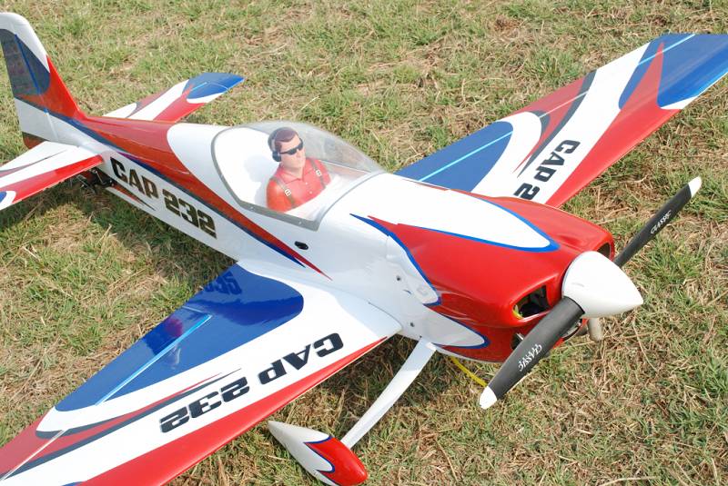

Hey Guys here is mine with BME 50cc engine, It flies like a dream. Having done 50+ flights on this one, Only issue that I have felt (& experienced on this one) is that you need to put her down very smoothly during landing Or it tends to pull the whole engine mount box out.

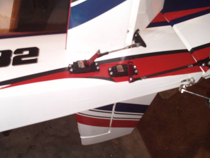

My Cap is 99% done. It's allways the last 1% I have trouble finishing. All that's left is to cut the cowl and mount it. I get sidetracked and get another project started before I finish the last.
Here are some pics of my progress.
