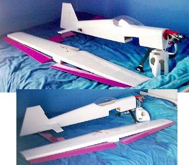

No current pics, its dark, but......
it's all covered, no trim tho...
the cowl is cut, the engine and tank installed. all servos in place, setting up the throttle now.
just surfaces to attach with and horns to fix.
think Archies sent some, so if i get them tomorrow, they're going in, if not.. i'll sort something else.
Maybe i can buy a pack if malc brings some with him? can hinge on the field if necessary.
next big job is join the elevator, a carbon rod, with two holes and then two metal rods into the elevator halfs. the best slop free i could come up with the scrap i have here.
i see no reason for it not to fly at the weekend.
might even have time to sort the Maggers out too.

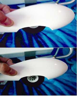

still wondering how to attach spats, cant use the main bolt, the spat doesnt come down that far
slightly fuzzy pic of the pre trim capiche
tho after what Jackie said about costs and washouts. ummm
Capiche is going back on the bed ( set up table
) to have all servos connected and sorted. didn't really wanna do the elevator on the field, it's kinda tricky.come on mr postman, bring me sommit

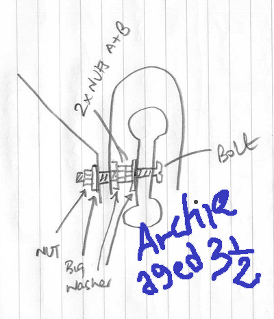

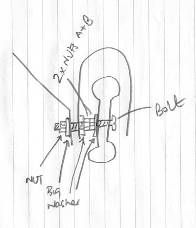

here is a very bad drawing for someone else that asked the same quiestion...
basically cut a slot for the bolt that holds the wheel and slide the spat down onto it and tighten up... that way if you do have a bad arrival the spat should twist or come off rather than rip itself to pieces.
works for me...
and easier to fit.
works for me...
and easier to fit.

LOL ! yeah probably.
Actualy Im not that bad but this wa done in a hurry for another of the Capiche Team that had not used Spats before...
Ive just been looking for the notes that went with it to explain away the terrible drawing but alas I cant find them...
obviously you need to pull up thenuts to close the gap between spat and leg...
Actually thinking back... I might have been pst one night when I drew that...
I really think is quite stylish ! Could be worth a lot of money one day !! LOL

see, now i was thinking thats how its done, but looking at mine, if i do that i've got hardly any wheel, that cant be right
isn't it meant to be like the bottom one?

as long as the wheel touches the ground I think it looks nicer to cover as much as poss...
depends on your field I spose.
If you need to use bigger wheels then relieve the hole in the spats some more.
its all about choices..
