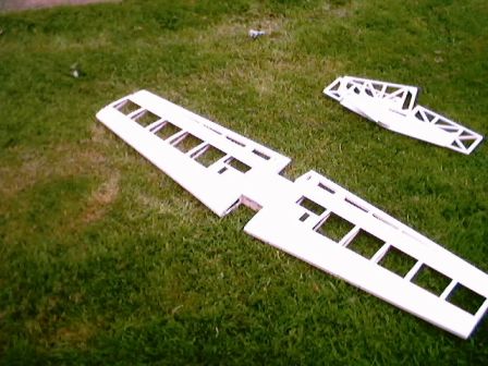

ahhhhhhhhh, progress at last, here is my cap 50 wing bottom , top is not sheeted yet but will be after work tomorrow.
then its onto the fuz
i am amazed how quickly and easily this thing is going together,
the only thing that stopped me tonight was running out of cyano-damn and blast

isnt there something missing from that shot ?
gimmeee five and Ill figure it out...
Old 08-05-2003 | 07:22 PM
  #797
cabanestrut2002's Avatar
Posts: 1,094
From: camborne, UNITED KINGDOM
Default Capiche 50
i still got to cut the fuz sides!
thats why i built the wing first

do you mean the balsa on the inside of the fuz slot and the belly?
wingtips too...
i didnt want to add these until the fuz is built, to get it nice and snug

you can add them now if you want coz you have to sand them down anyway. i made another booboo there, i used scrap balsa, then when i came to build the bell pan my balsa bits where a bit high, ummmmm DOH!
