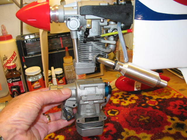

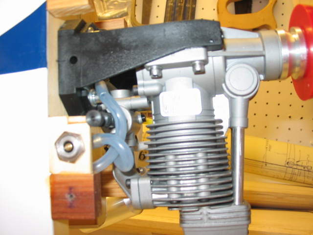

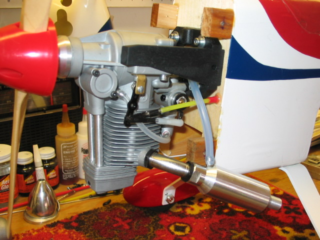

My new Magnum XL 70 arrived last week and I installed it over the weekend. It replaces a Super Tigre G.61 2-stroke that didn't seem to be very happy in the UCD.46. Maybe it was the inverted position that caused it to quit half-way through most flights. Very annoying, to say the least. Anyway, I put 3 flights on my new Magnum this morning and all I can say is, FANTASTIC!!! It runs perfectly, even to the point that not only is the engine still idling after landing, I can taxi the airplane back to me and it will come to a complete stop while idling! I don't think it gets much better than this.
While installing the new Magnum (it fit perfectly into the G.61 bolt-holes) I gave quite a bit of thought to the less-than-ideal fuel tank location. As most of you are aware and have commented on, the tank it too high in relation to the inverted engine carburetor. Well, I decided to leave the fuel tank in the stock position and give it a try, and planned to move the tank lower if I couldn't get a consistant needle settings, etc. Well, it appears moving the tank won't be necessary. The Magnum runs so good, it's just incredible.
Interestingly, the Magnum with muffler weighs about 7 ounces less than the G.61 with muffler. I did a CG check and it was about 1/8" ahead of the rear limit (6" aft of the leading edge of the wing). I didn't feel real comfortable with that, so I moved my battery pack forward to the empty bay just behind the fuel tank. This didn't make a huge change in CG, but surely gave me peace of mind. Today's flights revealed that vertical hovering (something new to me) are quite easy to do, even without switching the dual-rates to high. Also, the Mag 70 held the hover easily at not much more than half throttle. After what I've read on this forum, that surprised me. I thought it would take about 3/4 throttle or more. I'm running the new engine real rich, also.
Anyway, all I can say is YEEEEEEEEEEEEEHA!!!
-Kaos
-Kaos

Kaos, WoW!! Nice looking set up. I'm glad everythings working out for you and the Do. They are sooooo much fun when they're working right. I good set up makes all the difference in the world....[8D]

Kaos...Sounds like you've found the winning combonation. These are ripping good airplanes. One note though: I don't think most people have had to change the fuel tank on the 46. It seems to work fine where it's at. The 60 size is the one with that problem. Just mention that so newcomers won't stray away thinking the need to do a bunch of modifications. From the sounds of your posts, the Magnum may be the way to go.

BTW, how'd you guys like my throttle linkage? The throttle pushrod for the old Super Tigre G.61 didn't line up at all with my new Magnum XL 70, so out of laziness (I didn't want to move the pushrod) I made an idler arm and bracket to transfer the push-pull movement back to the Magnum's carb. It only took about 15 or 20 minutes of my time and works great. Meanwhile, I can't wait to get back to the flying field and bore some holes with my UCD.46. FINALLY, I'm having fun with this airplane!
-Kaos
